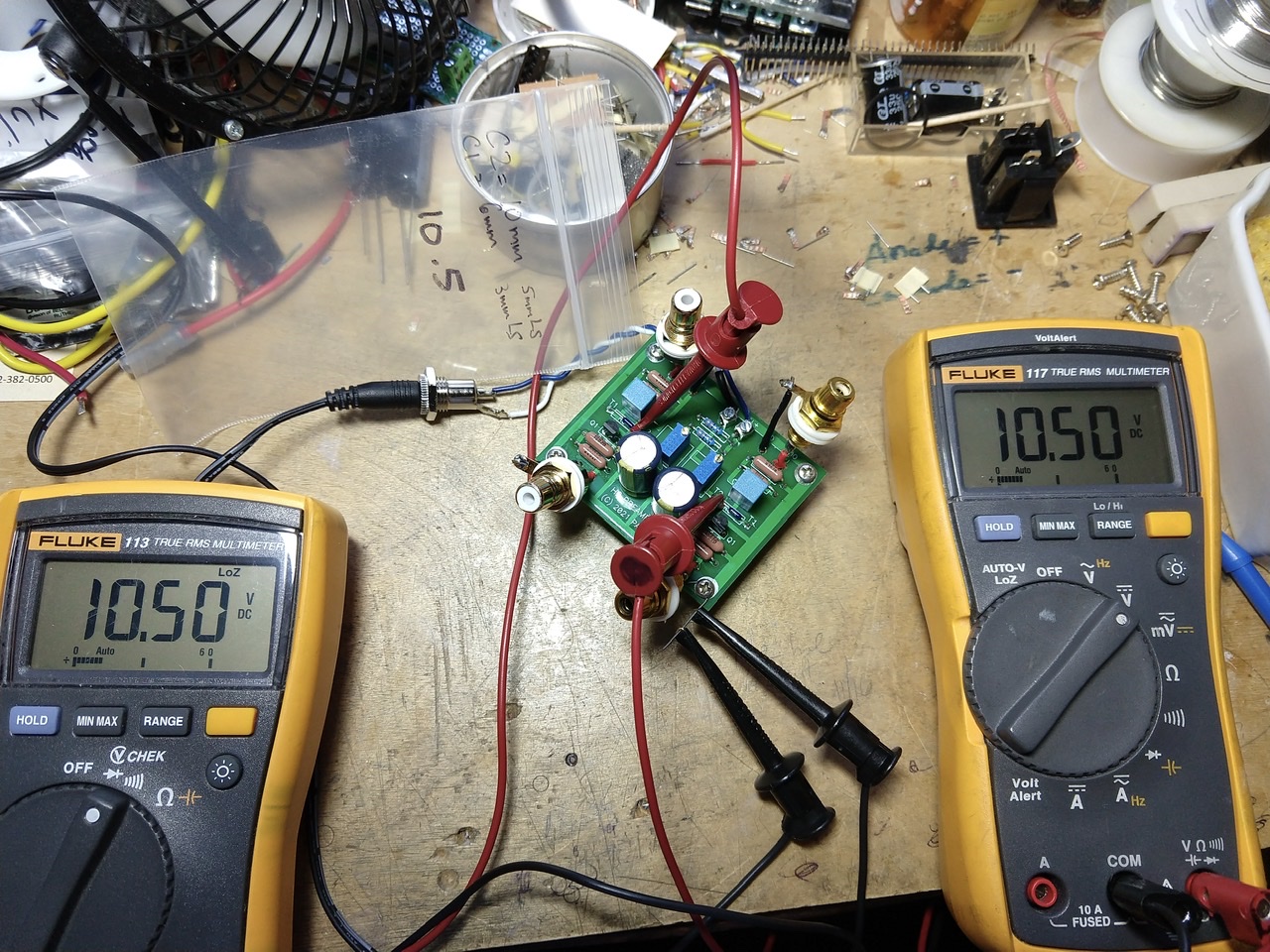

Until my Hammond case gets here I’ll test it as is. R1&2 set for Unity gain. EPCOS 4.7uF film caps instead of electrolytics. Panasonic FCs…..Dales are a bit big…
Initially testing it added onto the outputs of my B1. Can it match the loveliness of my B1K?….we’ll see…
Happy building everyone.
Cheers, Pete

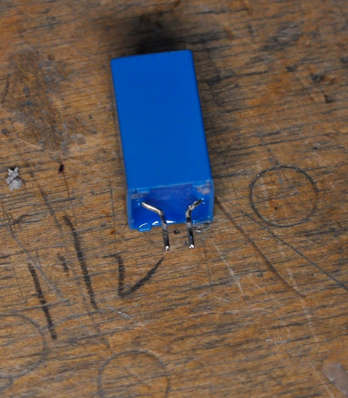

What is the Epcos series? Never saw a so small 4u7 with 5mm LS!
Nice, Pete
EPCOS/TDK Polyethylene Terephthalate (PET) film caps &
some creative bending of the leads
WIMA MKS 4.7uF would have been my other choice, with the same lead bending.
PPs would have (obviously) been outrageously big…
Pete

ThanksEPCOS/TDK Polyethylene Terephthalate (PET) film caps &
Pete
