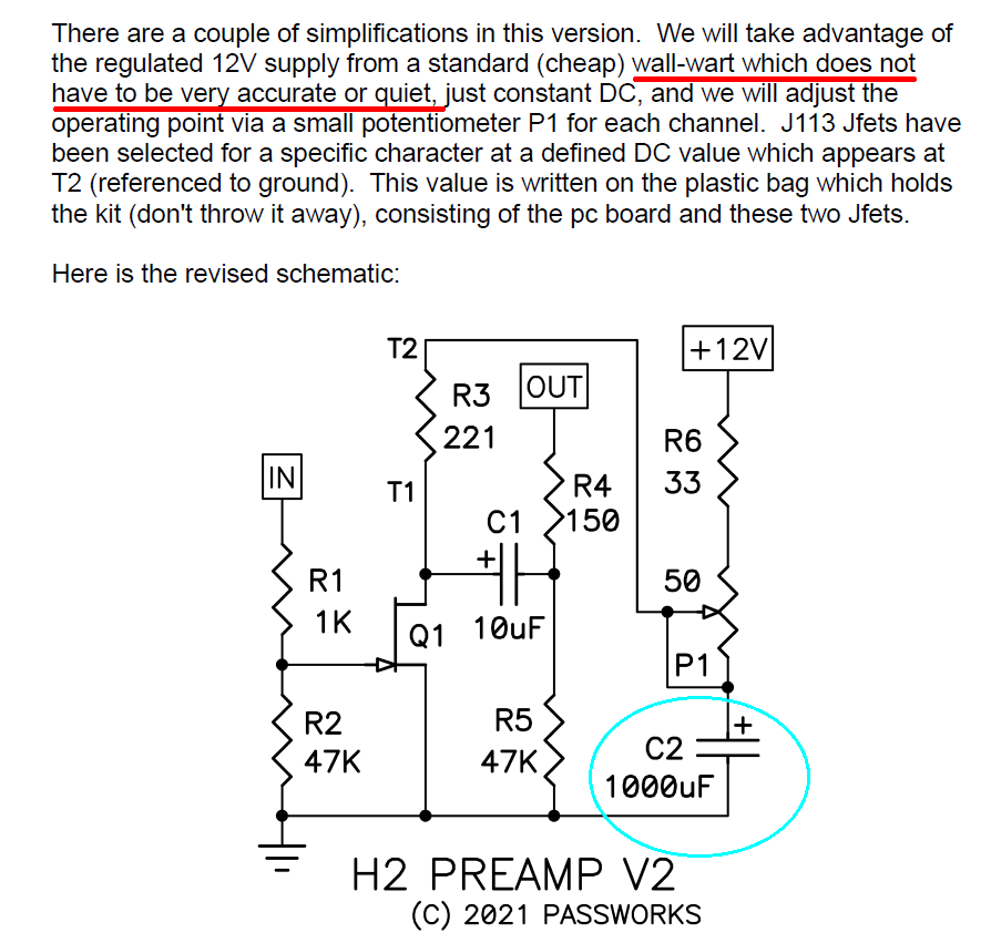

Till someone posts a graph to predict distortion level vs voltage, the best we can do is to set T2 voltage lower in steps of say 0.1V and listening to the effect. Keep on doing this until you don't like what you hear anymore and back off a step or two.
And yes, switching the speaker leads is important, and easily overlooked.

Distortion Measurement

Having listened to the new H2 for a few days with T2 voltage set to the value that NP wrote on the plastic bag - which happens to represent 1% distortion, I set the voltage 0.1V lower last night. The sound is still quite enjoyable, with slightly, but noticeably more distortion. But... I prefer the way it was before the drop in voltage. I'll be setting it back to 1% again be done with experimenting.

Your results are a little surprising since (a) the designer didn't think it would matter; and also (b) there's a great big capacitor on the board, which provides a lot of supply filtering (along with 33 ohms + potentiometer resistance).
