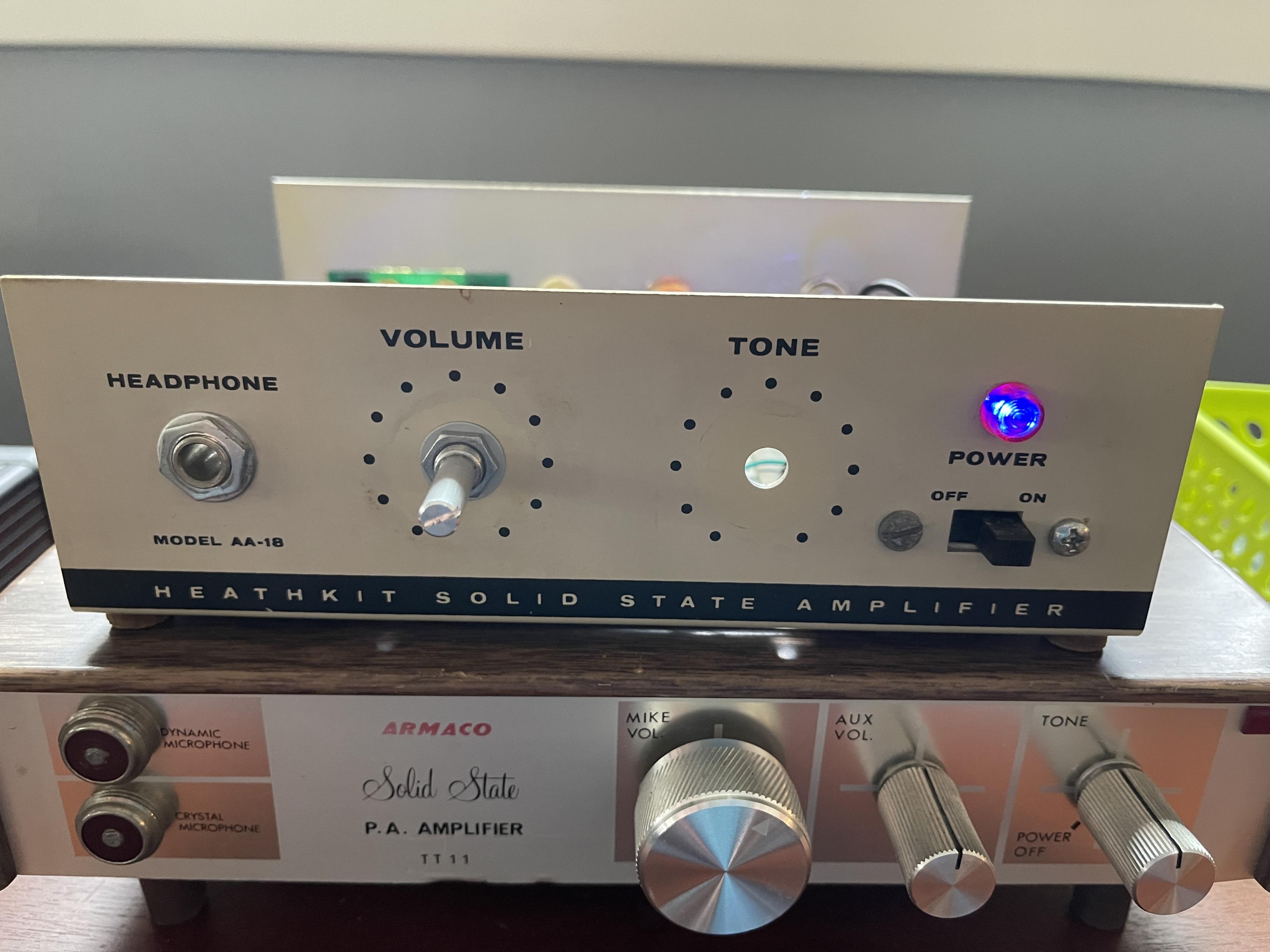

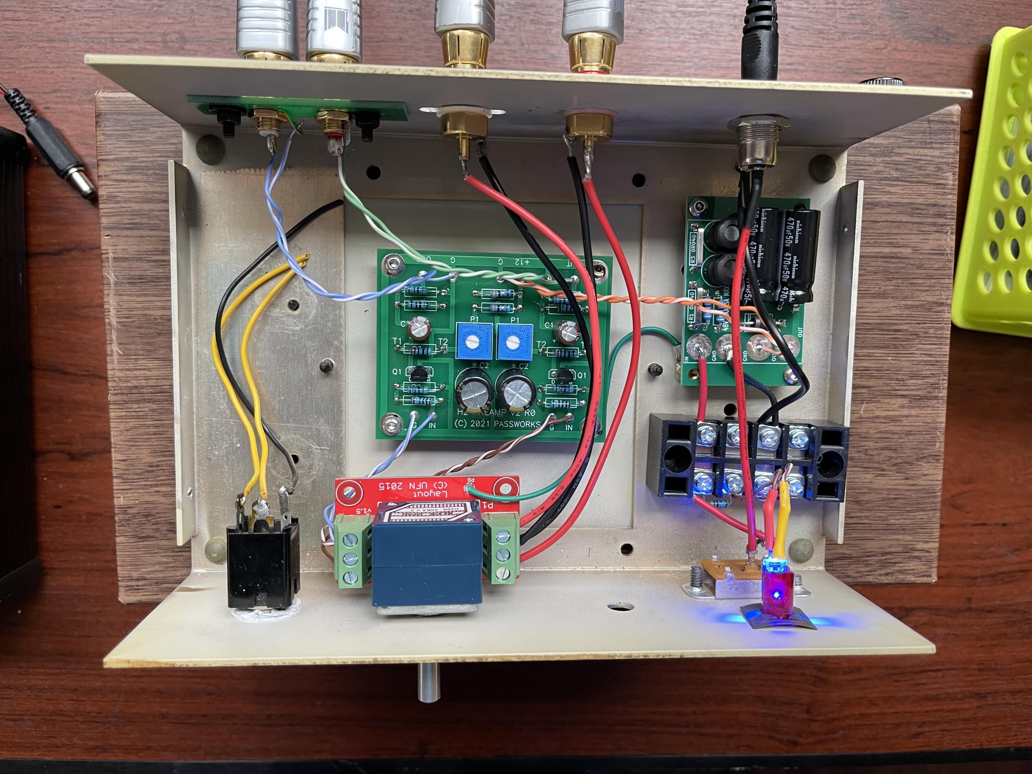

I finished my H2 V2 and put into a small PA amplifier chassis. I added the POZ filter board and kept the on/off switch from the old amp. I added an LED instead of the filament bulb that was there. There's a 50K Alps pot for volume.
I haven't tried it as a headphone amp but the jack is there in the chassis. I'm sure someone will chime in if that's possible.
As always, it sounds great and it's one of the easiest and simplest preamps to build. Thanks, Papa!

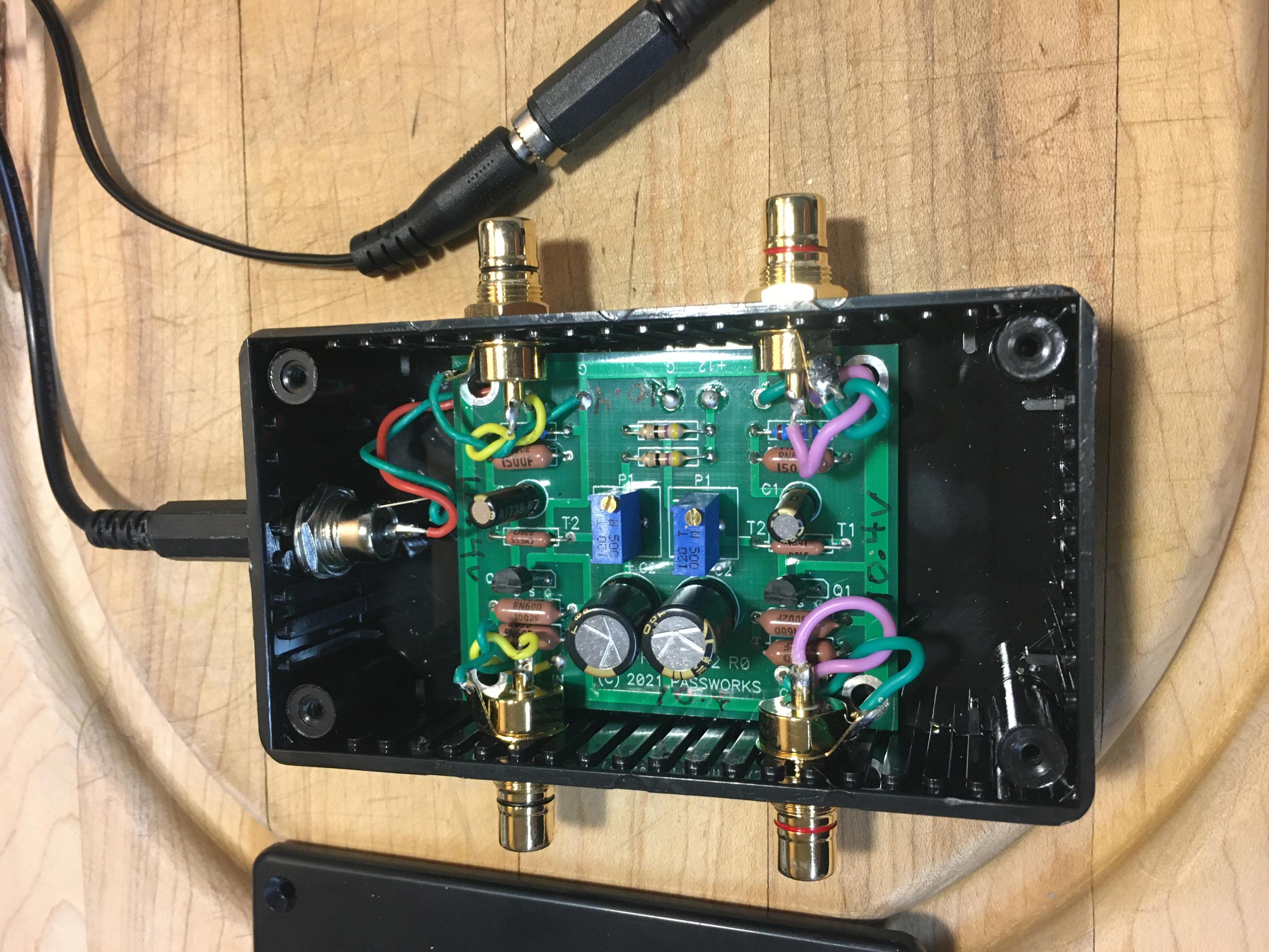

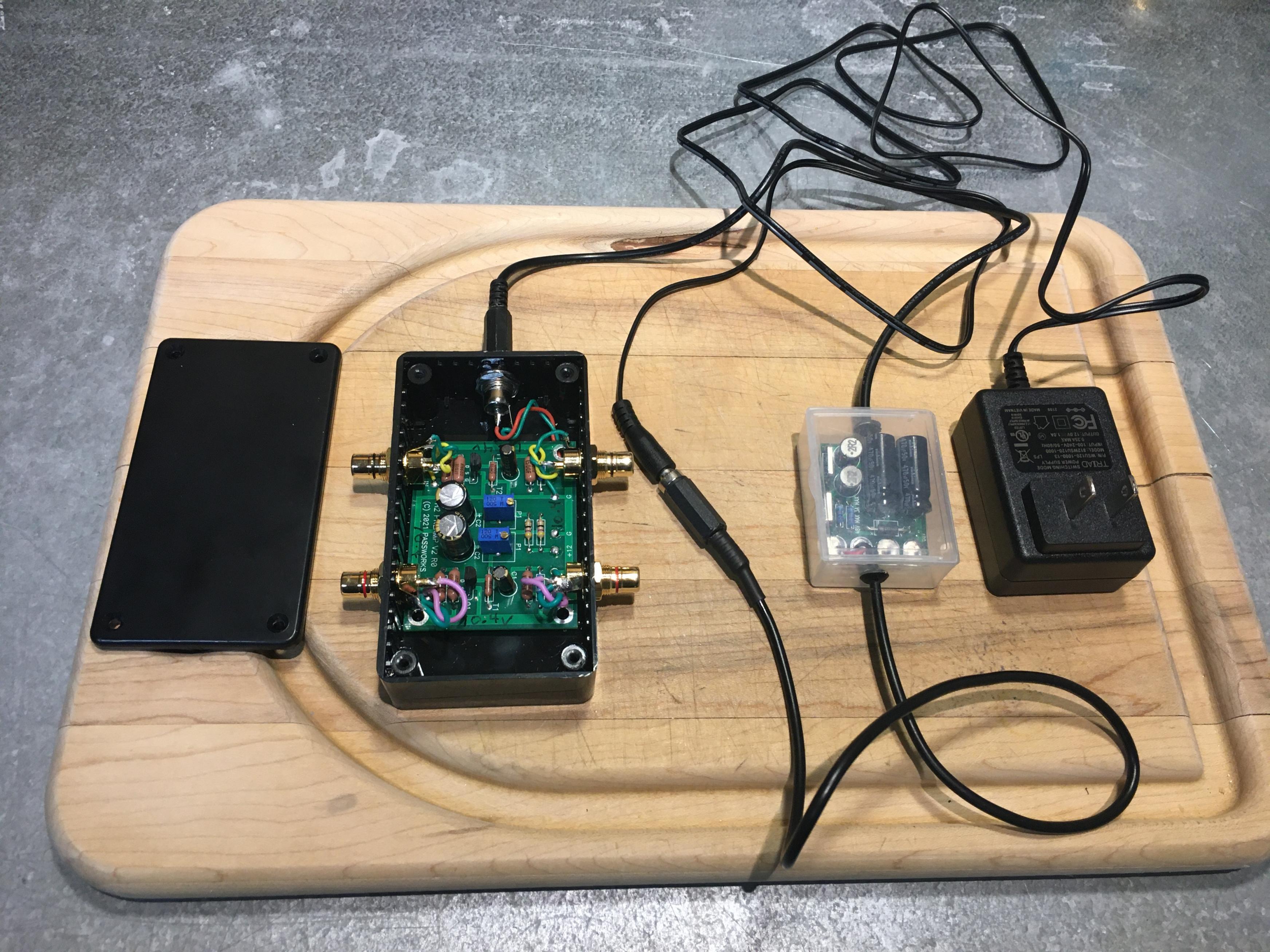

I finished the H2V2 (gift from Nelson! Thank you again), I built it with unity gain as a gift to a very good friend who has an F5 amp and BA 3 preamp he built. Using this he can easily install and uninstall with interconnects.
I used a Triad 12v wall wart with the SMPS filter by Mark Johnson.
Using REW I checked the H2 value at the 10.4 vdc at T2 as written on the bag for the FET's. I measured:
L = 0.60% H2
R = 0.70% H2
With the circuit at unity gain, for 1% H2:
L = 10.08 vdc T2 to ground
R = 10.14 vdc T2 to ground

Very nice, I laid out myself the board and built a test unit using my stash of J113 having IDSS of 24mA perfectly matched. All the remaining part values as published in the article with Nichicon BP series green sleeves as caps for 10uf value. A simple LM317 regulated psu with stable +12vdc.
But using 100R trimmer pots and could not get more than 5.15vdc over the 221R resistor at the T1/2 test points. As Papa suggested need to increase the resistance value or increase the pot. What value trimmers did you use as looking at the pics Bourns W500 does not seem to be a regular value.
