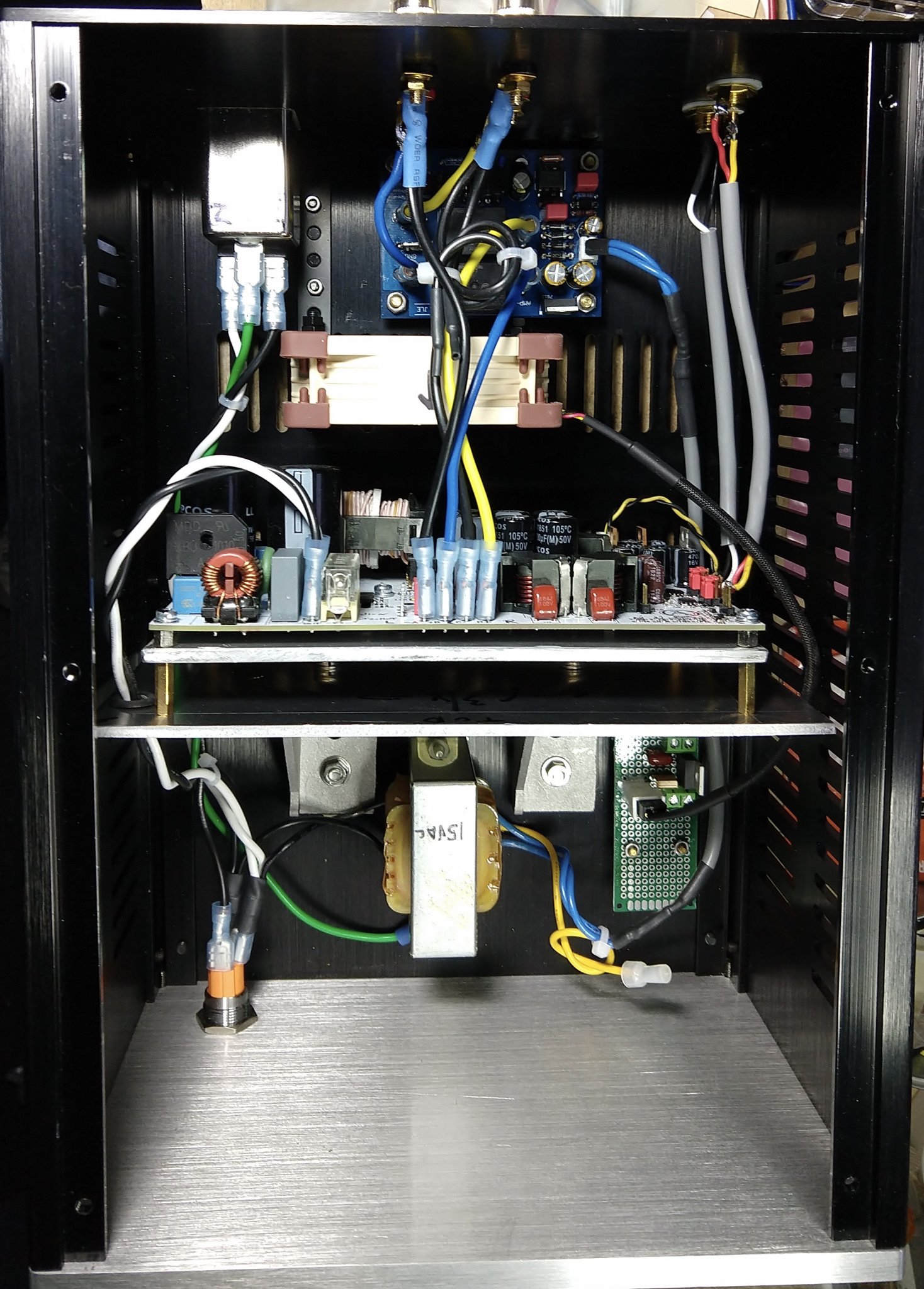

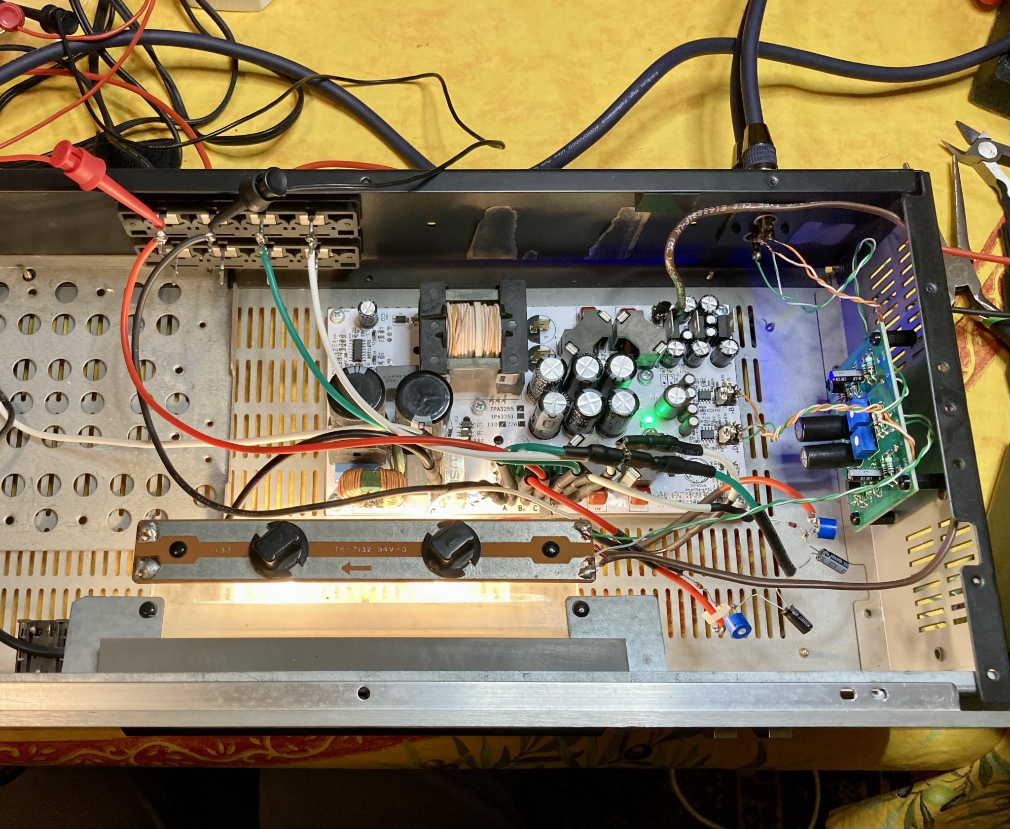

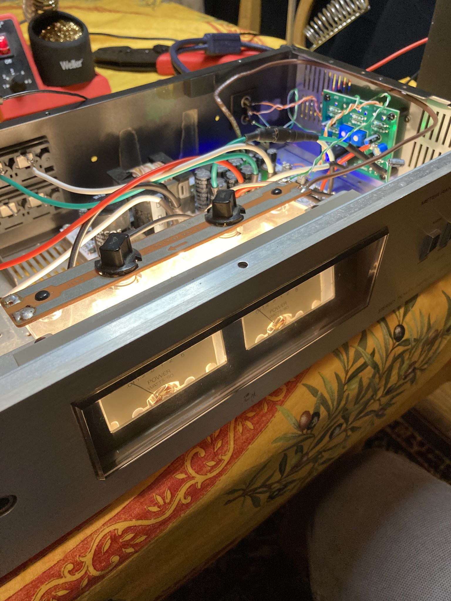

Well, “FAB it and see“ took over and my installation is working fine.
It passed the test speakers audition, and is playing music with my main system.
There’s a slight mains hum very close to the speaker and quite a big turn off thump. I can investigate those further.
Otherwise it sounds pretty good. Very good. Based on memory alone, I believe it has added a bit of that holographic soundstage sense (like the Vfet SE) to my TPA3255-based amp.
Overall a resounding success! What a great little gadget!

von Ah..... I too had him make me one back in the summer of 2020 (before his over extension) and I've had it since Oct of that year. I initially experienced a very slight "thump" (maybe because everything is sent to my subwoofer first and speakers connect to the line out on the subwoofer?) so I actually did put a speaker delay on (only) the "+" out. have had no issues although I don't use the drM amp a lot since getting it. Since I built the H2V2 as well, I'll have to hook it up now and see what I get.
When you shut the power off and get your thump, do you shut off the amp first or some other sequence?

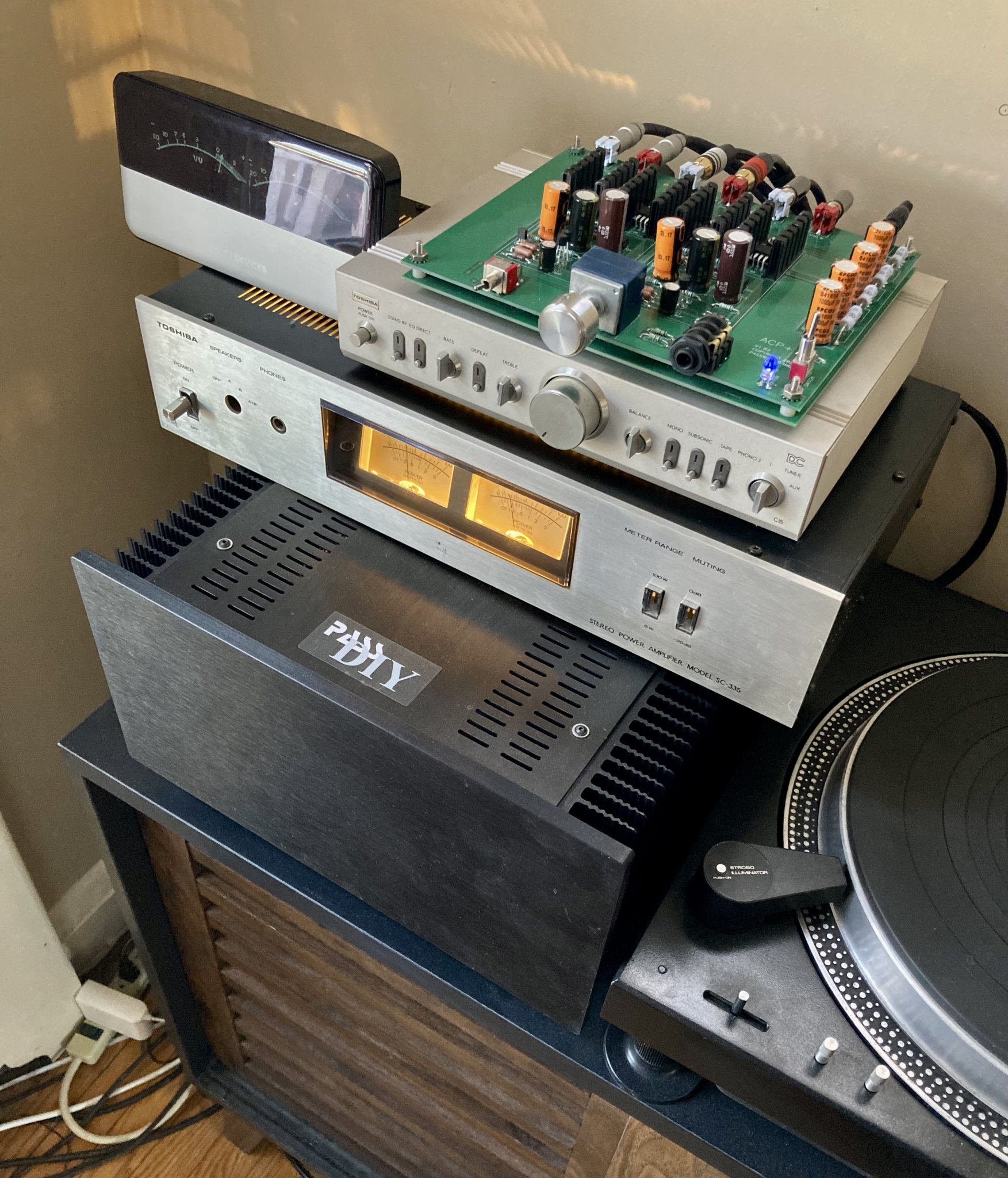

I’ve been listening to the TPA3255 amp with the H2 added throughout this week. It really is something special.
There’s lots of power available and the detail is exquisite. Very enjoyable. I believe the H2 might be the secret sauce for bringing low distortion class D amplifiers closer into the toe-tapping realm of class A enjoyment.
I like the mess I’ve created in my main system. Looks like audio schizophrenia.
