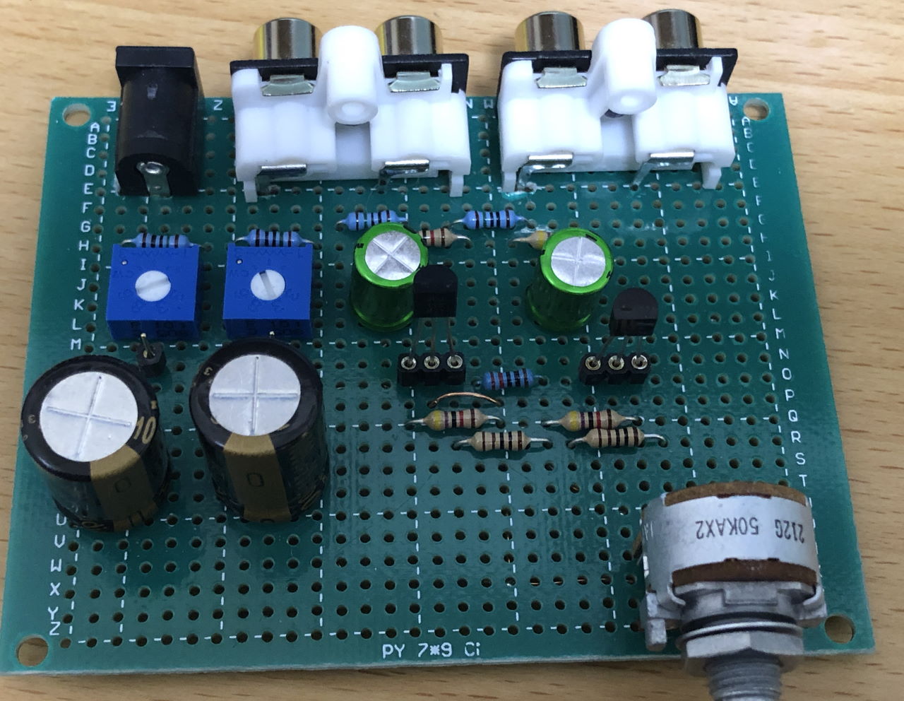

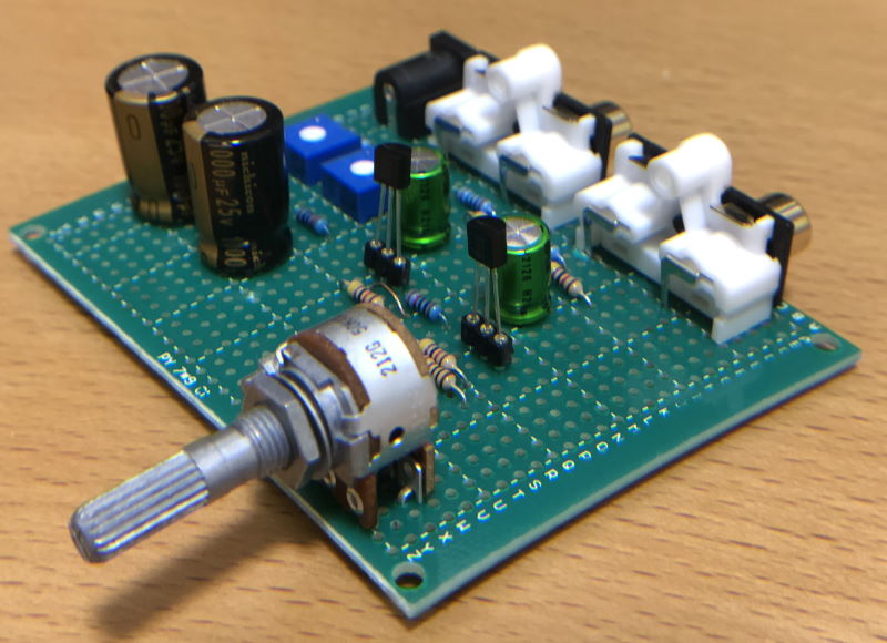

Finally, a H2 R2 has been built on a general purpose board with lower Vp J113. An interesting smallest monster to play. Socket is used to do experiments with different J113s. Thanks PaPa.

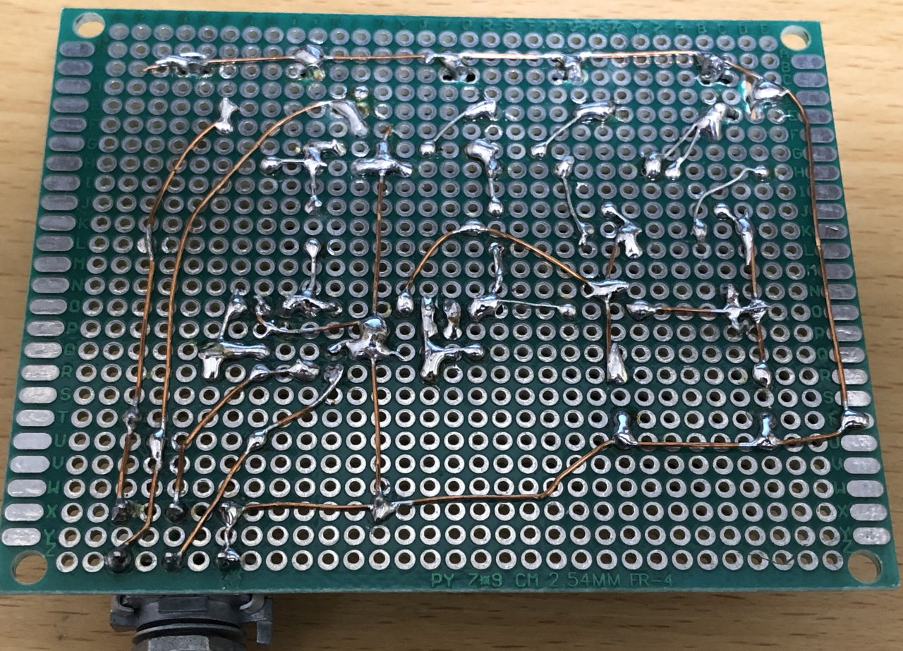

Nice work shamino15. Could you post pics of the bottom of the vero board and another angle pic that highlights the connectors.

Thanks. Here are the pics and sorry for my bad soldering skill. Note: R6 and P1 values are based on J113 Vp as in my post #207.Nice work shamino15. Could you post pics of the bottom of the vero board and another angle pic that highlights the connectors.

Excellent! Almost there!
Did you build it according to the schematic and BOM? If so, it has gain like a line stage preamp, add a volume pot and you have a line stage preamp.
If you want it between amp and preamp, then change to unity gain.

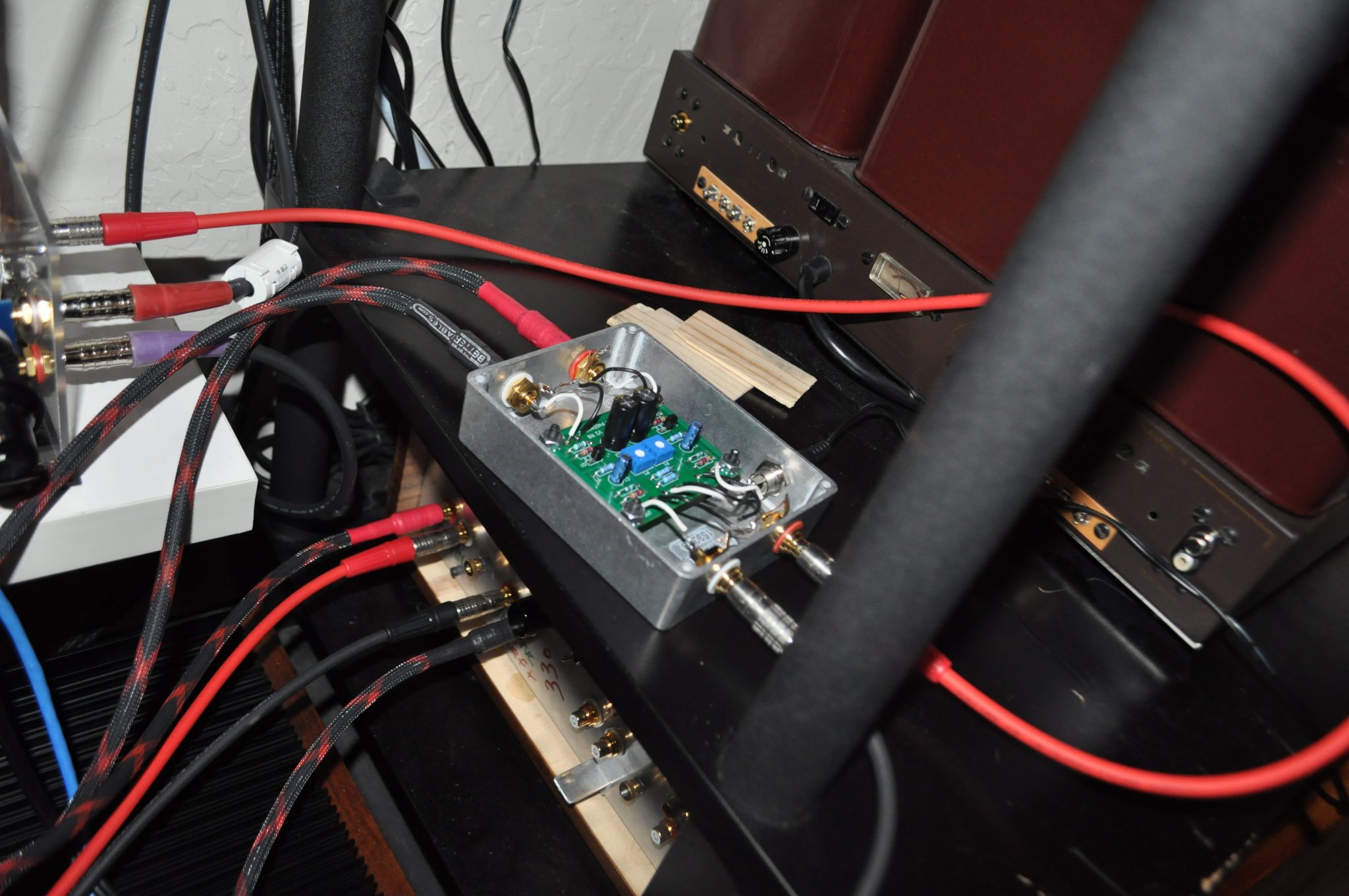

Looks like I can adjust R1-R2 values, or not.My concern is can I-should I use it between my phono stage and TVC?
As is it doesn't work in between my amp-TVC.
