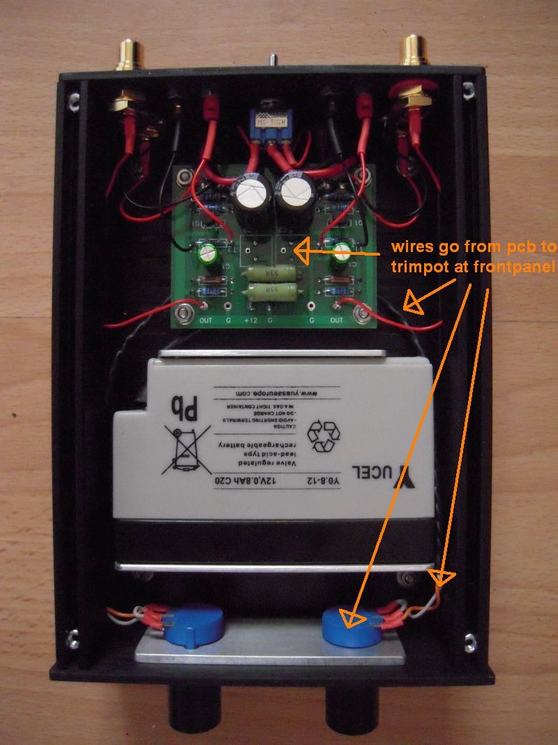

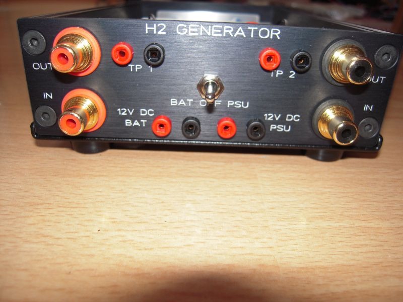

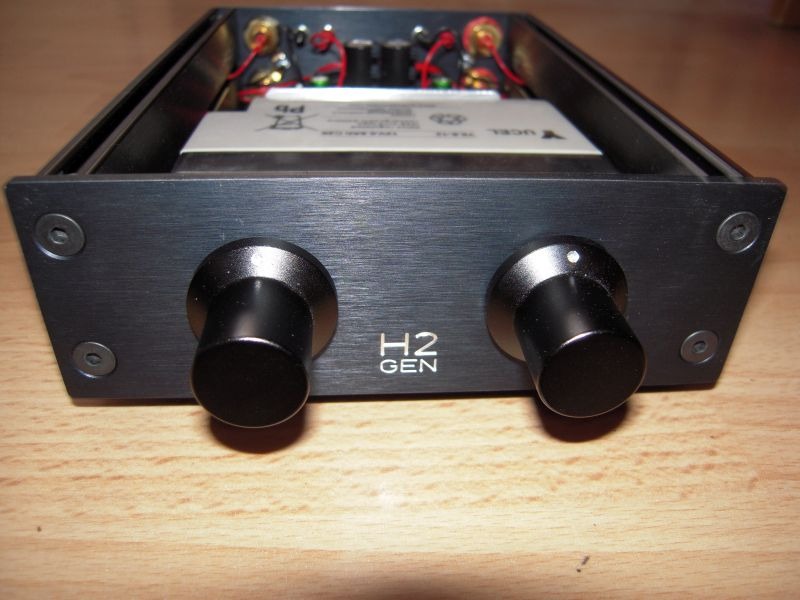

I wanted to thank Nelson Pass for the H2-generator! It is a very nice 'tool' to play around
with 2nd-harmonic-distortion. A single Jfet and its influence to the overall sound of your system.
Although I showed the pics in the 'pictures of your DIY pass amp-thread'...
I put the trimpots on the pcb to the front panel. I didn't get noise. On the backpanel are labsockets (2mm)
which make it easy to measure with the DMM.
I can switch between battery-drive and an external linear regulated PSU.
Cheers
Dirk

Hello Skylar88,I like your implementation, Dirk. Well done!
I also wanted to put pots on the front panel, but couldn't find pots with low enough value - not even close to 50 Ohm. What value did you use? Part number perhaps?
those are 50 Ohm-trimpots with a 270° adjustabilty (let's call it 3/4-turn). I have to check where I have bought them.
Cheers
Dirk

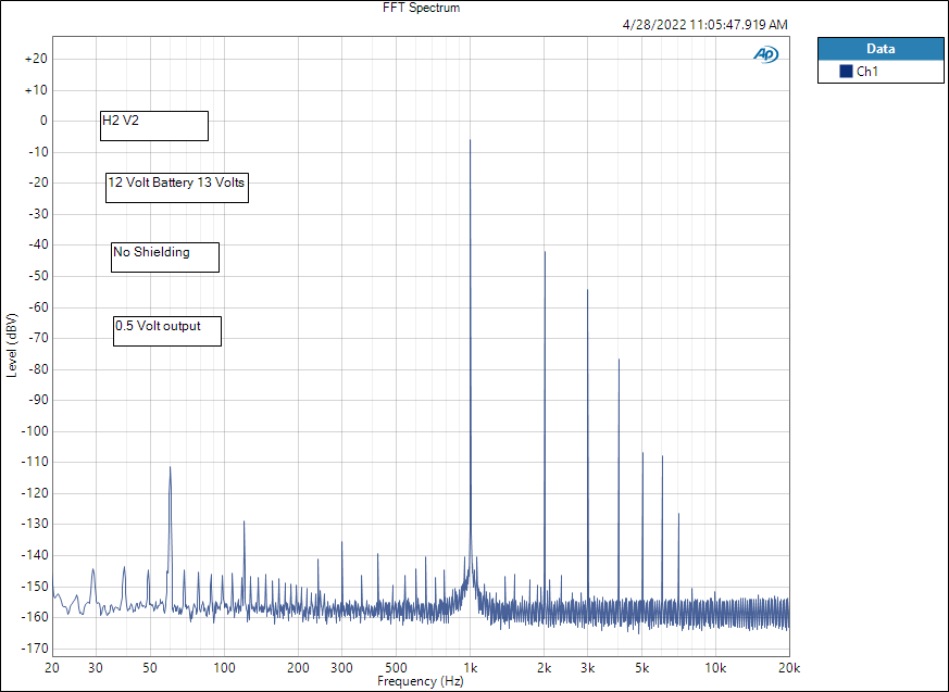

Hello,
I just soldered in the 50R trim pots.
This PCB is clamped in my PanaVice on my bench there is no shielding. Using 1 8ah lead acid battery the FFT is quiet. There is a little spike at 60hZ and some very low level noise, but nothing to hear.
At 0.5 Volts output; Gain = 10.5, Distortion is 1.64%.
It is not just H2 distortion. This thing is a distortion Factory. I will listen to it and see my impression of how it sounds.
Next I will try out the triad switching wall wart.
see the attached FFT plot.
Thanks DT

I am doing this for fun.
Currently I have the H2 V2 set up with a 12 Volt gelll cell. Fully charged the 8 AmpHour battery puts out 13.22 volts. 13.22 volts will not damage anything but it is above the design voltage of 12Volts. The FFT plot is posted above. The 50R Pot is maxed out there is no more adjustment.
I thought that I had a TriAD 12 volt switching wall ward but I do not, UPS is scheduled to deliver it Monday.
The battery supplied H2 V2 is very quiet without an enclosure perhaps a metal box will help only a bit.
Perhaps today I will put another resistor in series with the H2 V2 to place the T2 voltage in the sweet spot to set the correct H2 to H3 ratio. It is really not to ban now, the H2 looks to be about 12dB ish above H3.
Thanks DT

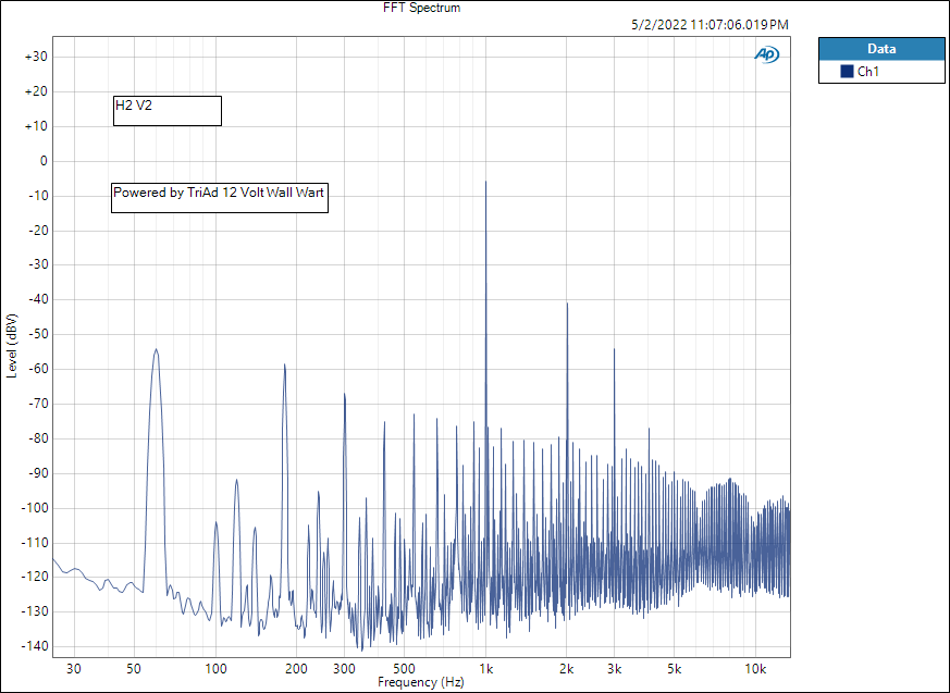

Hello All,
So today I received the TriAd 12 Volt switching Wall Wart.
Overall this H2 V2 PCB is educational.
The battery powered H2 V2 outputs the same H2, H3, ..... series of distortion as the switching 12 Volt Wall Wart version of the H2 V2.
The TriAd 12 Volt Wall Wart puts out another world of ugly power supply switching spikes
See the attached FFT plot of the Wall Wart powered switching power supply.
Thanks DT

Hello DualTriode,
we know about the nasty spikes a smps can send into your amp and into your AC-lines in the room.
It has become common practice to use smps. If you measure your AC-lines in the house and what is
roaming around, then it becomes interesting. Noise on the AC-lines everywhere. Some use their
AC-lines in the house for their LAN.
Although you can filter your smps. Mark Johnson has made a filter available in the diyAudiostore.
https://diyaudiostore.com/products/smps-dc-filter-p089zb-kit?_pos=1&_sid=7573ef8ef&_ss=r
I often prefer an 'old school' linear regulated power supply. More efforts on transformer, filter,regulator
producing heat,... But that is my preference...
