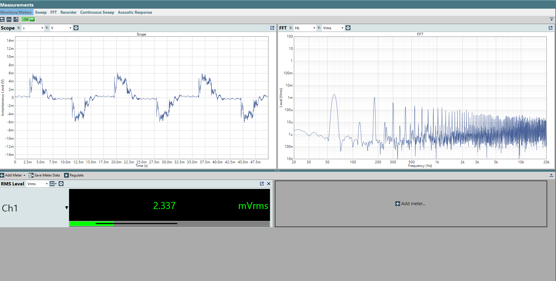

This TriAd switching 12Volt DC wall wart produces a lot of switching noise in the below 22K audio frequency range.
See the attached screen shot of noise voltage, O'Scope and FFT for between 20 and 20K.

Since the H2 V2 board only requires +12V DC, you can start with a +24V wall wart and "spend" those extra 12 volts to get Massive Overkill Ridiculously Excessive Filtering And Regulation. Who knows, it might even improve the sound a little too.
For example, you could first knock down the SMPS high frequency noise with a pair of (the diyAudio Store SMPS filter kits) connected in series. The output of the second board is more than 23V DC because each of those filters have a very low in-to-out resistance, less than 0.2 ohms each. Next comes an 18V DC voltage regulator, either MC7818, or LM317, or LTC regulator, or other options. Finally, last in the chain, is a Jung/Didden Super Regulator set to +12VDC. You'll have vanishingly low noise on your +12V power supply, from 60 Hz to 60 kHz. No spikes in the frequency response.
BTW the Store SMPS filter's rolloff corner happens to be down around 2-3 kHz. Attenuation of noise begins at 2-3 kHz. That's how you get tons of attenuation at 50 kHz: you roll off early and you roll off steeply. At least that's what I was thinking when I designed the board they sell in the Store. Click on the link in the Store's sales blurb, it'll take you to the Forum where I explain the board.

Playing with the H2 V2 is fun. I am some what impressed at the positive and minus phase of the distortion and amount of H3 also present. I may come back around and do some critical listening with the H2 V2, a non-distorting headphone amplifier. I am done with this for a while. Perhaps next I will try a circuit with a J113 current source to see what/if there are any PSRR changes.
At this point messing around with wall warts, filters and regulators is way too much fun.
By putting the battery in the shielded steel junction box with the H2 V2 I did get the 20 to 22k noise down to 3.4 uVrms average.

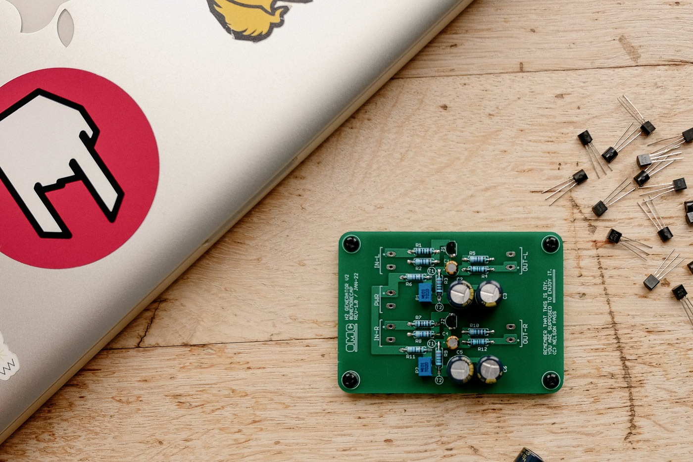

Hello, guys!
What a project! 😊
As always I've went with my own PCB design to have a little more fun. There were about 20-30 of J113 on hands so mannaged to chose a pair in around 2.1 Vp. I my case I've chaned R6 to 50R and P1 to 100R (or you can leave P1 at 50R and increase R6 to 50R-100R) to get desireble level of H2.
I tried to set it up as accurately as possible and it turned out pretty damn good! On last picture you'lle see measurements at 0.5 Vrms output into 47k load after 30-40 minutes runtime. And we have about -40 dB H2, -62 dB H2 and -82 dB H3 and THD+N is 1.06% at both channels. There is unexpected spike between 1k and 2k but it seems I can live with it.
As always, thanks for Mr. Nelson for such fun, simple and handy project! 😍

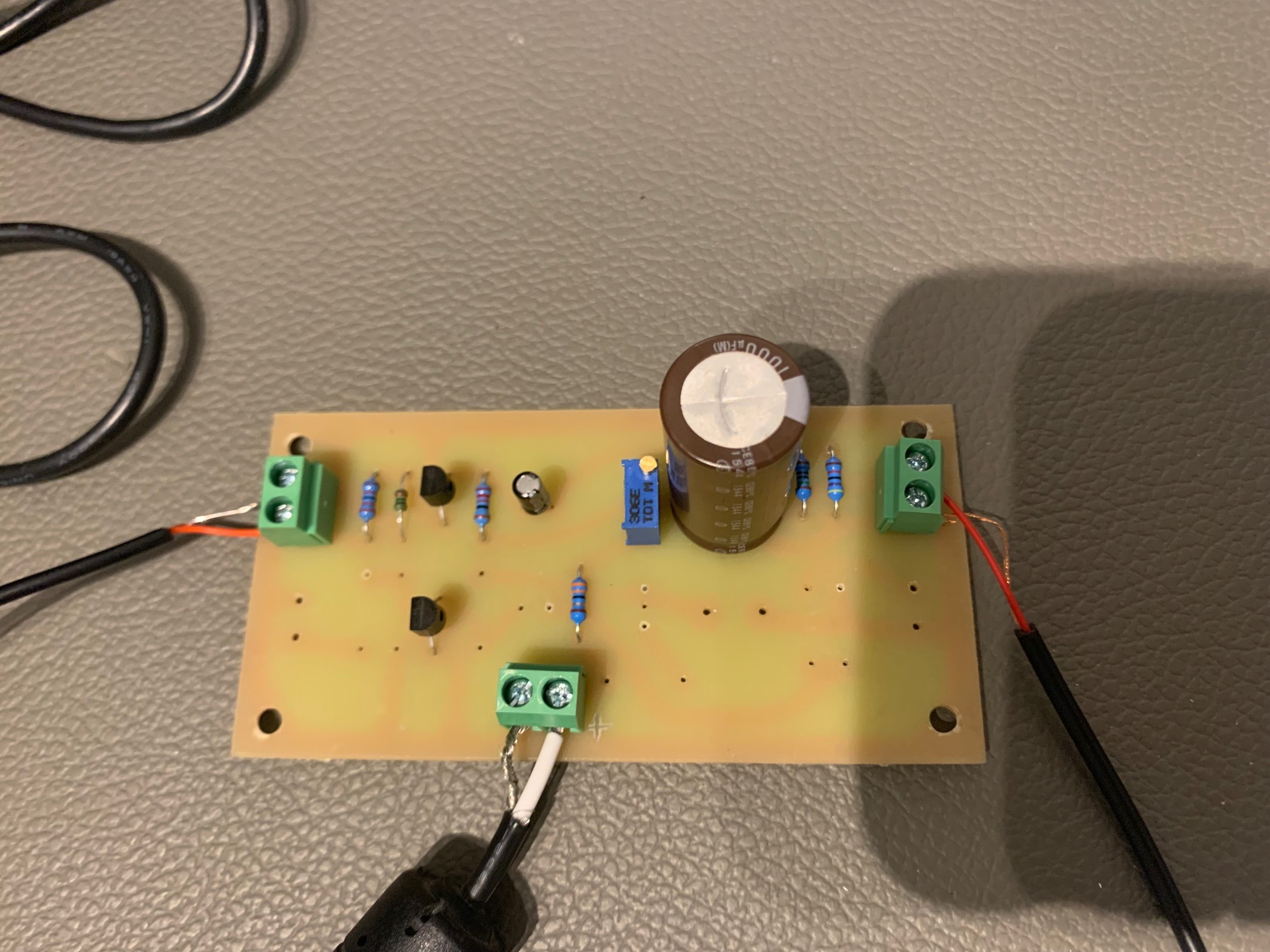

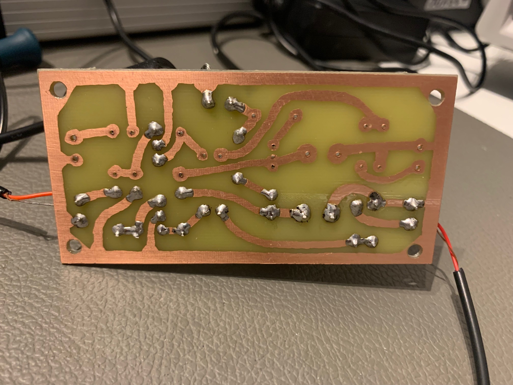

Well i did my own pcb, looking at the layout mr. Pass allready did so well.
I like the typical "Pass" GND connection surrounding the borders of the pcb, just like in the old day's (BoSoZ etc...) great Nelson, thank's...
I only soldered 1/2 of the pcb, to test it for now.
When pcb is done and shielded into some box, i will be using it to compare "real THD" vs. DSP generated THD 😵
Okay nevermind that for now.
The psu is an old LG psu, and the voltage is steady 12vdc, also when loaded.

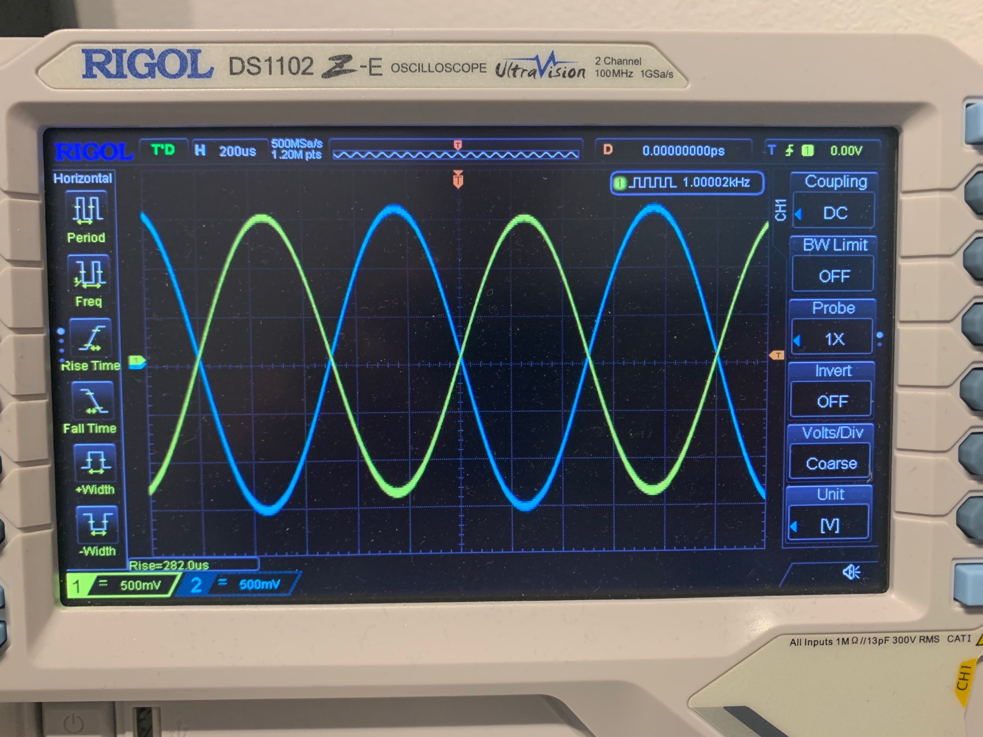

I set the gain to near zero (R1=22K, R2=10K), and the circuit are giving 1.1v out, when feeded with 1.0v from Victors 1KHz oscilator, inverting as it should.
The J113 i have are a set of (which i tested in a little rig.) 2.228vdc/27.6mA & 2.230vdc/27.5 or so.
The P1 is 100ohm, and R6 is stock 33ohm
When setting T2 at 1.026vdc, the 2.harmonic is ~1%, and everything is looking good i guess.
Considering the pcb is in the open on my noisy desk, i think the FFT are looking pretty good.
Jesper.

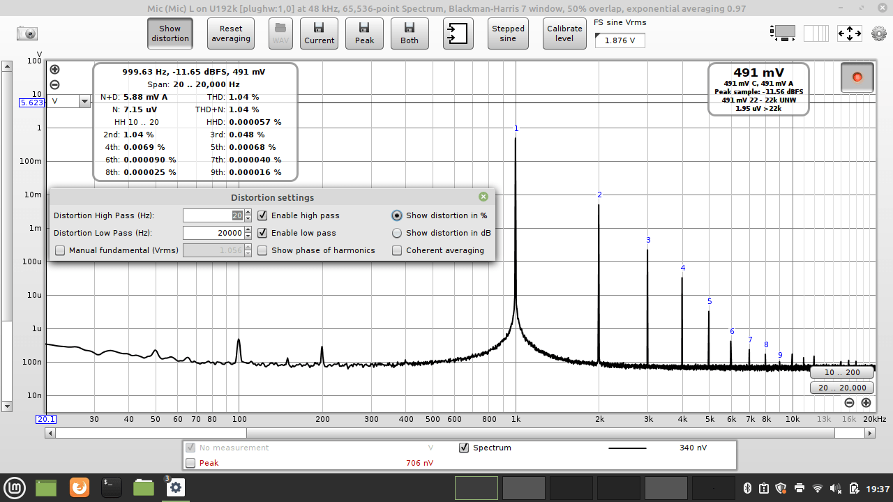

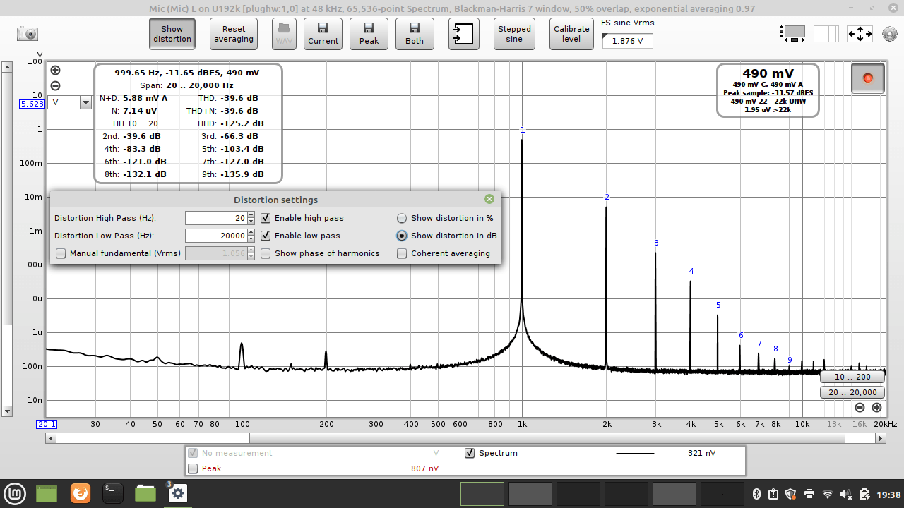

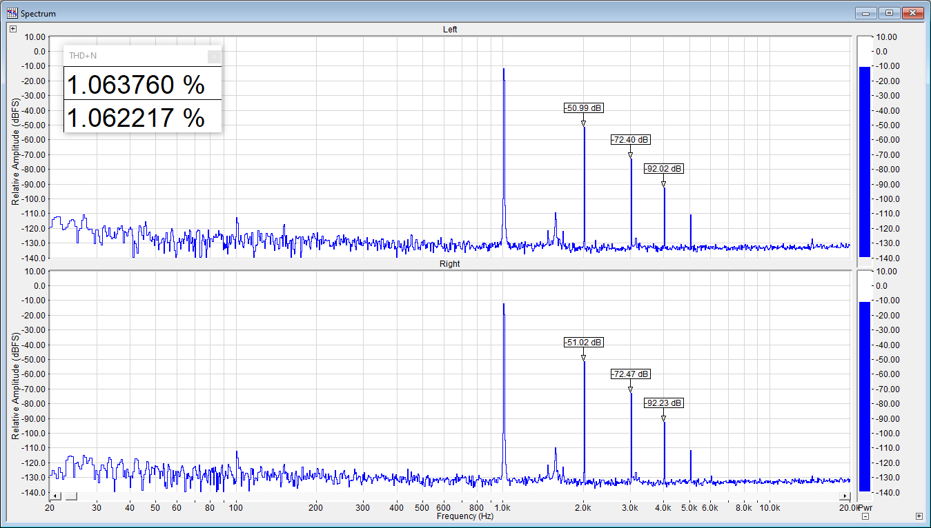

I finally got the H2 generator boxed up, and did some screenshots, to compare how important shielding is 😊
See post #308 for how it look's without shielding.
I took the FFT with showing mV as the paper's tell that the H2 number's are at 0.5v out.
The H2 is as Nelson describe raising with raised input/output voltage.
I will as i proberly allready wrote, use this generator to compare between DSP generated H2, my Tube 300B-SE and this H2-Gen.
I'am really slow right now, as summer is comming here in DK, but promise to come back with some result's sooner or later here.
Jesper.

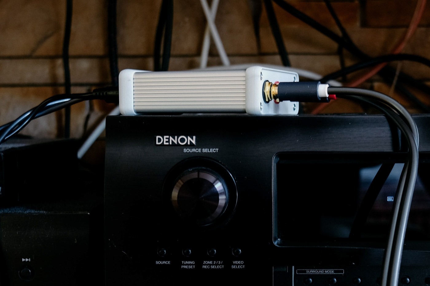

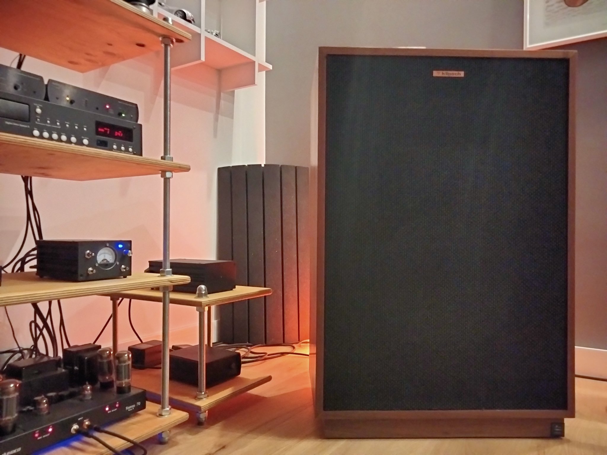

I have a H2 V2 in its own case hooked up in the processor loop (located before the preamp) of a Luxman R-113 receiver. I can switch it in and out at will (bypassing takes place within the R-113). Because the H2 V2 remains powered at all times, there is no thump. So what you want to do should be doable, but as suggested by twocents, my particular switching arrangement does not change phase; it remains as you configure it, one way or the other.
More generally, bypassing the H2 should be achievable by a DPDT switch, with the On position connecting the incoming signal to the H2 inputs and the Bypass position connecting the incoming signal to the H2 outputs. Only the hot signal wires need to be switched; the signal grounds can be left alone.
As for phase, if the speakers downstream are set up in an inverted phase configuration for when the H2 when engaged (Pass’s write up indicates to not invert phase before the H2), it is tempting to consider wiring the DPDT switch to invert phase for the bypass position, so phase will be correct when it reaches the speakers. However, I don’t know if the same reasons for not inverting phase prior to the H2 also apply to a preamp or amp. I inverted at the speaker terminals.
