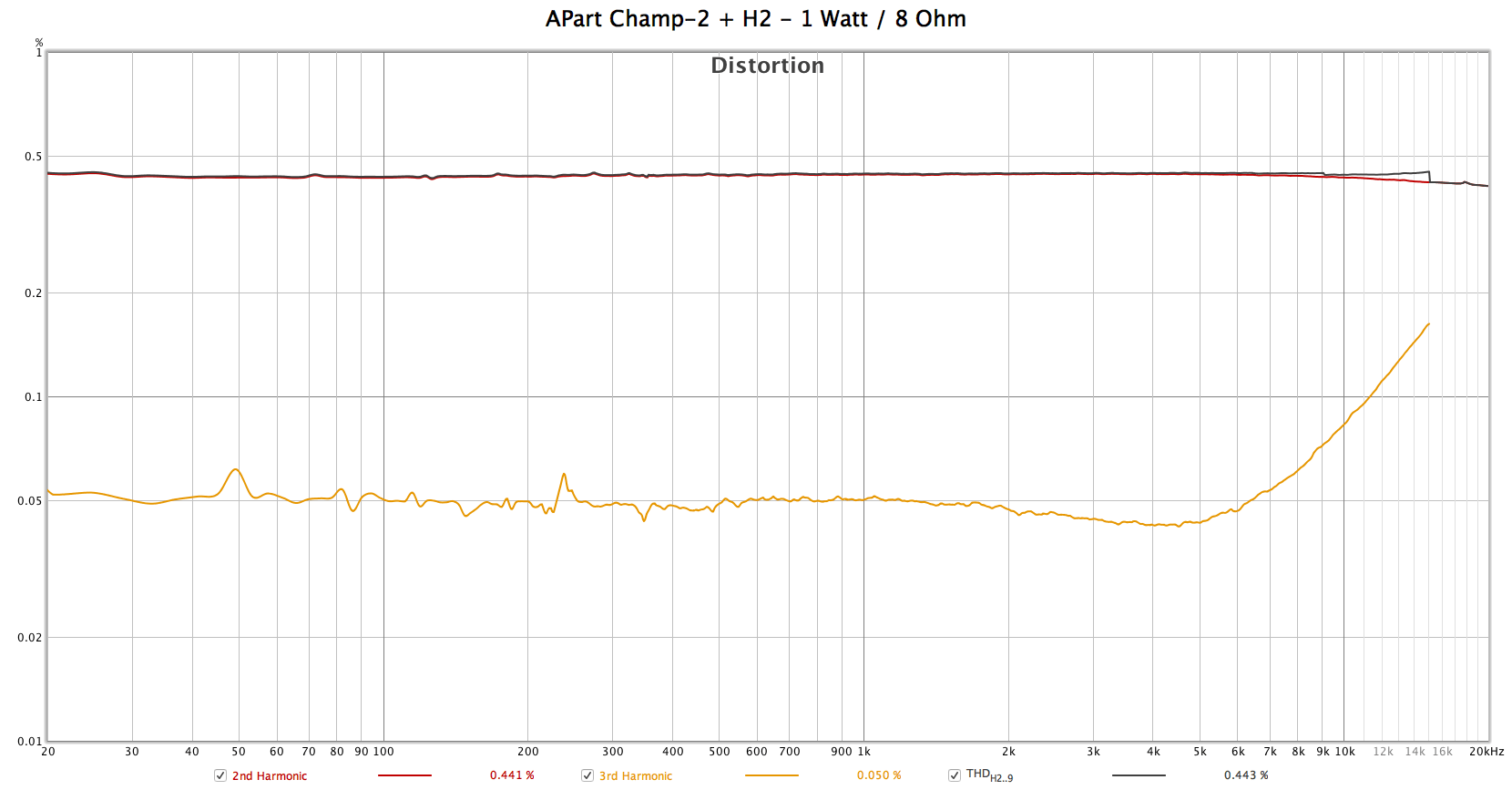

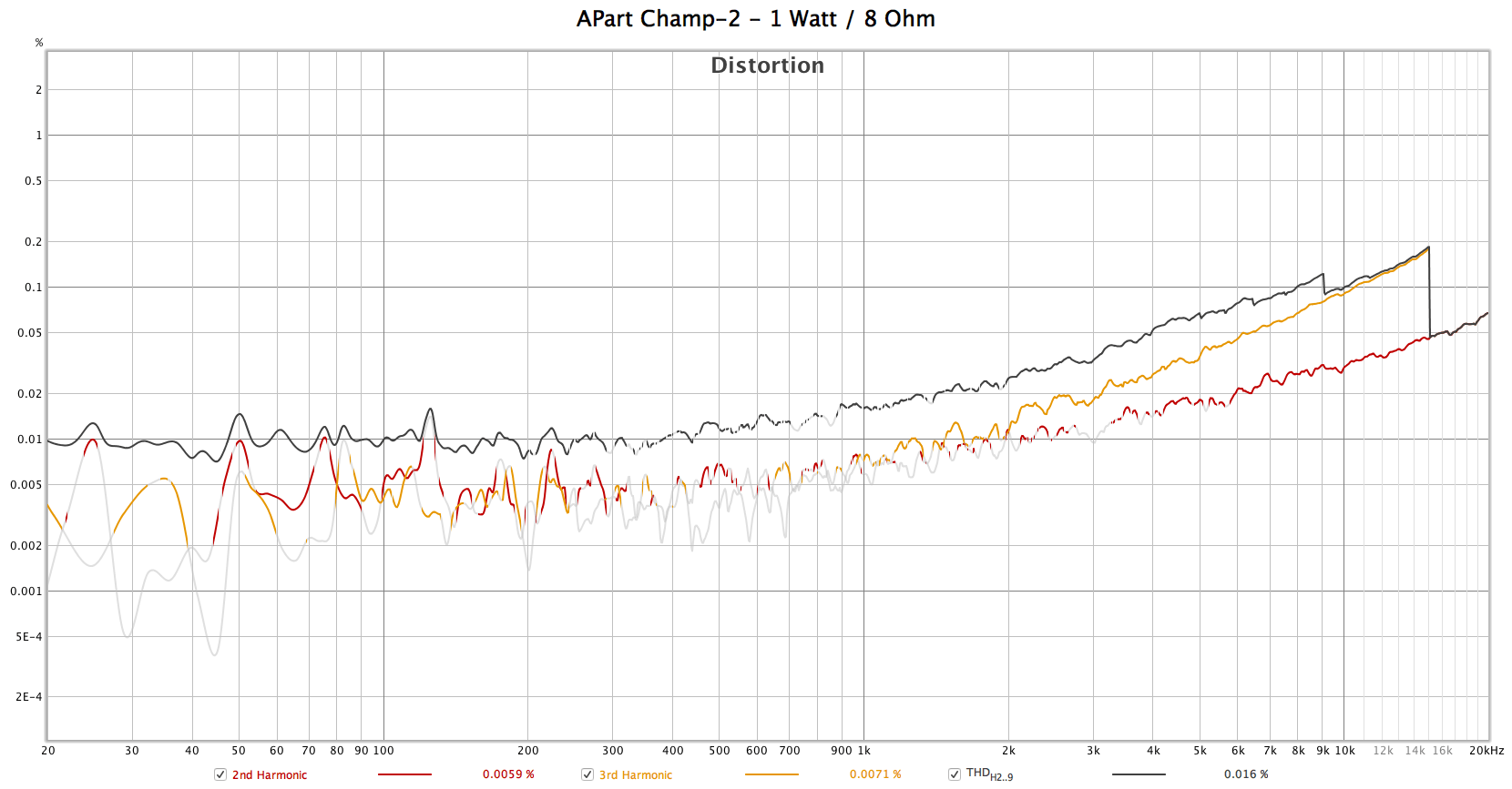

I have now passed on my H2 to another fellow. In the conversation we had I showed him how I used my H2 pre with two plots that I thought I had already shared here... but actually I didn't. So here they come.
I have a class AB pro amp with low THD (< 0.02% at 1 KHz, first plot) with level controls. By playing with the H2 volume and the amp level controls you can change the level of distortion as you wish. The two plots below are before and after adding the H2 at an arbitrary volume level and reducing the amp level controls to get the same 1 W on a 8 Ohm resistor load. There you have it a 0.44% THD level across the spectrum of pure second order harmonic. Play with the levels and you can change the THD to be higher or lower.
The real game here is that you set the levels based on your listening impressions and then measure what it looks like in terms of THD. I don't remember if this was the case for me. It was a while ago...

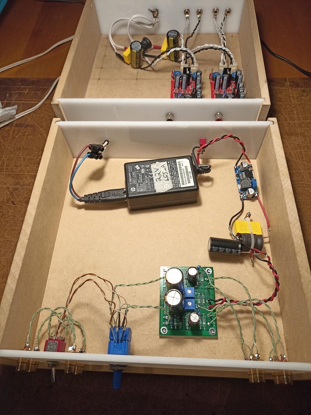

Finished my H2 kit and boxed it up in a cheap mdf enclosure. Using an old HP wall-wart, stepdown converter and CLC filter for 12V supply. Quiet as a dead mouse. I built it as a preamp with dual inputs, volume pot and dual outputs (for bi-amping). This H2 preamp with 9dB gain is absolutely the perfect match for my TDA8932 Class D (dual mono kits from Abraxalito) amp, driving full range speakers. Big and wide soundstage. Very musical combination. This is now my main daily listening setup and I am very happy with the sound.
Thank you Nelson and team for a simple but great sounding preamp!
