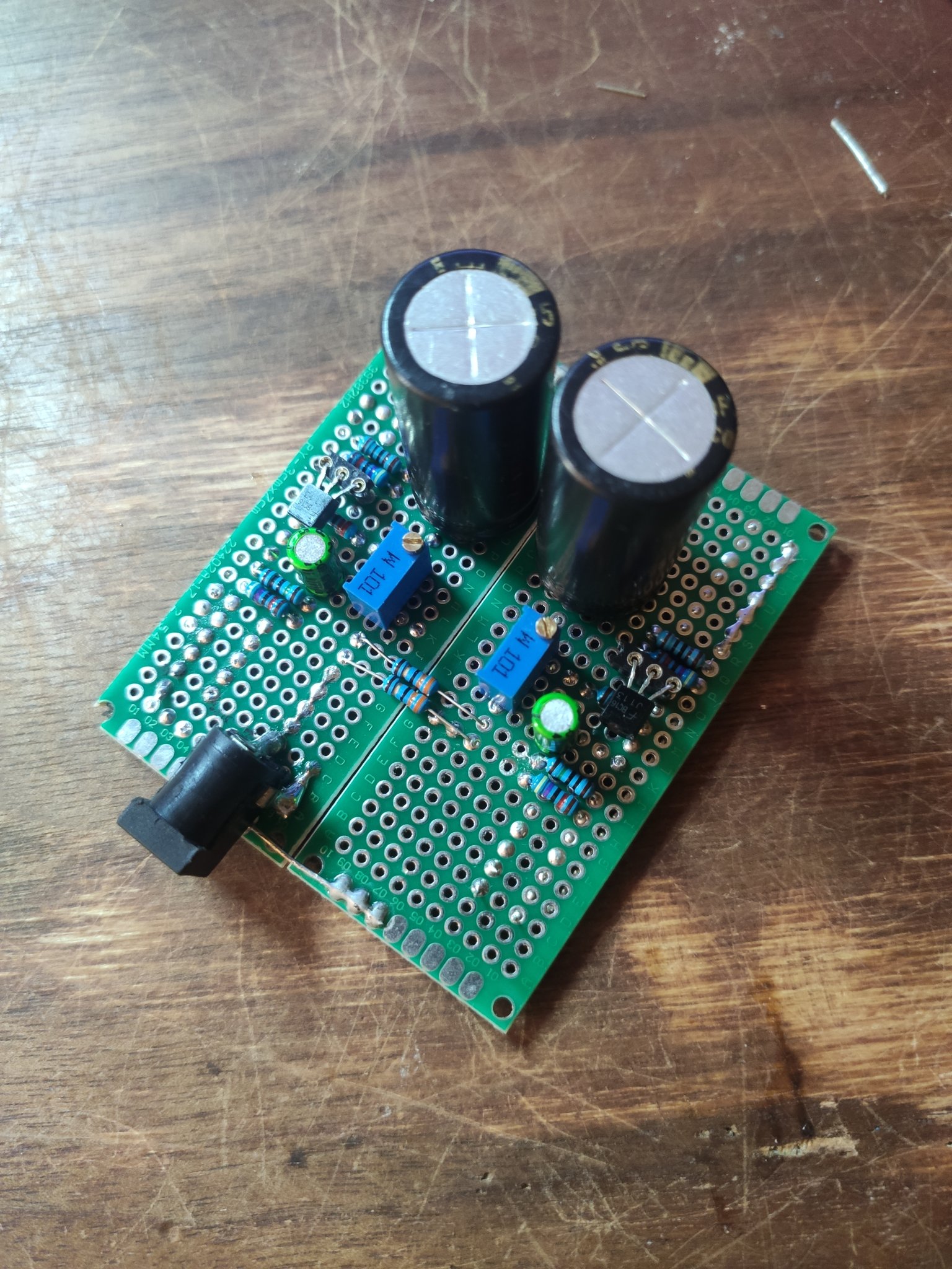

Hi, I did my diy version based on schematic. I choose random J113. My result is very noise. Is it because non matched j113 ? I just only have voltmeter.
