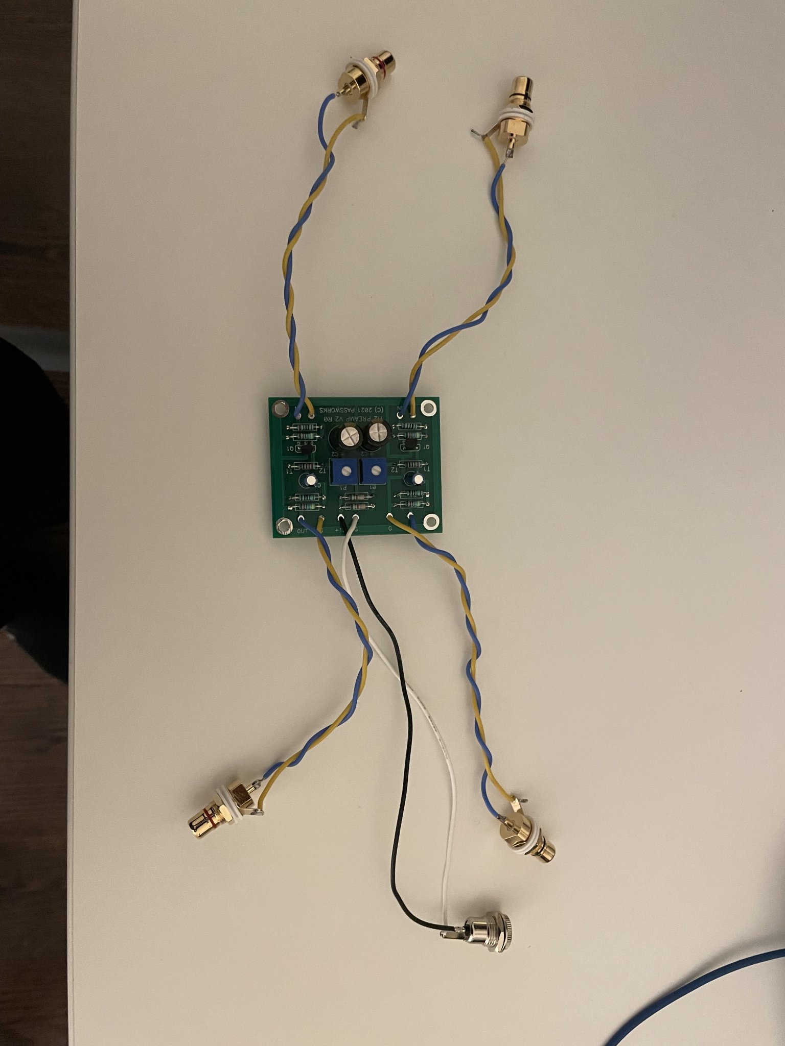

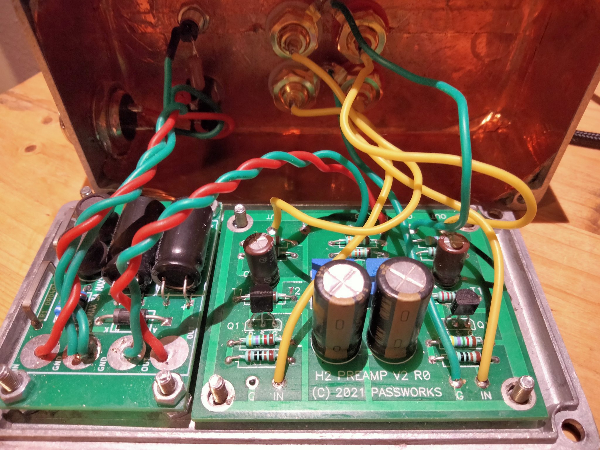

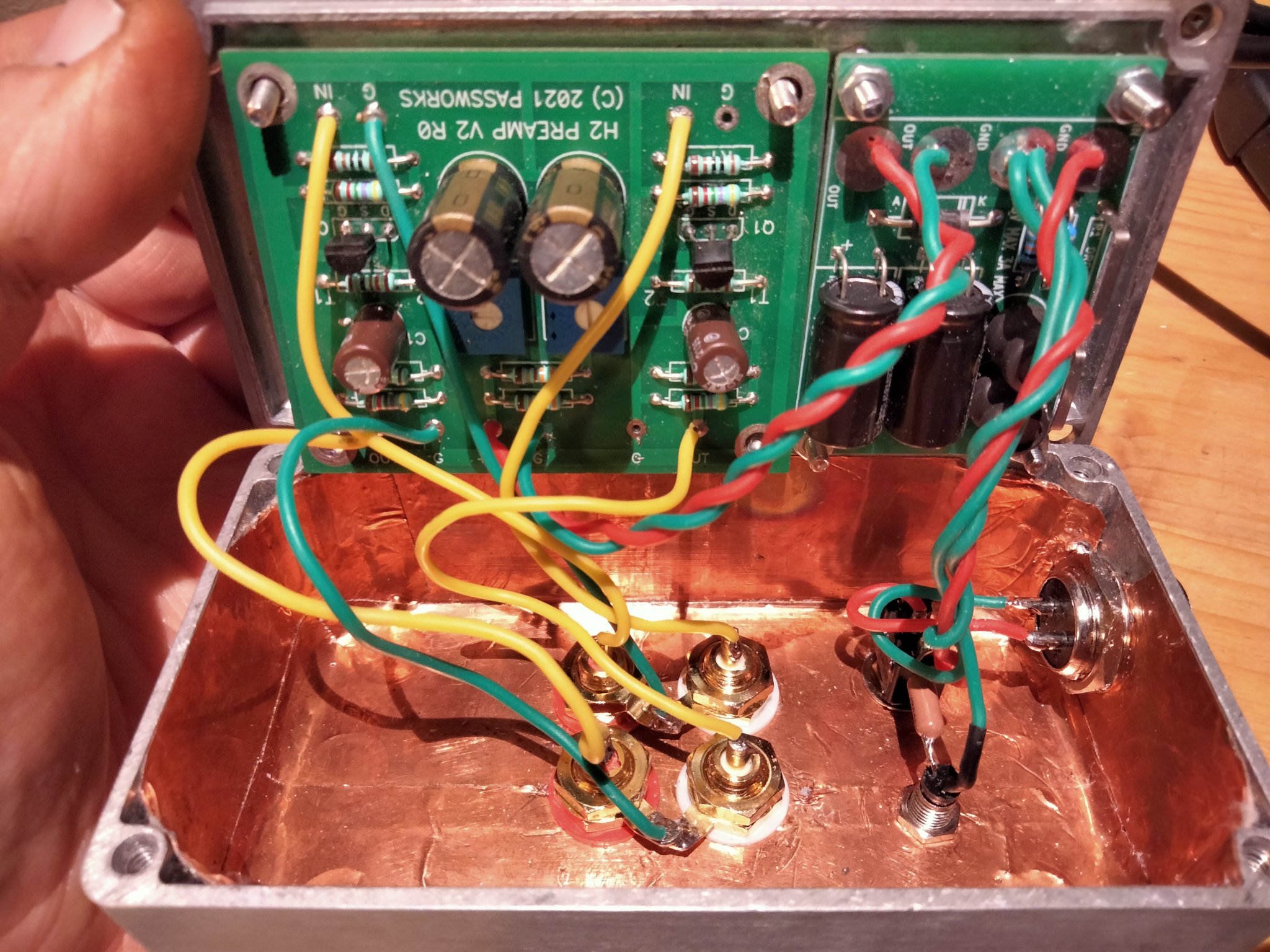

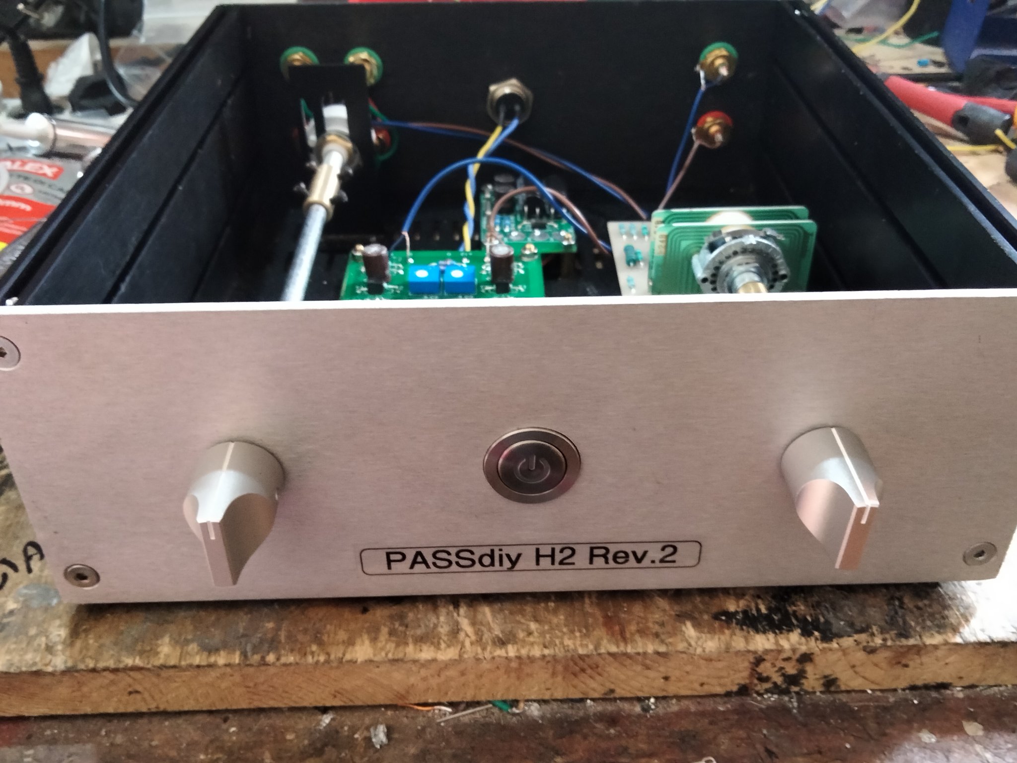

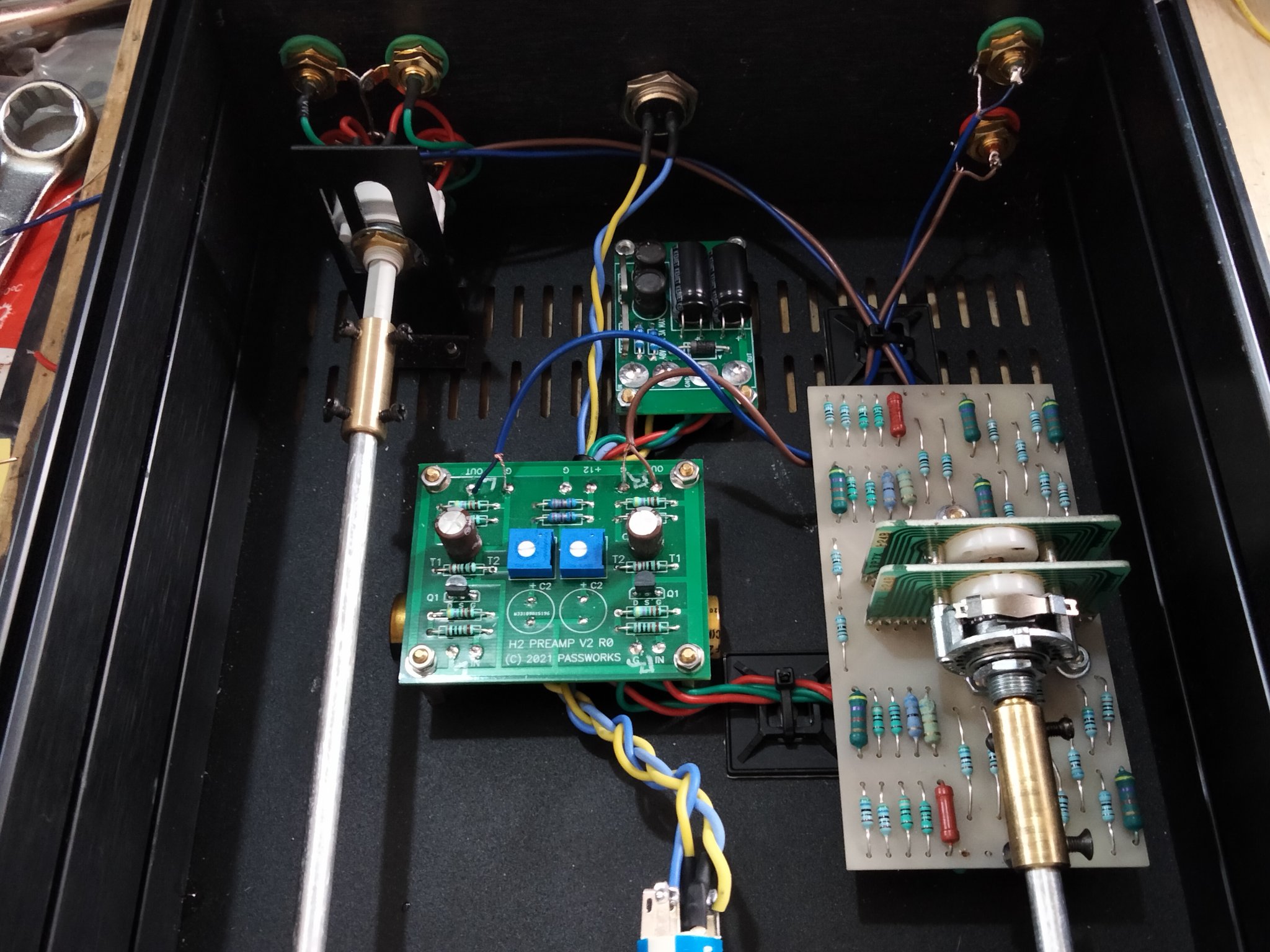

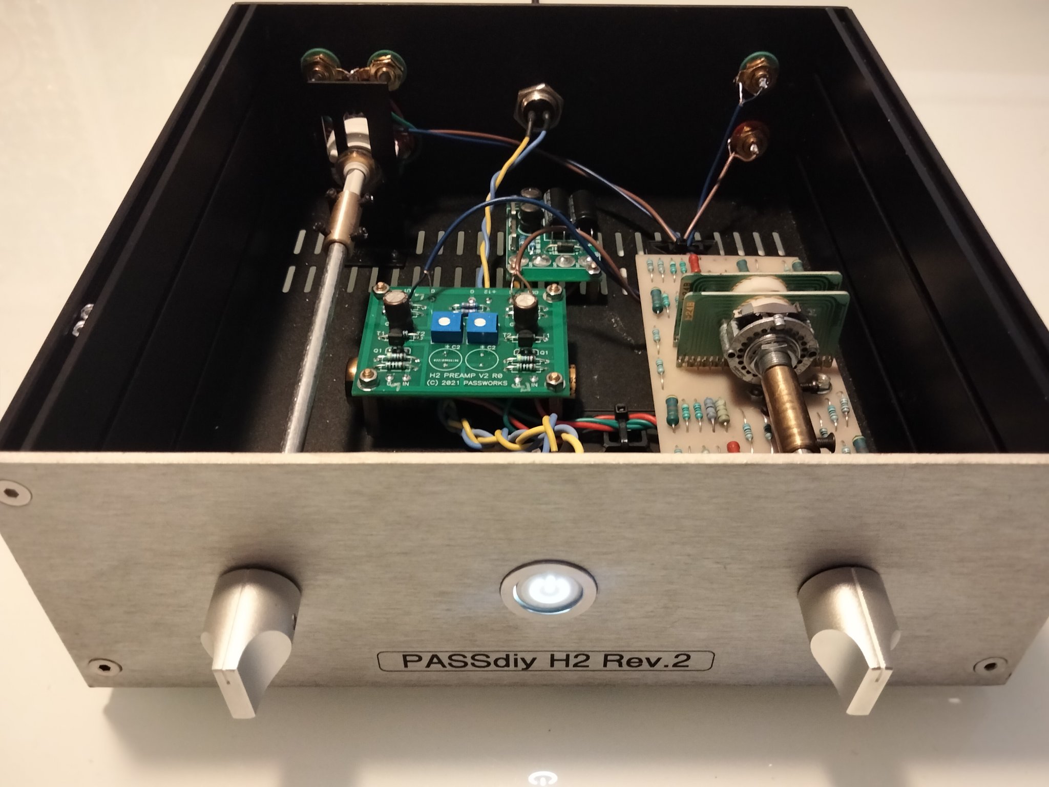

This is what my final build looks like. I used my multimeter to test connectivity between the grounds on the input and output RCAs and they all connect to the grounding ring around the outside of the board. Plus they connect through to the negative of the power plug. Not sure if that means they are all grounded since this is not in a box with a ground wire connected to the box. I adjusted my pots to show 10.71V at T2 since that is what is written on my bag.

Looks good. Did you build it for unity gain by changing the resistors? If not, and with no volume pot, it might be caused by running the H2v2 at full gain. I'm not sure if a hum would happen.
Yes, that means they are all grounded.Not sure if that means they are all grounded since this is not in a box with a ground wire connected to the box.

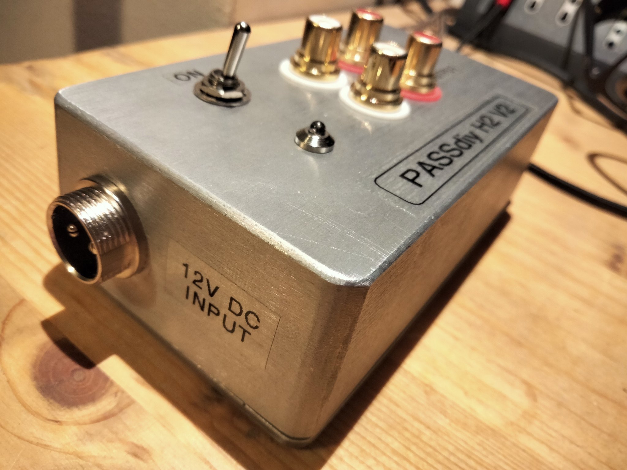

Nelson discussed in the original H2 paper that the circuit is susceptible to noise and should be in a metal case.
You could try using a metal container placed over the circuit board like a hat. I use masking tape around the edges to prevent short circuits from the metal box. Be careful.
No need for a wire from ground to the box. Let the ground "float", no connection to chassis ground. The 12v SMPS is a small enough voltage not to hurt you.not in a box with a ground wire connected to the box.
