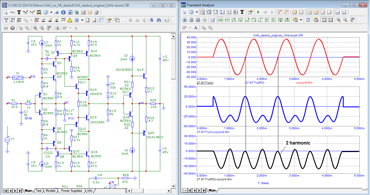

Another question I'm curious to the answers about:
How a 1kHz input signal can (even continuously) produce a higher frequency harmonics, "signals"?
Can someone give a concrete practical example how it's produced?
For example taking a specific part/circuit in transient mode explaining it during a few period of the sine wave?
Is this an example good enough?
The gain of the amplifier during the signal cycle is not constant, but varies with the signal level. For instance, with 1V signal the gain can be 10, and with 5V it can be 10.01, and with 10V it can be 9.97. It can also be different for positive and negative signals.
The result of this is that the output is not an exact copy of the input (only changed in level). It is changed in shape, the peaks may be a little lower or higher than the input signal.
Mr. Fourier has discovered that you can take apart that not-exact-the-same output as a combination of an exact copy of the input, plus (or minus) another signal, added/subtracted from it. This is the distortion, and it consists of normally quite small signals with frequencies which are an integer multiple of the input frequency. See attachment, courtesy Guido Tent of Tentlabs and Grimm Audio.
It's easy to see that the level and distribution of those harmonics depend on how that output wave deviates from an exact copy of the input signal.
Does that help?

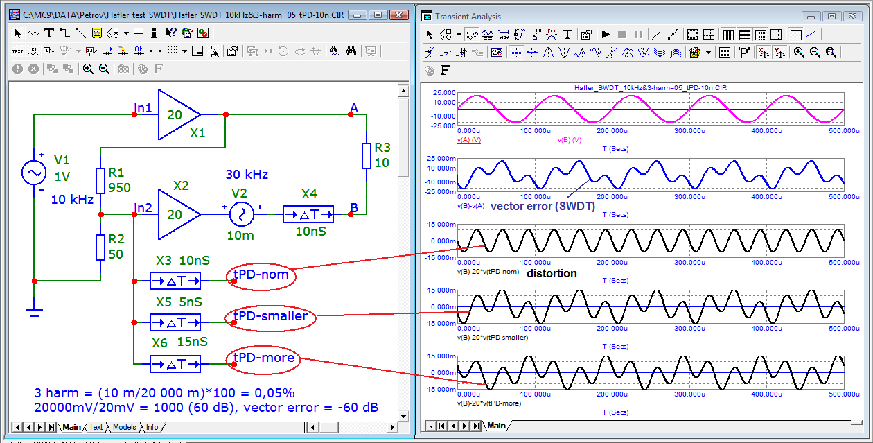

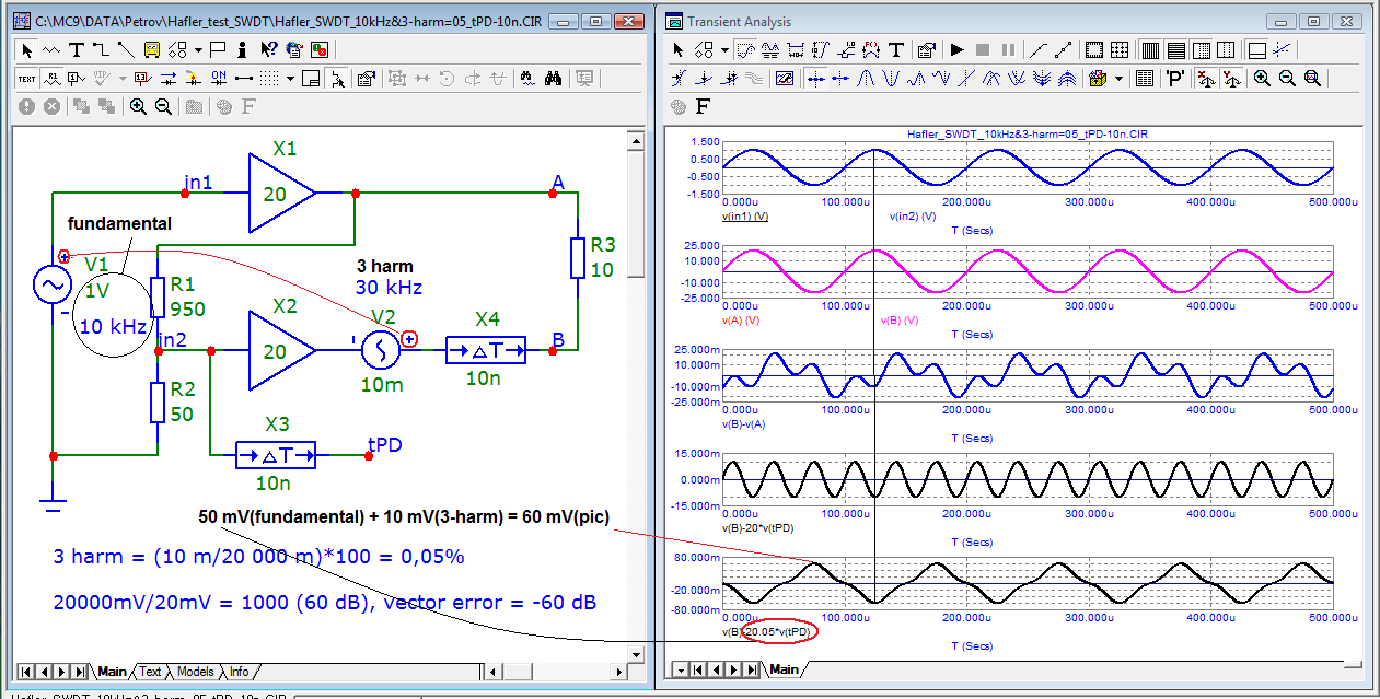

Please excuse the poor quality sketching below. It was produced on a "reMarkable 2" pad that my daughter gave me as a gift. Nice girl... more than I deserve.

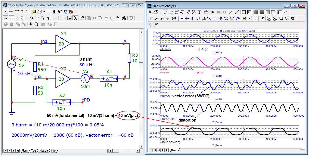

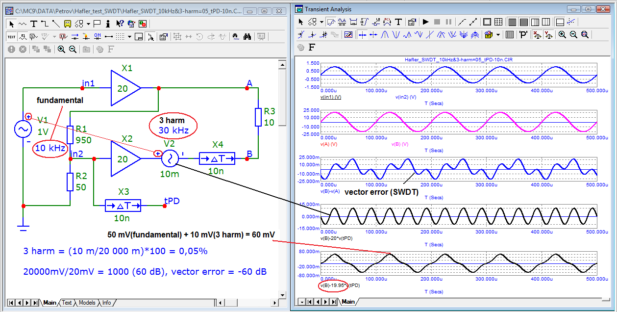

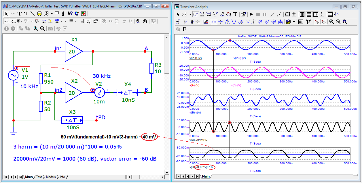

Hierfi, you showed the measurement results for the 3rd harmonic when it is in phase with the fundamental.
Consider the measurement of distortions by the Hafler method on a model of an amplifier made on ideal components with artificially introduced nonlinearity in the form of the 3rd harmonic. The third harmonic can be either in phase with the fundamental harmonic or in antiphase. Let's consider both options. If the fundamental harmonic is undercompensated, there will be a residual level of the undercompensated fundamental harmonic in the distortion products.
Everything is signed in the figures.
What is undercompensated fundamental harmonic? Do you mean a part of the fundamental that is not nulled out by the subtraction?
Yes, in that case we'll see some fundamental in the output (difference) signal. But it is not part of the distortion, of course.
Or is there another point you want to make? Should you not make a better subtractor to null the fundamental completely, with a lead capacitor or something?

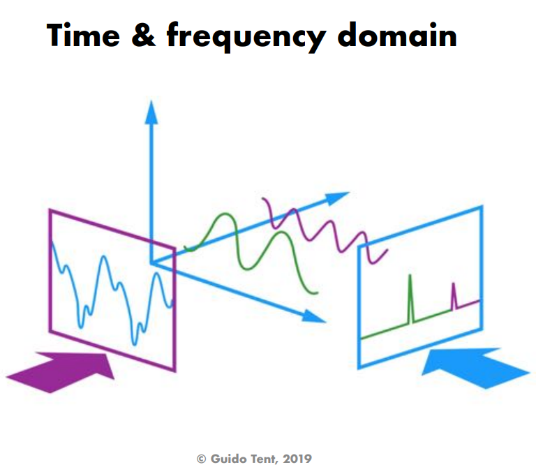

Has this thread lost track?
If I take a step back ...
To answer the question on distortion Jan pointed out that harmonics over the base frequency of a continuous sinewave arises through a non-linearity in the response of an amplifier.
Those harmonics can be determined from a Fourier analysis which is usually carried out by a fast Fourier transform algorithm.
In theory combining those harmonics will lead to reconstructing the original signal, thereby demonstrating that they are indeed components of the original.
But often the FFT results are plotted as amplitude only. The reconstructed wave can look quite different from the original if the phases of the harmonics are not considered, which has been correctly pointed out. You have to go a step further than just reporting the amplitude to obtain the phases.
When it comes to music this is a different situation. Music is not a continuum of sinewaves, but a series of sounds which are made up from waveforms that start and stop, with varying frequencies of course, and with varying attack and decay characteristics on perhaps any of the harmonics.
These cannot be expressed in terms of a Fourier series of signals, but as an integral of a frequency function (if wanting the time dependency) or vice versa. That integral extends from potentially - infinity to + infinity, but the point is that it contains, essentially, frequency components that extend a long way out: a pulsed sinewave of one, or ten, cycles is not by any means a single fixed frequency.
THerefore, passing a signal which contains high frequency components (even if not expressed as a series but an integral) through a bandwidth limited amplifier is going to cut the higher frequency components out. So the perceived sound will depend on the bandwidth; and to a first order an amplifier can be considered as an RC filter which will give a first-order indication of the output.
That has driven the need for a high bandwidth in hifi amplifiers, but there seems to be a general agreement that something in the region of 200kHz is adequate for most listeners.
On top of that, any capacitor or inductor will change the nature of the signal. For example, older amplifiers with coupling capacitors, typically 2mF in the old days, had a poor LF response where the phase shifts create a voltage which is not present in the input. This isn't a harmonic distortion but can be seen in a simple CR network equivalent, to a first order. It is particularly shown up in that a 20Hz cut-off (-3dB), which used to be a target, has a lousy square wave response at 20Hz, thus causing some bass to sound "thin" or "weak".
So it seems to me that "first cycle distortion" is an unfortunate term which confuses essentially a response of a finite bandwidth limited system to what would be an "infinite" signal source with actual harmonic distortion.
Though many if not all music signals are filtered in any case, making the need for power amplifiers over about 200kHz less necessary, and the low frequency artifacts can be ameliorated by using big feedback decoupling capacitors - or even extending the response to D.C. (which I tend to do as that avoids "capacitor distortion" in the main!).

With overcompensation (Ku (tPD) = 20.05 of the delayed input signal is greater than the nominal (20.00)), the error waveforms will be mirrored to those that occurred with undercompensation (Ku (tPD) = 19.95)
completely zeroed fundamental signal on the 4th chart out of 5
I *think* what you say here, is that when the fundamental is not nulled out, a small residual level will be shown in the output of the difference network.
The distortion will be shown also of course and added to this residual, and it will depend on the phase of the distortion how the resulting waveform will look.
Yes?
In that case I agree.
Jan

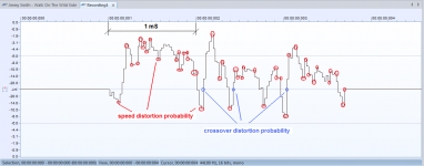

Let's take a fragment of a music signal from any editor and see what it is.
As we can see here nothing resembles a sinusoid, even its half-cycle.
I highlighted the zero crossing points with the highest slew rate in blue; these are the places where crossover distortions are likely to appear.
I highlighted places of abrupt changes in dV/dt in red - these are places where speed distortions may appear.
As you can see, there are many times more places highlighted in red than in blue.
And if crossover distortions are clearly noticeable by ear in a number of class AB amplifiers, then speed distortions will be perfectly audible even in class A amplifiers, if measures are not taken to minimize them.
According to Hafler's ideas, the signal propagation delay time should not exceed 10 ns, only in this case we will get vector errors at a frequency of 10 kHz -60 dB. In what Hafler's mistake I have already shown on XL-280 tests.
