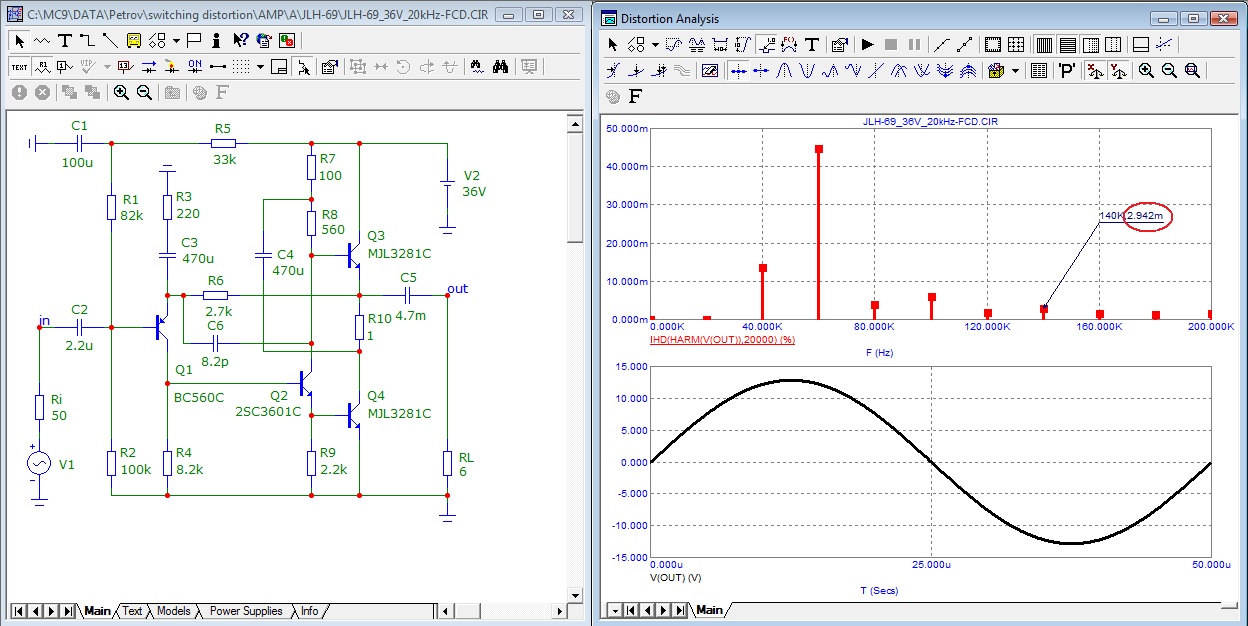

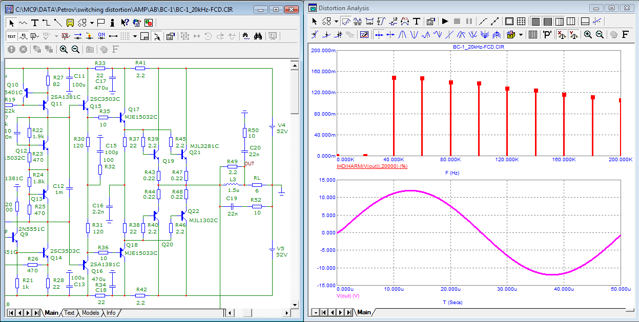

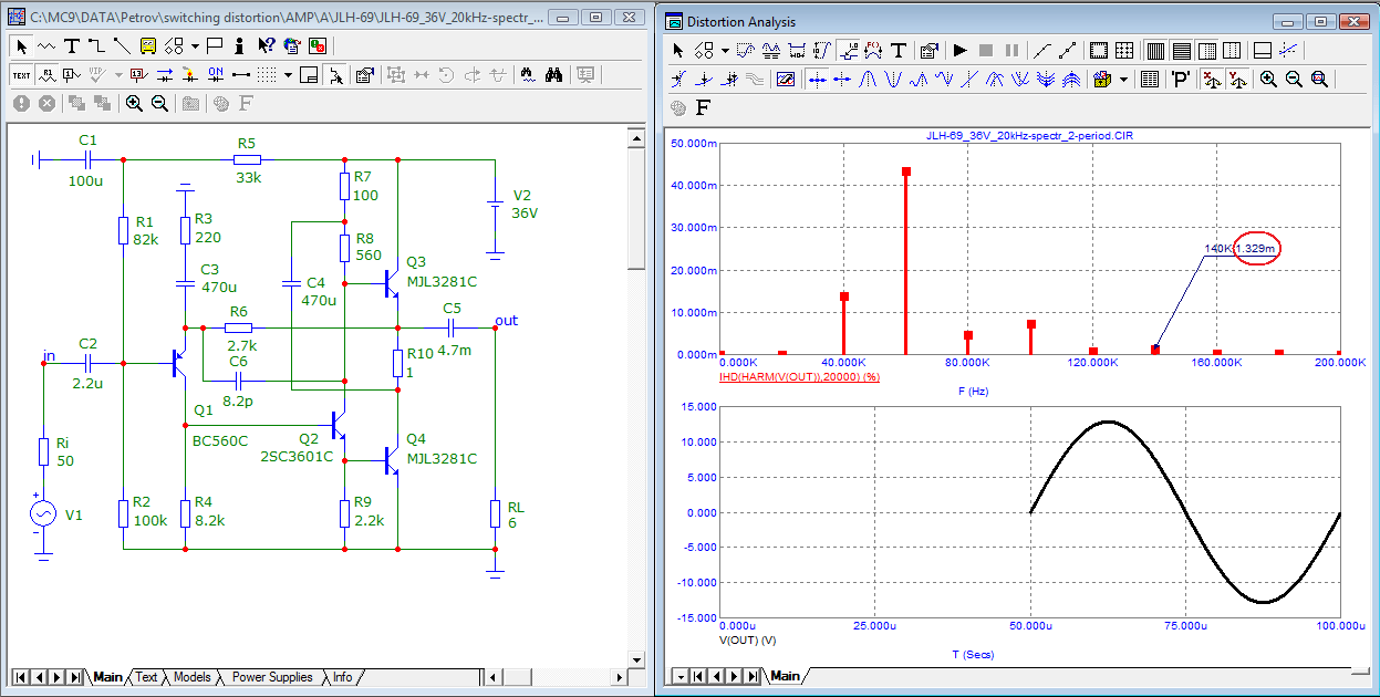

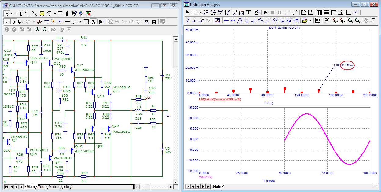

However, let's try to figure out what Graham put into the concept of FCD.
Here are tests of two amplifiers at the same output power on the same resistive load. On a reactive load, what the acoustic system actually is, the contrast would be even greater!
According to my understanding, the difference is related to the group delay, which, unfortunately, the developers still do not pay due attention to.
For example, John Curl pays special attention to the 7th harmonic and above.
Judge for yourself.
Unfortunately, the FCD test cannot be run on MicroCap versions higher than 9.
