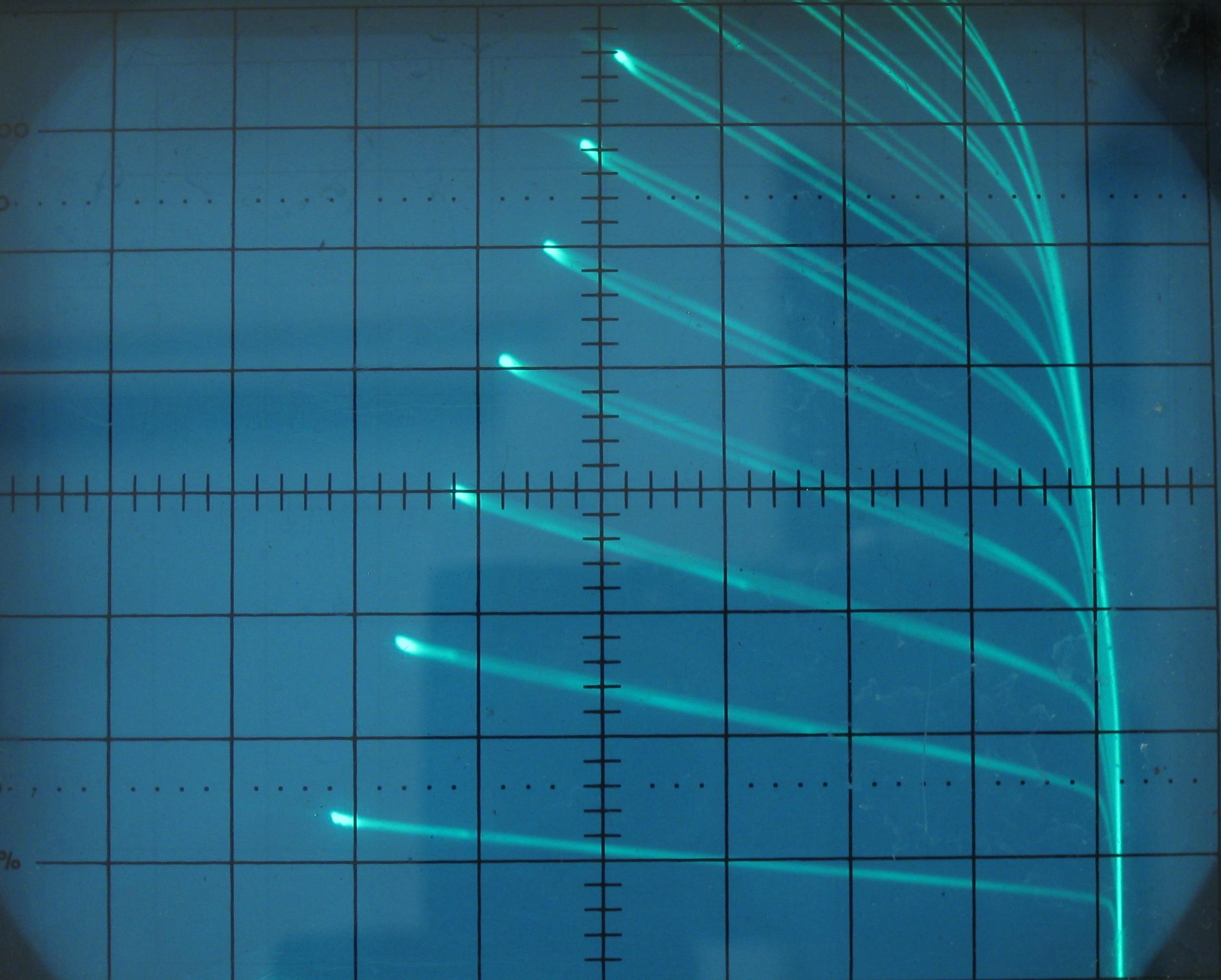

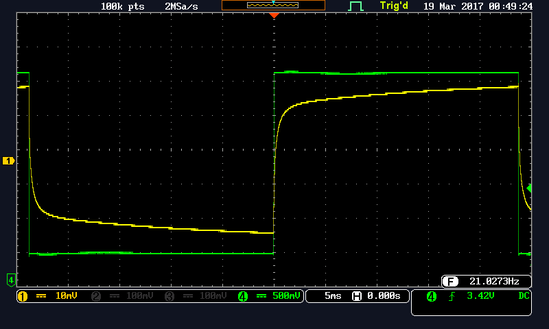

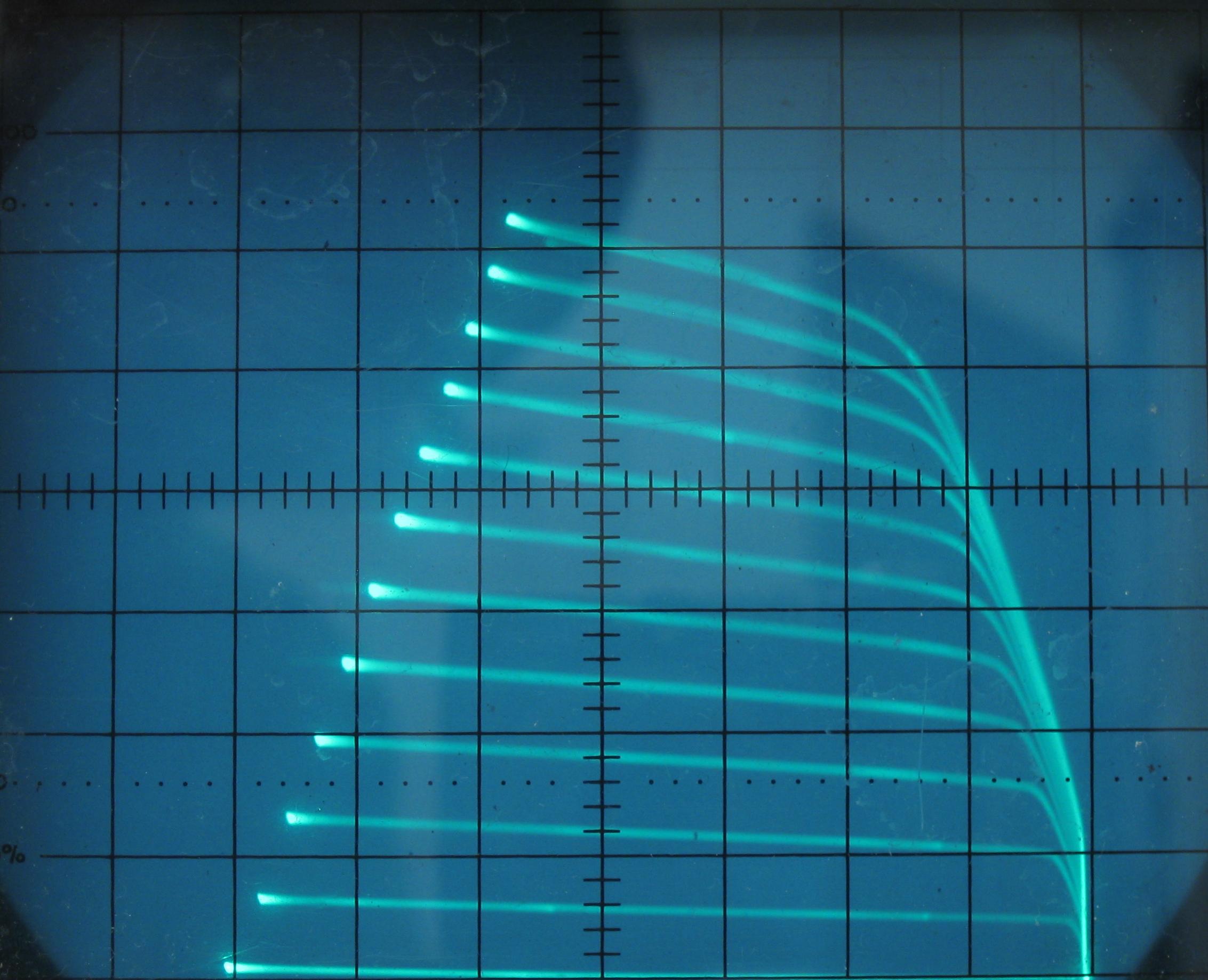

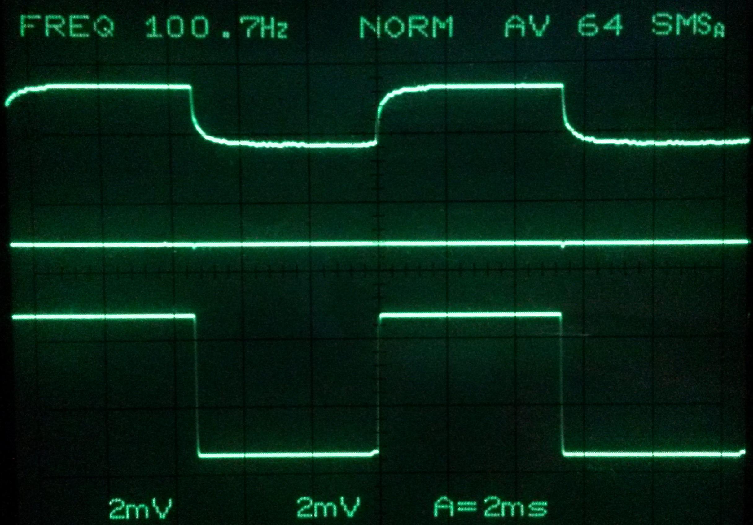

John, Thank You for your reply!
We certainly agree that the early effect of the BC550 is much worse than that of the 2SC2240. My curve tracer shows that at least for the complementary BC560C and 2SA970GR. Square waves, on the other hand, should be seen as an error, as the early effect is perfectly time-invariant. The transistor switches to the other operating point at electronic speed. There is a distortion due to thermal reasons. In the attached green scope photo, I measured a Philips BD137 cascoded with Philips BD137. That's a 380mA CCS. The upper trace is error on the emitter. (2mV/div) We could also say that this is a change in the current of CCS, as it is proportional to it. (90uA/div) Middle trace is the base. Connected to CCS loaded zener. (2mV/div) Lower trace is the collector of the cascoding BD137 transistor. (Sorry forget to note the exact sensitivity. Was around 1...2 Volts/div)
The error is almost purely thermal for the green scope photo. It is cascoded, so the early effect is almost completely ruled out.
On the BC560C blue traces thermal loops clearly visible. 2SC970GR is better.
The early effect is responsible for about 20-30% of the error on the color screenshot. The rest is thermal failure. This transistor was not cascoded, so there is a small part that switches at electronic speed due to the early effect.
There's no capacitor connected to these BJTs in any of these tests!
And finally a post that shows my three scopes at once. 🙂

Regarding your I-V curve plots, how do you determine the difference between a capacitively (Cjc) induced loop and a thermal effect?
Some more thoughts-
I would agree that a thermal time constant could contribute to a signal variation as much as an RC.
I suspect that thermal effects may well have accounted for some of the "transistor sound" in the old days.
Particularly amplifiers with large current and/or voltage variations in the transistors in key positions. Consider the old style PNP input, NPN driver and complementary or quasi-complementary output stage. If the input transistor current is too low, then the thermal variations with signal could be significant. In many old designs (and I have to say, the JLH10) the input stage current is too low I suggest.
If- and this is the point about high gain/high feedback - the signal deviation is small, then the thermal effects reduce.
So when we talk about amplifiers with what I would rather term "thermal hysteresis" we need to be specific about which amplifier. What circuitry and the thermal effects in each transistor.
Have you tried putting the BC550C on a small heatsink and retested the thermal time constant?
THere are however several thermal time constants in a device. There is the junction itself, the collector depletion region where the heat is generated (which includes part of the base). From there there are emitter metallisation and wire bonds (not much heat conducted that way, as I pointed out before) then the collector to mounting tab, the thermal mass of the silicon and metal adding at least two thermal time constants. Then the thermal resistance through the packaging and thermal mass of the package. You can see some of these effects particularly in a power device datasheet where the transient thermal impedance is plotted, which often has several break points. A sort of "inverse" Bode plot if you like, as this is in the time domain.
For small signal transistors the thermal effects are a lot quicker.
What I do find odd is that the audible difference between a 2SC2240 as you mentioned compared with a BC550 if the (main) thermal time constants are both in the middle of the audio band (1kHz vs 3kHz according to your results). That would suggest both devices would have audible effects. That is another reason we need to know the circuit details of any claims between devices.
