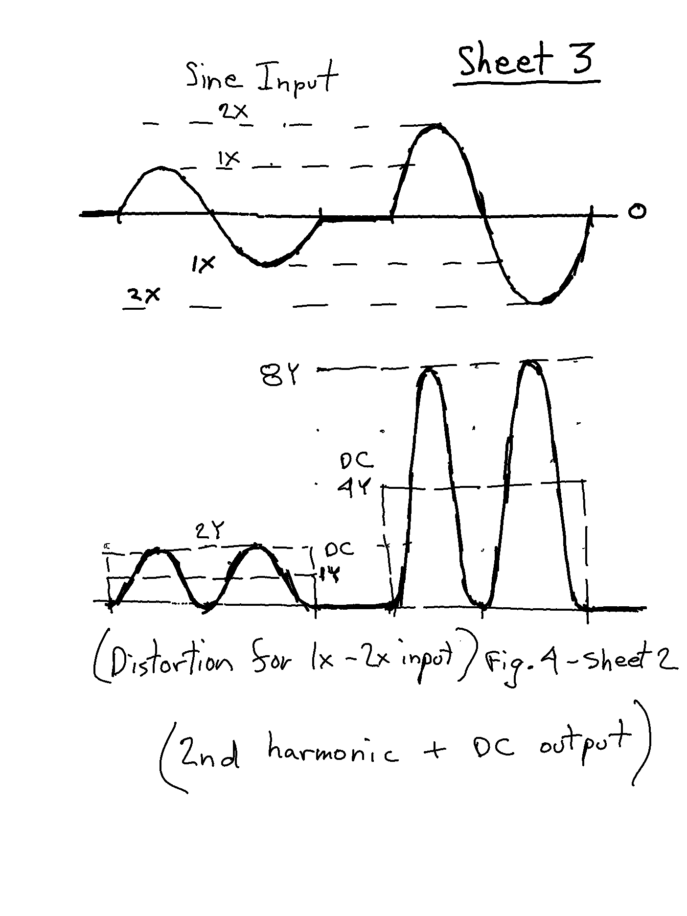

This is one step away from modulating the input sine wave by changing the amplitudes prior to DC. settling, causing what you describe as a moving D.C. average before DC settling occurs. This is why the distortion you describe can alternatively be identified as modulation distortion, for reasons that the nonlinearity as a moving D.C. can be generated from the modulation of the input sine.
This moving D.C. generated by amplitude modulation is a signal that can appear of reality above the low frequency cutoff point, this as a function of the sine modulation frequency being high enough to support its appearance. If this is then coupled out using capacitors it stores or "memorizes" this moving DC as causing phase shifting. In other words artificial bass is generated, that unlike linear bass, seems of potential a masking artifact preventing clear bass (as good bass), to be realized.

Yes, in audio design there are a lot of 2nd order effects, large signal effects, etc., that are difficult to model accurately. Not only that but if the system is good enough it becomes audibly obvious that burn-in effects are also occurring. The only way I know of to get to a superior sounding audio design which also measures well is to start prototyping, listening, and measuring. It helps a lot to have low distortion speakers in a treated room, just like it helps to have high quality bench test equipment. The point is that eventually one must leave simulation and move on.
I'm not sure that the description of a bass signal above the cut-off is really a good one. If we take the (poor, but illustrative) example of a typical 1970's design with input capacitor, feedback decoupling capacitor and output capacitor, three time constants will generate a combined low frequency roll-off which can be determined from the individual time constants considered more or less independent.
Take a typical set of time constants: perhaps an input capacitor of 1uF, with a 10k biasing resistor (-3dB=15.9Hz, perhaps pessimistically high) a feedback decoupling capacitor of 220uF with 47 ohm decoupling resistor (and a feedback resistor of say1.5k), and a 2.2mF output capacitor, the -3dB points being 15Hz and 9Hz) the combined -3dB point is about 26Hz. This does not even handle a 1mS pulse (square wave single) well, and reveals a high level of a (heavily damped) oscillation following the pulse. The following "bounce" crosses the zero line twice, discounting the first crossing on the down edge of the pulse which is a result of the RC droop.
But that trailing "bounce" is best described by the exponential time decay constants. Superficially it seems like a sinewave (heavily damped) with a frequency of about the same as the LF roll-off, but as I mentioned, the exponential nature of the RC circuit extends the response which may account for your "higher than LF roll-off" description.
The point I would make is that this is largely a consequence of the AC coupling, and well described by the response of RC coupled circuits to a signal, not a new distortion mechanism as it has been like that since, well, the first RC circuit was put together.
It does, however, explain the poor bass response of those early amplifiers, whatever input signal is applied and distortions added by the amplifier. Or, taking mjona's point, the distortions of older capacitors with (realtively) high ESR and ESL, which may be non-linear, but that is somewhat separate to the fundamental of RC time constants.

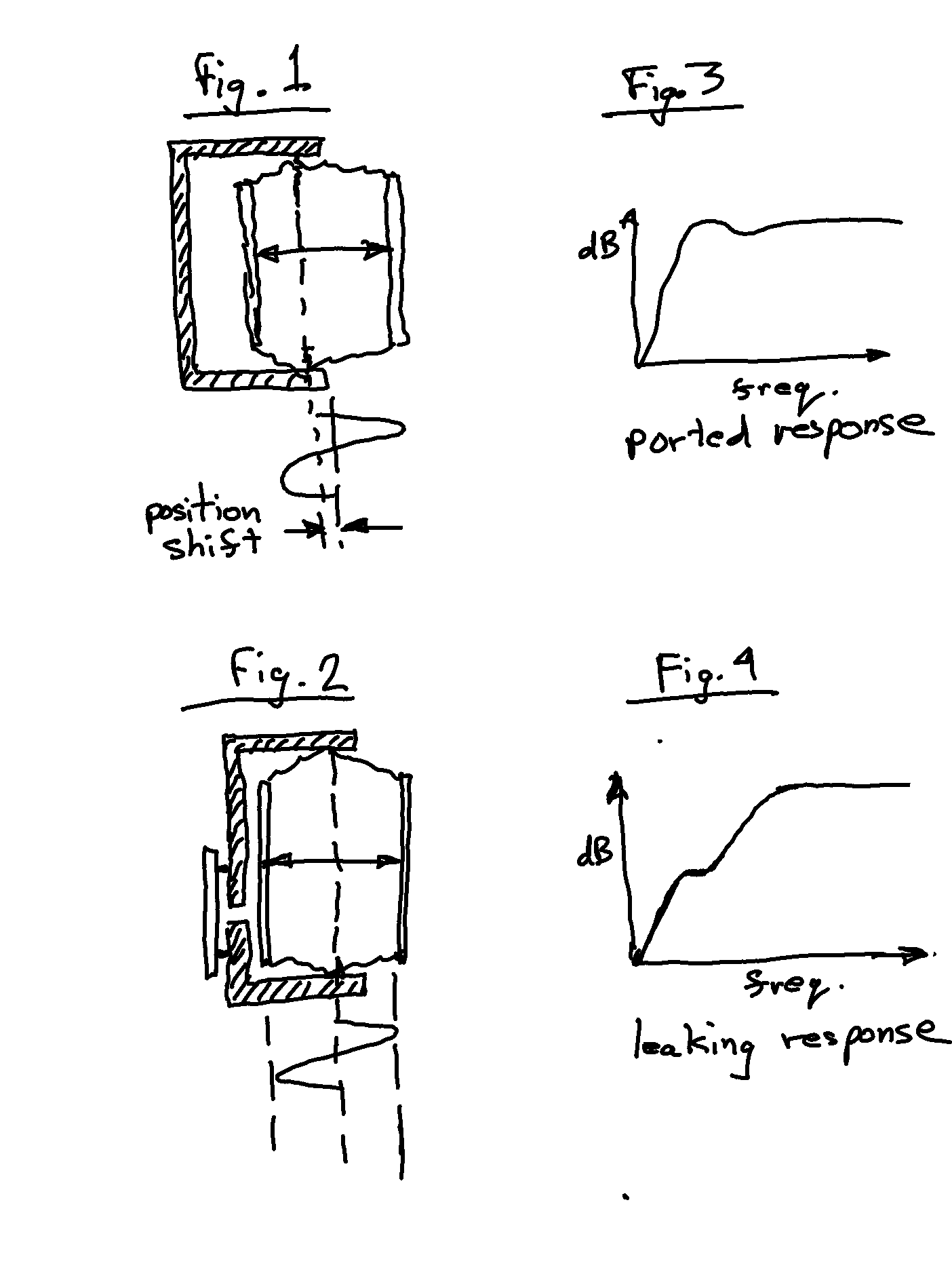

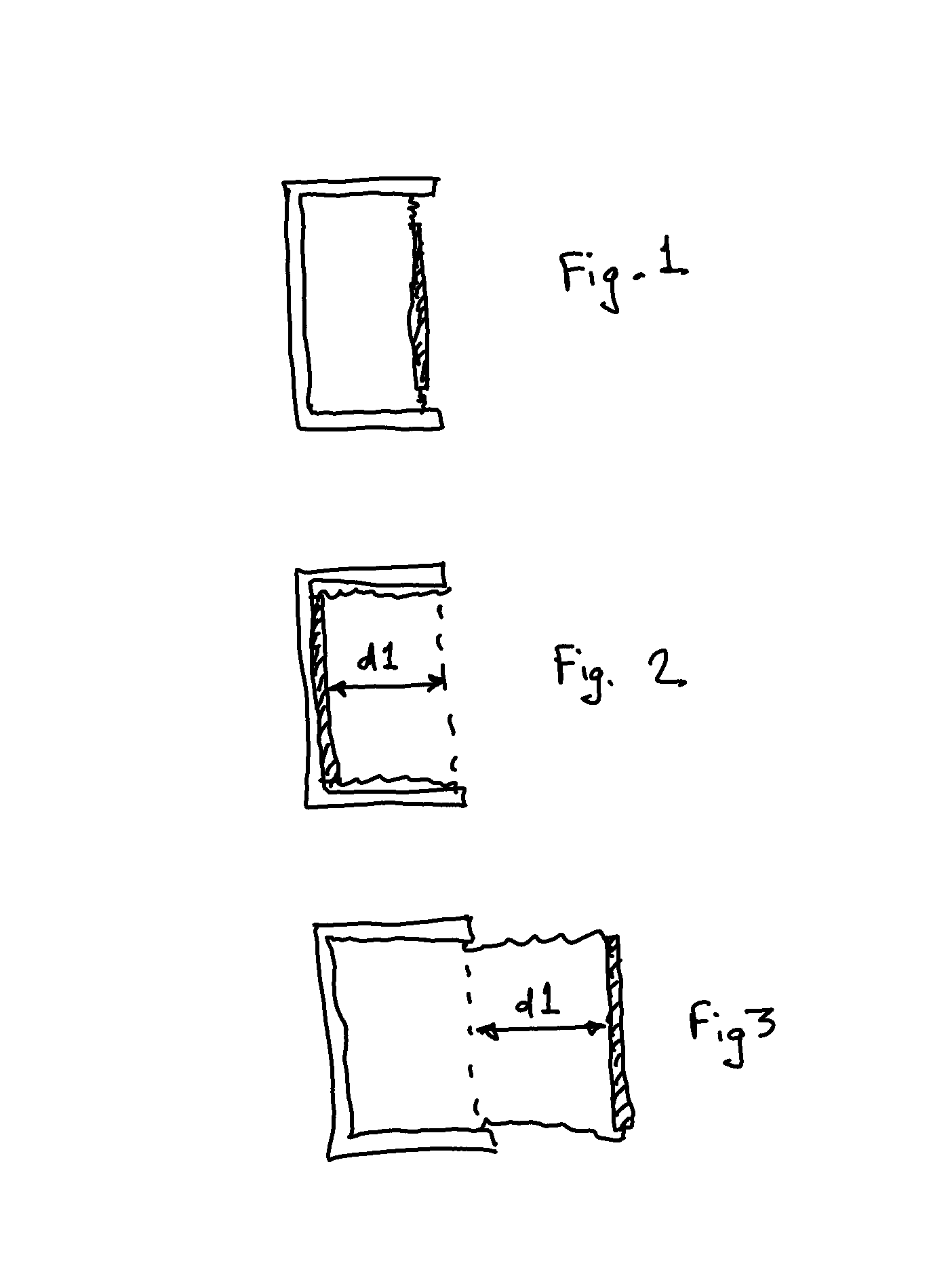

Mark,
I’d first like to admit that my mind goes off track faster than a teenager seeing his first hooker. Please excuse the graphics, the intent was to be succinct. Speaking of speakers in relation to the 2nd harmonic, consider a closed box “air-suspension” speaker shown in figure 1 below. This is shown from the side, being considered having a rectangular flat piston that takes up the entirety of the front face. If we then apply a symmetric sine force of sufficient amplitude, and the speaker is not affected by variant internal pressure, the displacement extremes could take the positions indicated in Fig. 2 going inward and Fig. 3 going outward. In other words the speaker is of symmetric displacement.
If the internal pressure is taken into account, under circumstances the displacement is still that of Fig. 2 and Fig. 3, the inward pressure rises to infinity (as the enclosure volume reduces toward zero) and the outward pressure reduces to 1/2 going outward. The conclusion is that pressures are a-symmetric inside a closed box, as thereupon generating 2nd harmonic. What also occurs is that for any input sine signal that is fixed, there also exists a fixed displacement of the speaker diaphragm for each input level, as likely of proportionality to the amplitude of the 2nd harmonic. With the exception of leakage, closed box systems have no equivalency of high pass filtering. This includes under circumstances that the input is capacitively coupled. Hence modulation distortion (or inter-modulation distortion) generates components down to DC as physical displacement errors for any form of input stimulus.
Notwithstanding that such analysis is indeed correct I have been experimenting with creating leakages in cabinets, those being tuned psycho-acoustically. As you can imagine, (and seem likely to have personal experiences) there is always a difficulty in what is concluded correct or incorrect, or being perceived of improvement. It is always difficult to rule out distortions as existing unknown, and that the improvement is one of negating such distortion with another.
Gerrit

Gerrit,
Not a fan of vented boxes, bass reflex, and or of passive radiators. If using box speakers I would rather sacrifice efficiency in exchange for more accurate LF transient response. That means a preference for sealed boxes of sturdy construction. Surely there are some others who would agree.
I agree in that vented boxes, bass reflex, etc., create bass as a function of damped resonance and hence can't deal with transients, however that isn't really what was meant.
Fig. 1 shows the results of non-symmetric pressure, that for small boxes it can be realized increases in severity for a given SPL more quickly than a larger box. However if the boxed is "leaked" the buildup of pressure at lower frequency is released, resulting in returning the position back to the origin. It can be considered a mechanical way of capacitive coupling at low frequencies.
Fig. 3 shows a normal frequency graph for a ported design. Figure 4 shows what is expected happens for a leaky enclosure. Although transient response would still be affected this is balanced off by reducing the negative effects of non-linear pressure.
It is also considered that ports on many well respected speakers are smaller than would produce a response as deleterious as Fig. 3 indicates.

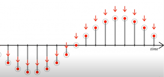

Come on Petr, you know this waveform is nonsense. You have connected samples with straight vertical and horizontal lines, and that is completely artificial, the signal does not look like this.
Run it through a band limiting filter or an ADC anti-aliasing filter like in the real world.
Don't try to prove something with stuff that doesn't exist.
I will give you the benefit of the doubt and assume that this is a result of your not knowing and not a deliberate misleading.

This is incorrect. Such a waveform exists only in NOS dacs without any output filtering. I would think there are not many who would enjoy listening to such.
They have no idea what aliasing is. They think the filter is to smooth the 'stair steps', which aren't there to begin with. It's called a reconstruction filter.
I've posted the link to the YouTube that explains it twice now, but some can't learn even if their life depended on it.

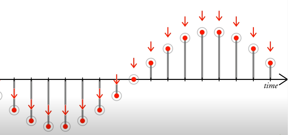

The samples are discrete time samples, like:
time 1 - value 1
time 2 - value 2
etc.
There are no stair steps, it's an artifact of the graphing!

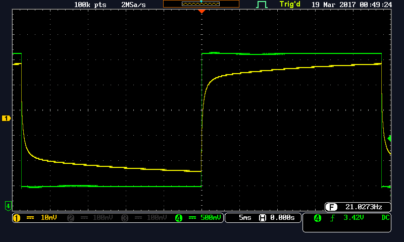

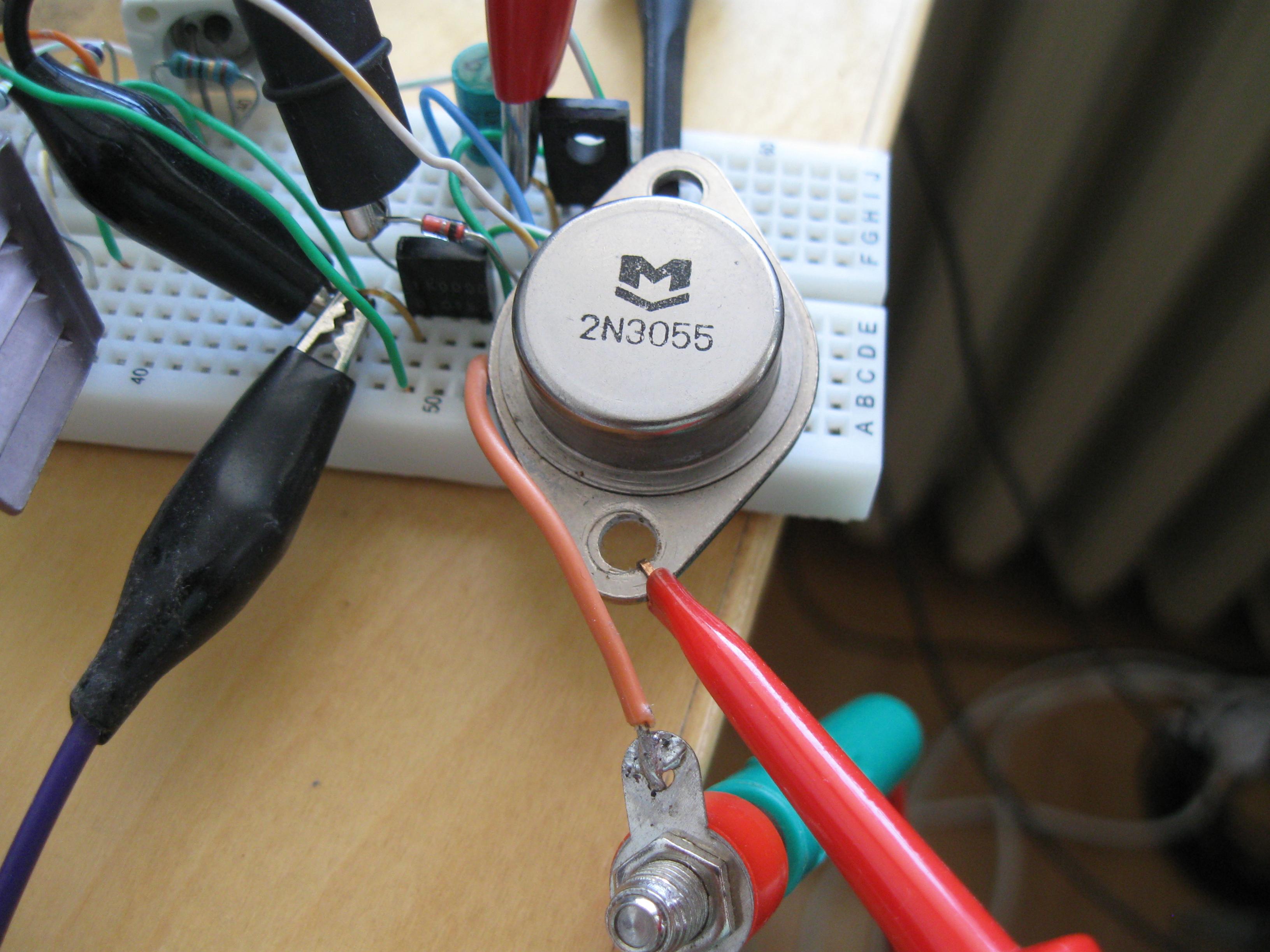

I measured 11 types of NPN transistors with a 21.03Hz square wave 4 years ago. I measured the termal error and the thermal cut-off frequency. The thing stopped then because I did not make the measuring circuit going down to DC voltage and so the data obtained is not necessarily accurate. It had a 0.035Hz filter in it. I implemented it on a test panel. Since then, I’ve been designing a PCB for it with offset adjustment. During the measurements at that time, I looked at the transistors with a current of 5mA connected as a constant current generator, and the C-E voltage varied between about 20 and 45 volts. Clearly, the OnSemi BC550C was the worst with its very high thermal cut-off frequency of 3kHz. The Toshiba SC2240 and OnSemi MPSA06 have an average of 1kHz. According to many reports, and to my ears, the 2SC2240 sounds better than the BC550. In the attached image, green is the C-E voltage (actually not 500mV/div but 5V/div) and yellow is the DUT emitter. (It's really 20mV/div) I could not measure the thermal cut-off frequency of the 2N3055 with the circuit at the time. It's clearly below 100Hz.

They have no idea what aliasing is. They think the filter is to smooth the 'stair steps', which aren't there to begin with. It's called a reconstruction filter. Jan
'We' know very well what aliasing is. It's only exists because of inadequate sampling frequency. Probably at 384kHz there's no more need for an aliasing filter.
There is no aliasing on the vinyl record. :D
AX tech editor
Joined 2002
The effect of aliasing has nothing to do with sample rate, it always occurs , with 44.1kHz as well as 384kHz. Unless you take measures.
Please review it. Look up 'spectrum folding' for example.
You also missed the criticism about those waveforms. Nobody doubted that there are 44,100 samples in a second. The issue was something else.
Which you would have understood if you would have taken the trouble to check out that YouTube I posted.

Krisztian - thank you for your explanation. Thermal effects are indeed real and interesting to measure. What is missing is a correlation between the device thermal behaviour and distortion measurements in an amplifier. For example, is the difference between the BC550C result and the C2240 due to a worse Early effect (the C2240 being 120V rated compared to the BC550 60V)? (I have not checked the Early voltage on these devices myself BTW, but SPICE data indicates fairly low VAF values for the BC while the datasheet characteristics of the C2240 look better) Is the BC550/C2240 being used as a VAS or an input device with more or less constant collector voltage?
With modern amplifier design, having large open loop gain, the effects at frequencies below your "thermal cut off" points are going to be well corrected by negative feedback, and at higher frequencies the reduced OLG is not so important as thermal effects lag.
