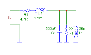

subwo1 said:
When the moving mass of the cone is coupled to the voice coil, the result is an AC generator. How much this active power input to the amplifier's output terminal differs from the nominal inductive phase shift of the voice coil depends on the speaker.
The explanation hereabove is often used in the DIY community. In fact the electrodynamic speaker can be described by the attached schematics. R2 a L2 are the resistance and the inductance of the voice coil in the "braked" state (not moving). R1, L1 and C1 are the components calculated from mechanical side of the speaker to the electrical one. They describe the resonance effect of the speaker. The component values will differ according to the real speaker.
