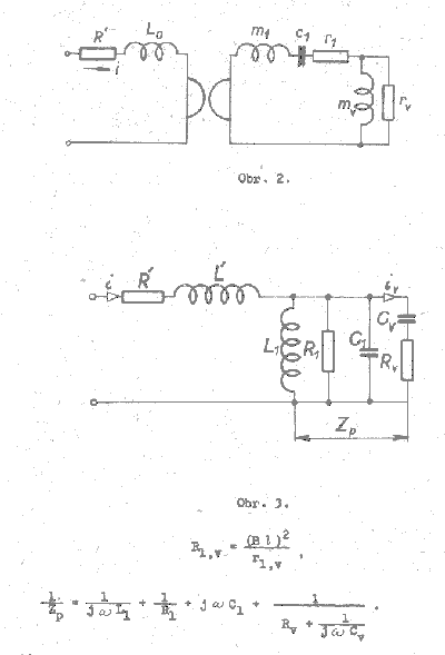

The explanation hereabove is often used in the DIY community. In fact the electrodynamic speaker can be described by the attached schematics. R2 a L2 are the resistance and the inductance of the voice coil in the "braked" state (not moving). R1, L1 and C1 are the components calculated from mechanical side of the speaker to the electrical one. They describe the resonance effect of the speaker. The component values will differ according to the real speaker.
Exactly.
And you don't hear people referring to capacitors or inductors as "AC generators."
The cone's mass and its compliance are energy storage mechanisms just as inductors and capacitors are. And in fact the cone's mass and compliance have their electrical analogues in inductance and capacitance respectively, which is why dynamic loudspeaker drivers are modeled electrically using R, L and C elements.

That is because they aren't, but a speaker nonetheless is. The model which approximates the real thing is interesting, though.
that's the TS model that I referred to in the original thread. Nobody including Graham picked it up, tho, 🙂
yeah, if you write out the differential equiations describing the electro-mechanical movements of a real speaker, you get the same differential equations describing that RLC network presented by TS.
so as far as the amp is concerned, the rlc network and its equivalent speaker are one and the same.

How is it exactly that a speaker is an AC generator but an inductor isn't?
An inductor is passive and is only able to store energy in a magnetic field (normally temporary). A speaker is a mechanical system which can actively convert the mechanical energy of a moving voice coil into electricity as the coil cuts through the lines of magnetic force (from a permanent magnet) during this physical motion. When the speaker is producing a sound, it is a motor, when it is moving in response to sound or simply pushed with fingers, say, it is a generator. The modeling with passive components is good in the standard use of the speaker, when driven by an amplifier, and that is what we care about here. 😉
Last I looked, loudspeaker drivers were passive as well. And they also store energy.
Actively convert? What's the active element in a loudspeaker driver?
When the speaker is producing a sound, it is a motor...
How does calling it a motor change its fundamental electrical behavior?
...when it is moving in response to sound or simply pushed with fingers, say, it is a generator.
But we're not talking about it moving in response to sound or being pushed with fingers. We're talking about it being driven by an amplifier.
But if you want to look at it in that context, then would you also call an inductor which is being impinged upon by a time varying magnetic field a "generator" as well?
Sure. So if we're talking about it being driven by an amplifier, then where does the "AC generator" come into it?

OK. Here is the more complex model, acoustical side included. But nothing is changed from the point of view of the amplifier.
Oh no. The resonant circuit in the speaker electric diagram is really the what you are speaking about (exchange of the energy).
