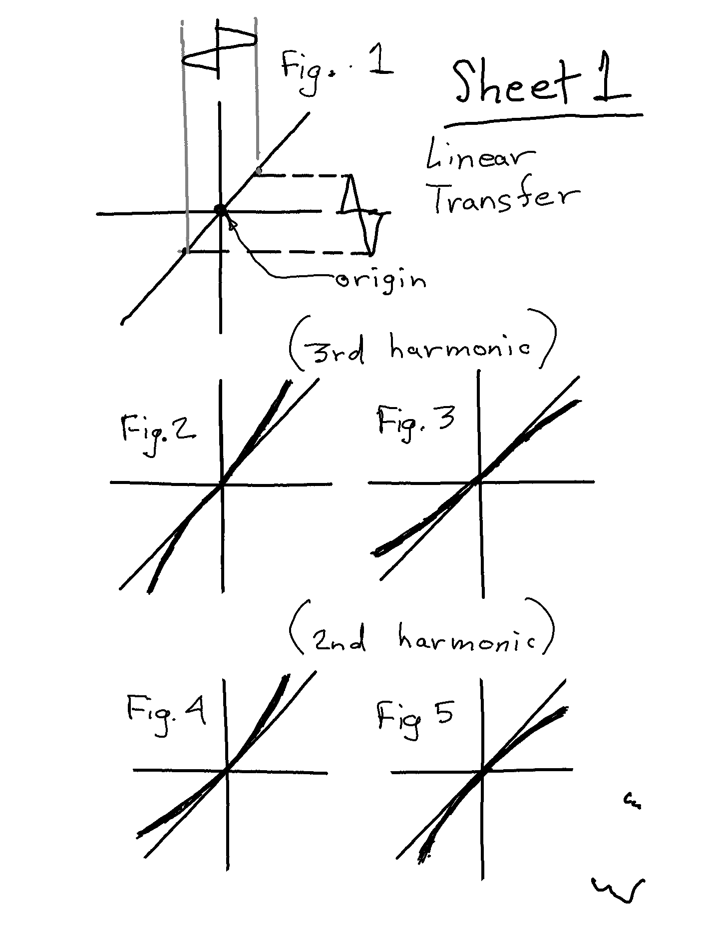

Non-linear transfer functions can take one of four basic types. These are shown in Sheet 1.
Figure 2- expansion up and down (generates 3rd harmonic)
Figure 3 - compression up and down (generates 3rd harmonic)
Figure 4 - expansion up, compression down (2nd harmonic)
Figure 5 - compression up, expansion down (2nd harmonic)
Sheet 2 shows the distortion waveforms resulting from an input sine impacted by the corresponding non-linear curves in Sheet 1. In all cases the isolated distortion waveform passes horizontally through the origin. If the input stimulus is considered to be made up of an infinite number of points with infinitely small time intervals the slope of the linear and curved transfer functions match each other in the interval between t0 (time 0) to t1 (the next time increment). Once the slope of the non-linear and linear transfer functions match there is no distortion, hence the distortion component alone must begin having zero slope or passing horizontally through the origin from t0 to t1. This also occurs for every half cycle.
The distortion waveforms show that the position of these waveform is not arbitrarily located, rather always smoothly (horizontally) connected between any sine stimulus regardless of being a half cycle, first cycle, last cycle, or any other cycle. Given a perfect amplifying device that is only affected by a non-linear transfer function there is no vessel of memory from any one point to the next point, regardless of being infinitely small. Hence for memory type distortion to occur requires a vessel to hold electrons and that the change in charge and discharge is disproportionate to the input stimulus.

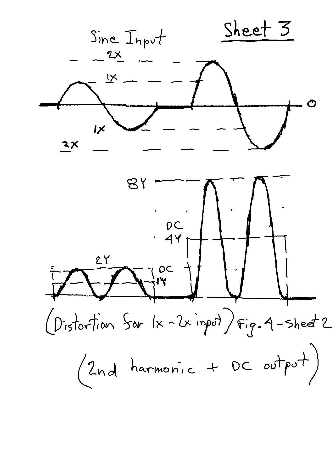

Figure 1 on Sheet 3 shows two sine inputs at 1x and 2x separated by 0x. For the transfer functions depicted in Figure 4 on Sheet 1, the 2nd harmonic changes exponentially at a 4x rate to that of an input sine changing at a 2x rate. Given the single sided nature of the distortion waveform the 2nd harmonic can be observed as reflecting a DC component changing proportionately with the 2nd harmonic, yet exponentially to the input stimulus. Hence this form of transfer function generates a non-linear DC spectrum component under circumstances of a changing input amplitude.

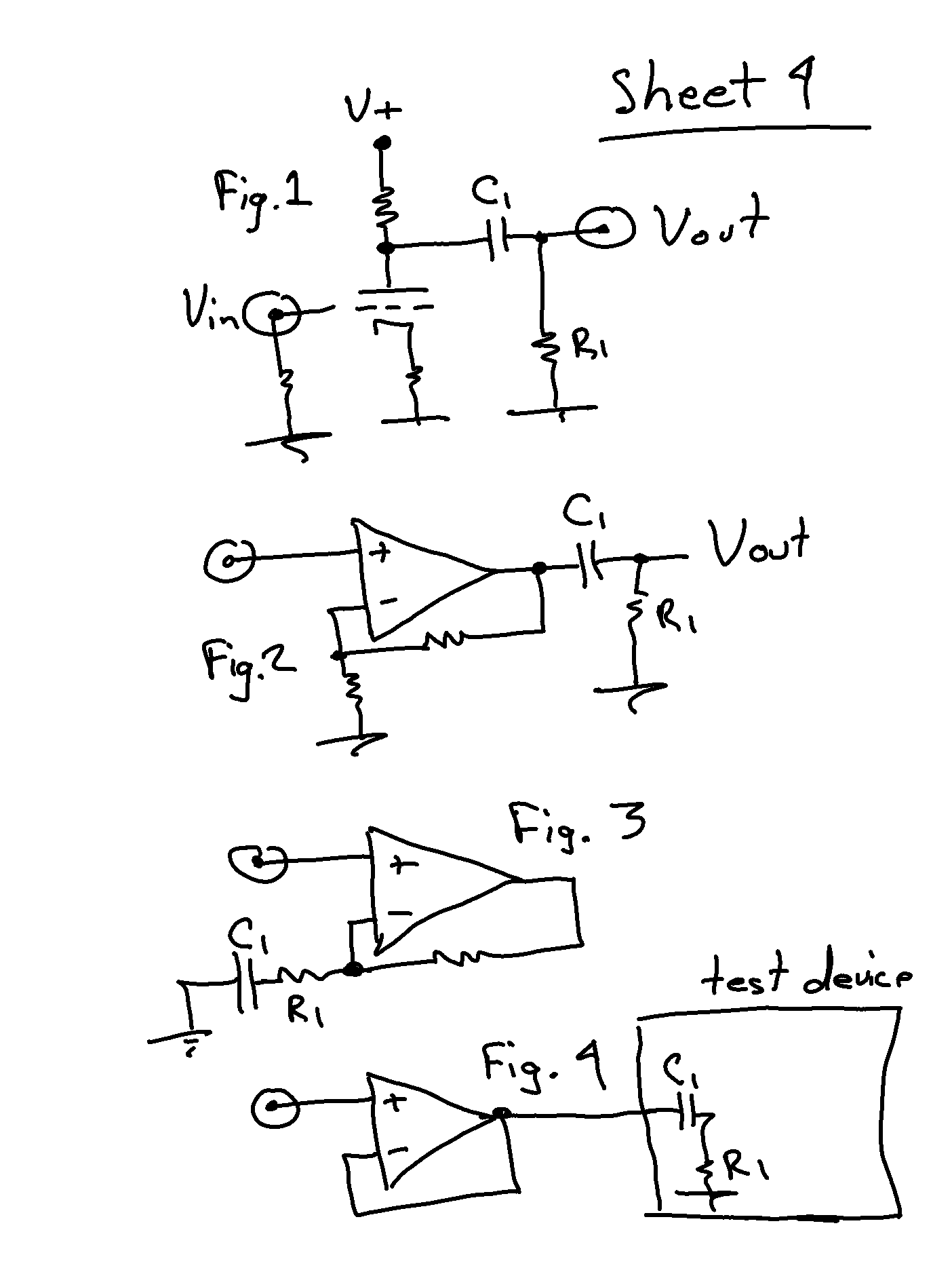

For “first cycle” or “memory type distortion” to exist requires that a vessel exists to contain electrons, and that such vessel charges and discharges those electrons in a non-linear way. Capacitor C1 in figures 1 through 4 on Sheet 4 is a vessel that can cause such memory distortion if the transfer functions of the amplifying devices take the form producing 2nd harmonics. In all cases both linear and non-linear DC components accumulate across capacitor C1. It should be noted that memory type distortion occurs for every level change of sine input, not just from zero input to the first cycle, and that this distortion is affected by the R1/C1 time constant being of variant affect by frequency and amplitude changes of the sine input. For this reason the phenomenon is considered an artifact of modulation that by any other name is still that.

To your post. Well reasoned, and the overview is valuable. What I have trouble with is your use of memory distortion. It is not clear to me what that actually is. Of course capacitors can take up charge and give it out at a later point, but that is normally called phase shift.
I remember the discussions on memory distortion at the end of last century, especially by Mr. Hiraga and his disciples at L'Audiophile. If I understood that correctly it was more along the lines that the operating conditions of a circuit are modified by a (strong) signal, and that subsequently the signal is processed at a different operating point than before. The circuit sort of remembers what had gone on before, hence the term memory distortion.
But that is not what you mean, isn't it?

Thanks Jan,
To your point the term “memory distortion” is considered incorrect, rather that it is better described as “distortion memory”, whereupon capacitor C1 “memorizes” the non-linear DC distortion component un-knowingly imposed upon it as following normal R/C conditions. This includes phase shift.
My intent was to indicate that the degree of charge on C1 for any fixed input level reflects both proportionate (normal DC gain) and disproportionate (exponential) DC values that result from a non-linear transfer. The extent that distortion is completely “memorized” could be considered occurring over 5 time constants of R1/C1 taking place for any step change of input sine being held in the repetition to complete that memorization. In other words the “first cycle”, as beginning from an off condition, is only a special case. The other factor is that the R/C time constant involved as memorizing the distortion is not directly related to the frequency of the “first cycle”. This is to conclude that although using a “first cycle” stimulus can reveal distortion artifacts it does not follow that the first cycle is unique in causing such revelation, this as opposed to using conventional methods such as modulation.

To “reconcile” suggests of a requirement for someone (perhaps me... no offence by the way) to justify its importance under the circumstances presented. I was once asked if this is important. My response was that it wasn’t for me to prove its importance, rather for others to prove that psycho-acoustic phenomenon concluded as being a function of the sole existence of 2nd and 3rd harmonic was not influenced by other spectral components proven to be inextricably connected.
Consider a single ended tube amplifier depicted on Sheet 4. This is known to generate 2nd harmonic. A classic claim is that amplifiers producing 2nd harmonic are more pleasant than amplifiers producing 3rd. My argument is that when the input signal becomes one of a musical waveform the non-linear DC component no longer remains a DC component, rather it becomes a modulation frequency component below the "fundamental" that created it, hence generating more lower frequency content than frequencies causing it. In other words artificial lower frequencies are being generated by the modulation of higher frequencies. This can result in greater weight to a bass guitar or a triangle.
