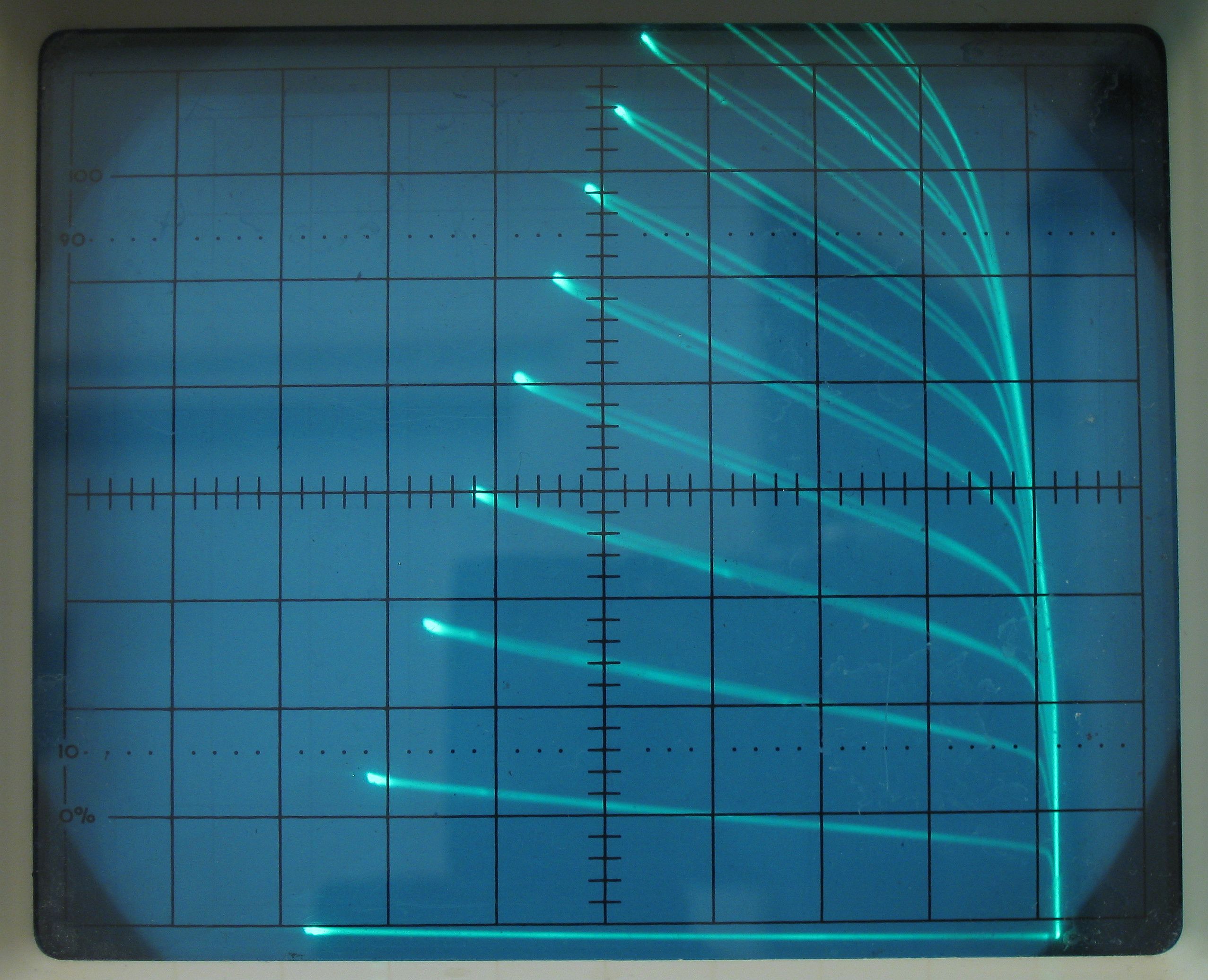

Agree. I did not question the existence of IMD or TID [or rather TIM (?)]. I have measured IMD myself many times.TID and IMD are types of distortion. They exist, whether you measure them or not.
Disagree. Not just the distortion, the non-linearity causing it is changing by changing of TBE, VCE etc... These easily changing on the order of milliseconds for a transistor like the BC550 as shown on the left photo here: https://www.diyaudio.com/forums/solid-state/5928-comments-thermal-distortion-2.html#post6339797You may use sines or square waves or anything to measure, but the distortion does not change, because it is caused by the nonlinearity of the amplifier or whatever device you are discussing.
(The one on the right has a much lower thermal cut-off frequency) You can see loops there on the left because thermal distortion is not time-invariant. Please note: VCE, IB, are the same during up part and the down part of the individual thermal 'loops'.
Disagree. That underlying non-linearity is not a fixed non-linearity. It's changing as the audio signal changing because it's linked to bias conditions. The bias conditions are not time invariant because of the nature of memory type distortions like thermal distortion. So the non-linearity is not time-invariant. It is easy to see by understanding the exponential characteristic of thermal changes. It also has an effect after excitation, not just during excitation.By measuring in different ways you get a different manifestation of that underlying non-linearity.

...like the BC550 as shown on the left photo here...
I don't see any photo on the page that link takes me to. What post # are you trying to link to? Direct links only work correctly if everyone has the same number for the posts-per-page forum display setting, which not everybody does.

I didn't really understand the second sentence. I think even in one sine cycle especially for lower frequencies the positive and negative excursions pull back and forth the bias point a little because of thermal variations like on my OnSemi BC550 curve tracer photo: https://www.diyaudio.com/forums/att...-comments-thermal-distortion-bc560c-semi_-jpg
On the photo, VCE varies with the absolute value of a 50Hz sine. So each loop starting from the bottom left corner is a half sine along the horizontal axis. Each loop up and down is 5ms. The BC550 clearly easily tracks the self-dissipation induced thermal variations. VCE varies and so does the current gain. (The vertical axis is IC).
Krisztian
Looping can also be caused by junction capacitance - or possibly probe capacitance.
And a 50Hz cycle loop would be 10ms?
As I wrote: VCE varies with the absolute value of a 50Hz sine. So yes a half sine cycle of 50Hz is 10ms hence 5+5ms for a loop up and down. You have 100 half sine cycle in a second when its frequency is 50Hz.
