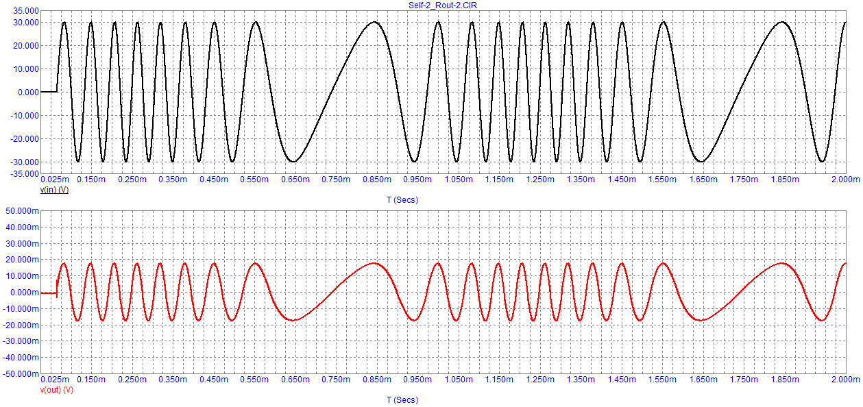

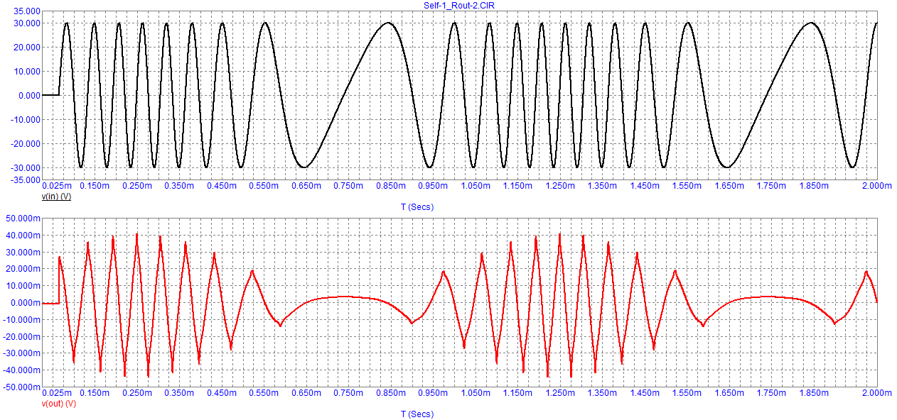

Hopefully it is not necessary to explain that the output impedance of the amplifier is connected in series with the load and affects the distortion on the load.
As you can see, there is no first period that so annoys many
Here is the behavior of the output impedance of two amplifier options when testing it from the output side:
original scheme of Douglas Self and modified version by Graham (see above)
You do the interpretation of the results yourself, because I misinterpret in the opinion of some colleagues
Second picture puts green area around 2nd cycle but claims its how the first looks. Please be more stringent. I don't get it.
I repeat again: the program measures THD only for one specified period. I use microcap, download the user manual and study.
To measure distortions on the 10th period, it is enough to indicate the number of periods of the generator 10. Then the program generates 10 periods and multiplies the 10th period for rendering using the Fourier transform. The program works the same way with the first period, turning it into a periodic signal
arrows, I showed the directions of adding periods to turn the signal into a periodic

So 30volts input to an amp, and 30mv out? What else have you fudged? The output looks like its slewing, probably input overload. Ild love to see what D Self would say.

What does he really do? It sends a signal with an amplitude of 30V to the output of the amplifier and tries to show us something, and does not say what signal it gave and for what purpose. The layout of the axes is such that it is very difficult to calculate manually. I get the feeling that he doesn't know which end of the amplifier is being listened to.😕
