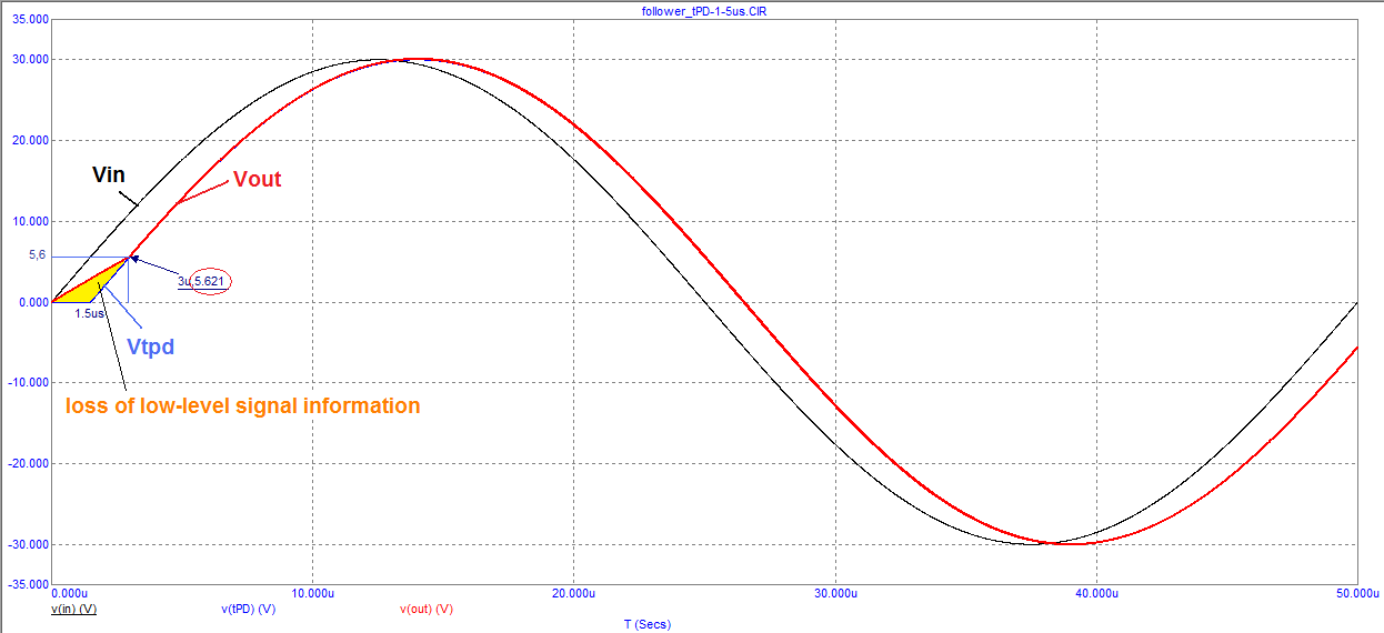

In your opinion, what is highlighted in yellow I created myself
This seems to mirror what Maynard described as FCD and looks like it came from a simulation most likely due to him.
I have never seen the aberration depicted in your image for sine wave input - whether from the input signal generator or the output for any circuit anyone has simulated in LT SPICE.
It is time you stopped crusading for a lost cause.
If one is looking for transient response it is better to use a square wave and work out the frequency from the inverse result for rise time.

Let's simulate an ideal transient-free follower with a signal propagation delay of 1.5 μs and see the output signal (red). The input voltage is shown with black line, blue line shows the input voltage delayed by 1.5 μs.

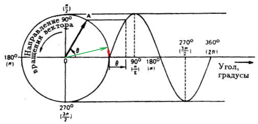

If the addition of vectors occurred according to the law of arithmetic 2 + 2 = 4, then no distortion of the output voltage would occur. It would simply be shifted by the delay time, if there were only vector distortions which, in steady state, do not affect the distortion.
But since these are vectors, as a result of the addition of vectors, distortions proportional to the delay time arise in the initial section. I hope everything is clear from the presented figures. With a delay of 1.5 μs, the real time of the introduced distortion is 2 times longer, and the amplitude reaches 5.6 Volts at a voltage of 30 Volts, which is 19% as a percentage !!!
I hope there is no need to explain that the less the signal transmission delay is, the less distortion will be introduced.
In fact, the problem is not even in the level of introduced distortion; in acoustic systems, the distortion is much higher compared to the distortion of amplifiers in the steady state. The worst thing in this business is the loss of micro-level information that makes music alive.
Imagine that a large orchestra is playing and at some moments the higher harmonics collapse and their total slew rate reaches the slew rate of the initial section of the signal shown. This harmonic, even if its amplitude reaches 6 V, will simply be smeared for up to 3 μs, ignored by the amplifier.
This is my last attempt to show what is called "on the fingers" how NFB really works in amplifiers. If this time the pundits do not understand, then I am powerless to help you with anything ... Well, whoever understands what I am talking about, he, I hope, received a useful lesson for the future "how not to do"

No problem with your recommendations on how to improve things. The problem lies with your use of FCD (which you do not even know how to measure nor correctly interpret) as a valid parameter to characterize quality of an amplifier.Guerilla, none of those who have approached me with a request to help cure a vintage amplifier have complained that they wasted their time on improving the amplifier according to my recommendations...
Find me a microphone that fast, let alone a commonly used audio recording media.Imagine that a large orchestra is playing and at some moments the higher harmonics collapse and their total slew rate reaches the slew rate of the initial section of the signal shown. This harmonic, even if its amplitude reaches 6 V, will simply be smeared for up to 3 μs, ignored by the amplifier.
...Imagine that a large orchestra is playing and at some moments the higher harmonics collapse and their total slew rate reaches the slew rate of the initial section of the signal shown. This harmonic, even if its amplitude reaches 6 V, will simply be smeared for up to 3 μs, ignored by the amplifier.
Please just explain what happens in the next cycle. Do the implied error also occur, in the same way, here or is only within the first (360 deg) cycle?

Good luck He needs to abandon his simulated fantasy and face reality for that to happen.
Hypothetical input and output signal of a virtual amplifier. Does not sound good in a simulated listening test.
Agreed. A completely artificial construct, which has no bearing to the physical universe.

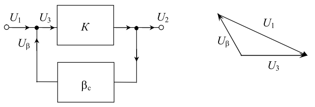

On a sinusoidal signal in a steady state (as we usually measure with Audioprecision), we will not see anything, since we measure the average distortion, say, at the 1000th and further period.Please just explain what happens in the next cycle. Do the implied error also occur, in the same way, here or is only within the first (360 deg) cycle?
But the music signal is not a sinusoid, it is constantly changing and OOS is constantly trying to pull up the output signal to the original with a signal propagation delay. The less this delay is, the more accurate the signal amplification will be. It was not for nothing that I brought the work of the filter on switched capacitors, which perfectly fulfills its function on stationary signals, but as soon as a multi-tone signal arrives, its work deteriorates 1000 times. So it is here.
Well, what would you expect if you make better compensation and even sometimes increase the depth of feedback? Should deterioration have occurred? ))Guerilla, none of those who have approached me with a request to help cure a vintage amplifier have complained that they wasted their time on improving the amplifier according to my recommendations. I only get thanks ... So keep your sarcasm to yourself.
Here only this initial moment of time is present only at inclusion (the beginning of the analysis) and at an overload on a differential input signal. But these are not the working modes of the amplifier and no one listens to music in them.Let's simulate an ideal transient-free follower with a signal propagation delay of 1.5 μs and see the output signal (red). The input voltage is shown with black line, blue line shows the input voltage delayed by 1.5 μs.

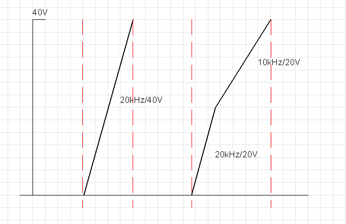

For my part, I will say that it is enough to take the maximum amplitude and frequency at the amplifier output in order to calculate the required SR at the output. Then divide by the amplifier gain and bring this parameter to the input. This will be an indicative SR input level.
Take 20kHz and 40V and SR = 5V / us, divide by 15 for about 2.82V input amplitude and get 0.34 V / us.
Let's compare with the results of Peter Baxandall. I don't remember exactly, but he seems to be giving something like 0.5 V / us as the maximum value he found. So now give your calculations as a counterargument.
On the other hand, if we sum up the slew rates of even two signals at the input (or output, without a difference), we must understand that we cannot simply take and add the maximum slew rates, since then this is adequate for exceeding the permissible output amplitude and the clip.
Example for 40V output amplitude acceptable. We summarize 20V at 20kHz and 20V at 5kHz (SR is 2.512 V / us and 0.628V / us, respectively) and in total is 3.14 V / us. As you can see, this is less than the above calculation for a single frequency of 20kHz and 40V. And so it will always be, until you enter the clip, exceeding 40V output voltage.
