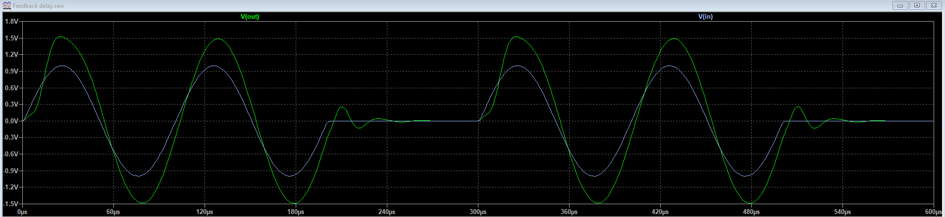

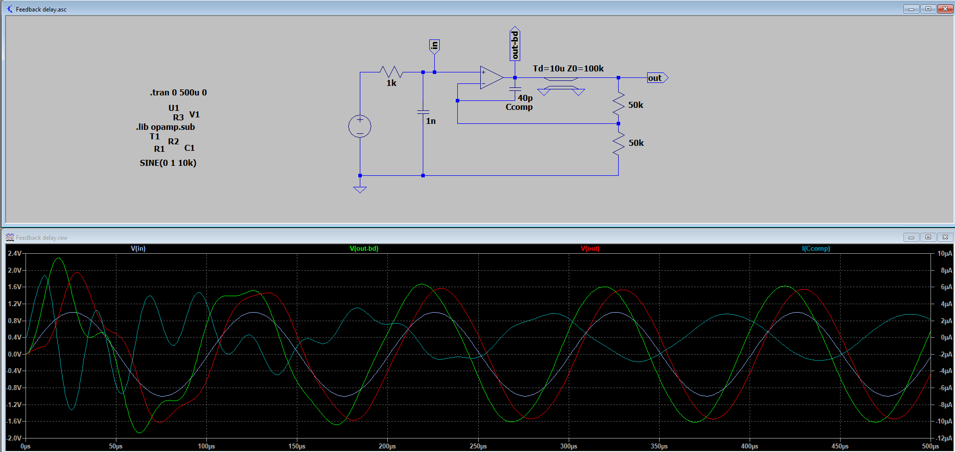

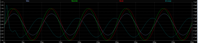

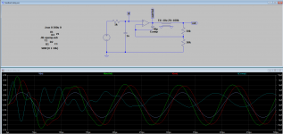

I played with LT to simulate this FB delay error and came to this.
I know the 10us is unreal I just simulated it out of curiuosity and as a magnifier of this theoretical case.
BTW I didn't found any advice on the net: soneone knows how to use a losless delay line in LT?
Elements in the layout:
  • 1k + 1n input RC filter
  • 40p compensation (otherwise it oscillates)
  • tline: 10us delay (100k impedance to match the FB load)
  • FB ratio = 1/2
Input signal:
  • f = 10kHz
  • A = 2Vpp
Ideal opamp:
  • Aol = 5
  • BBW = 50MHz
(False?) conclusions:
  • if the delay is significant, then after a "new" transient change the system distorts at the beginning and has to settle on the first few periods
But I'm sure I made some errors so feel free to correct this experiment. 😱

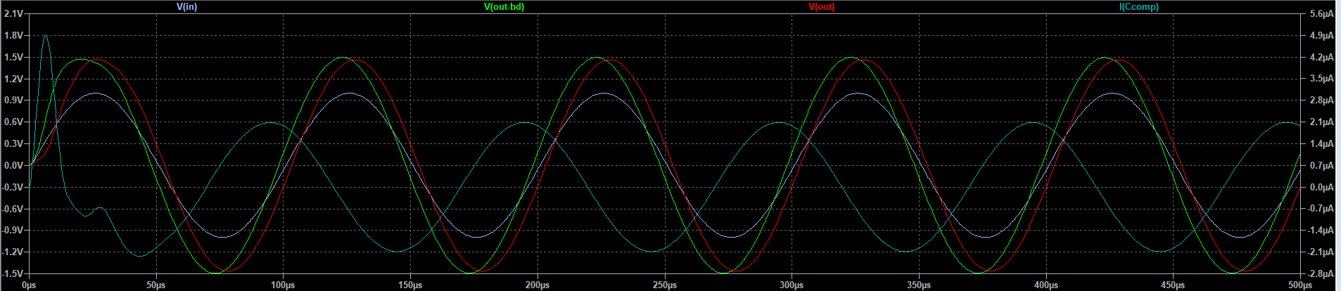

@Cortez
You can throw out the delay line, it's unnecessary. Change the parameters of the amplifier itself with a compensation capacitor - this will be enough. Petrov uses a delay line to compensate for the delay in the amplifier itself, so that the output signal can then be subtracted from the input signal at the appropriate scale. If you don't, you don't need a delay line.
Don't overload the graph with curves. For example, V(out-bd) can now be discarded) And the diagram above the graph is convenient, do not give up on this if possible.
By the way I'm starting to believe that there is some "middleway" about this starting phenomena between the 2 "counter-camp" stated untill now.
I mean of course it's unreal (in the audioband and in practice as well) that a signal starts from 0 with an infinite speed (step signal test).
But I guess the very same is exactly true when we deal with just perfectly continuous (amplitude, phase, frequency) sine waves "with history".
In my simulations a 10kHz sine was starting from zero but via a 1k-1n LP filter.
Would this also be a hugely unreal kind of starting transient signal which can't be present in music..? 😕
I (of course) completely admit that I/we don't know...
It's just a phenomena that may exists and maybe worth to consider.
But that's also true for almost every little effort we make to gain some new 0.000x% THD improvements.
And I guess everyone would come to peace if we'd say: yes, there is a FCD but...
  1. it's not that much (as the delay is never this big)
  2. even if it's there it doesn't have any impact on the sound and we don't hear it
... because the latter 2 can already be somewhat subjective which is out of debate as usual... 🙂
PS: wow, there is a LCD as well... a Last Cycle Distortion... 😀

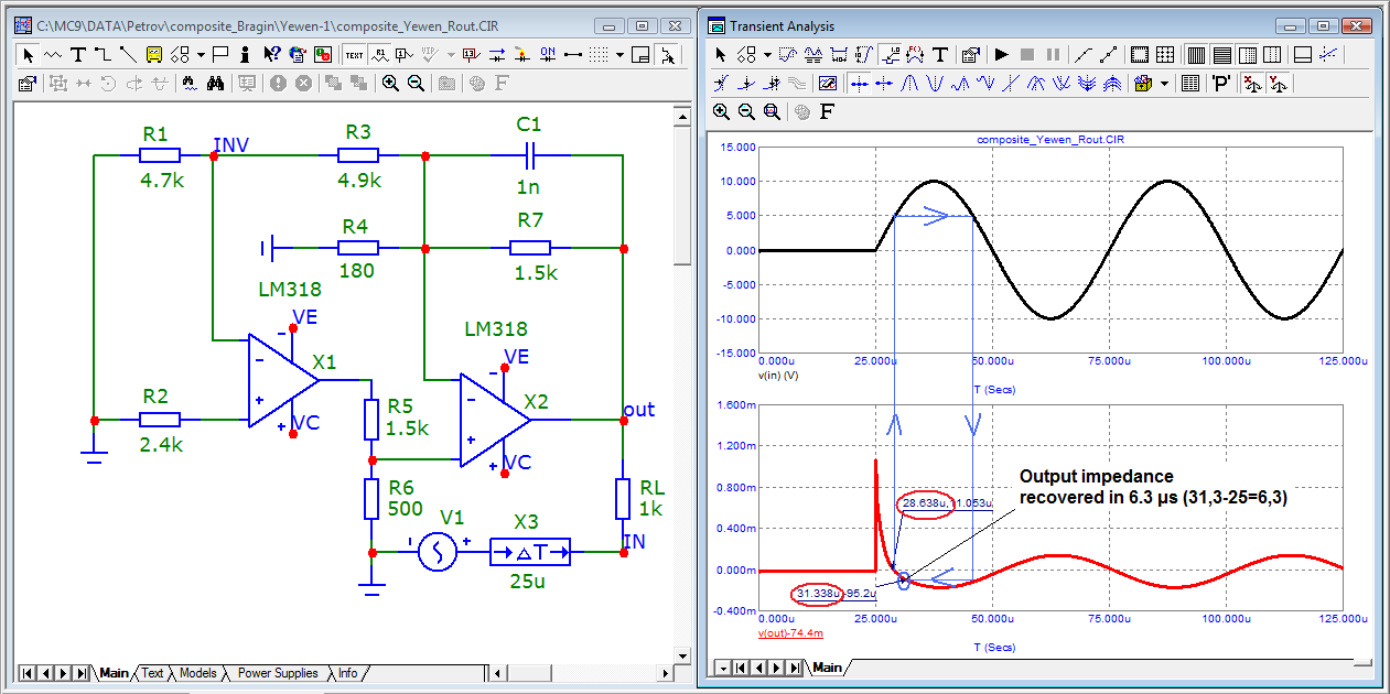

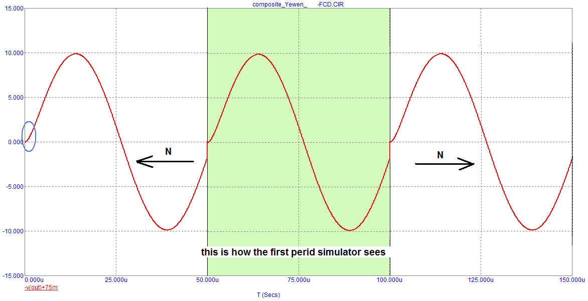

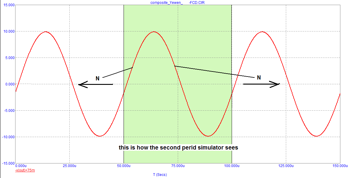

Why does the first period curve in the simulator? When the input signal is applied, the simulator does not know what it has at the output. It has made a preliminary calculation for direct current and then enters an alternating signal. Since the input signal has been received, but there is still nothing at the output, the differential voltage between the inverting and non-inverting outputs increases until the time required for the signal to appear at the output has passed. During this time, the amplifier is not in operating mode and it is impossible to judge its quality indicators and sound. This mode is similar to the experiment that Damir suggested earlier in the topic. This is a transitional process, nothing more.
This can happen in the middle of the simulation if we stimulate the input with a fast signal with a high slew rate in any form, explicit or implicit. It can be a square wave, it can be a sine burst (a sine modulated by a square signal).

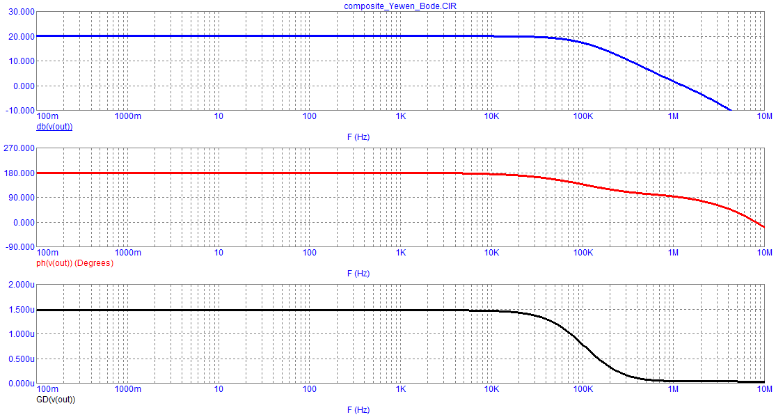

As an example, I deliberately took a DC amplifier to minimize transients.
The Bode diagram shows that the group delay is constant from fractions of a Hz to several kHz instead of the necessary 200 kHz to obtain negligible distortions.
The output voltage after external influence returns to normal state only after 6.3 μs. At the initial moment (when the external voltage is close to zero), the output resistance is maximum and is several times higher than the resistance in the steady state.
Here we go again. Petrov sent a step signal to the output of the amplifier, which the object will be able to compensate only after passing through the amplification stages to the output. But in normal operation, this does not happen. To produce a sharp surge of voltage, the speaker system must have a speed-appropriate mechanical stimulus. And there is a natural question-where did it come from and whether this is a normal mode? Do you use a wooden hammer to knock on the speaker membrane?

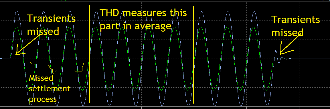

Ok I understand. I see it as just a "magnifier" tool not to forget about the aspect of the relevance of the group delay.
For example: someone says why to decrease it? Or why to bother with a better HF compensation?
Maybe then it could be a bit more illustrative if one would see its impact on the very first sinewave for example.
But I agree that it's a bit misleading when showing it with an ideal step response.
I also just "tuned" the delay to 5us for presentational reasons to magnify the effect what is there obviously.

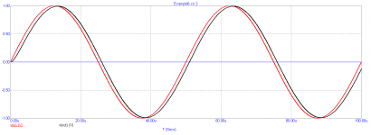

But please answer my specific question above - in the case the second cycle is also a sinus - what does the corresponding part that your show to be affected in the first cycle, look like. Answer this, please.
I have already shown, I am showing again

I guess this FCD idea isn't against the classical theory at all but it's rather on the topic how we measure the total/final distortion.
So it's max "against" using the THD method exclusively, because it doesn't measure
this begining and the ending part "just" the middle and also that in average.
So if we have any additional dynamic, transient distortion before or after that it will be missed.
(Or even in the middle if it's modulated somehow...)
This is what you show how the signal would look if you copy the pieces that fall into the time window of the analysis. But this is not the case in reality.
