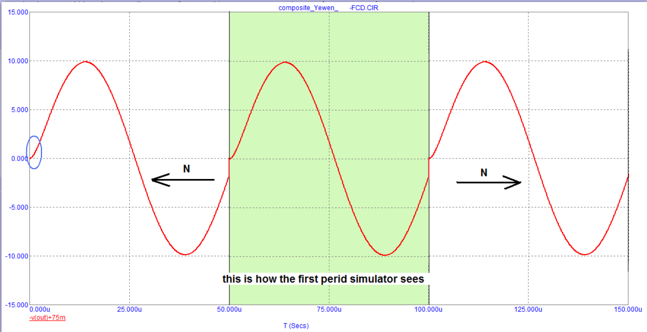

There are hues of color which are apparently identical but have quite different spectral composition. Yet, because the way the eye sees the colors we perceive them identical.
In the same manner there are sounds/tones which are perceived identical but in time domain (i.e. f(t)) can look very different.
Therefore audibility of the difference between the shape of input signal and the output can't be reliably judged based on time domain charts.
We listen by ears, not by watching osciloscope.
TNT, microap version 9 works the same for any period
So 30volts input to an amp, and 30mv out? What else have you fudged? The output looks like its slewing, probably input overload. Ild love to see what D Self would say.
seems to have clearly described the measurement process
I just tried to complement Graham's idea and show that the distortions of the first period are related to the group delay and its behavior in the frequency domain.

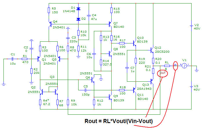

Petrov, let me summarize what I understand.
Since you show no interest in measurement of real amplifier, FCD is a virtual distortion number arising from a technique utilizing stepped sinewave input that you find useful in Microcap to indicate shortcoming in GBW, propagation delay, slew rate and probably a few others. I think it could be appreciated when posted in software forum because it should work for tubes, solid state and chip amps.
You have to understand that simulation result is at best an indication but never measurement. Common acceptance of FCD as indicator of quality of an amplifier do require that FCD brings something new not covered by established known parameters, real measurement of the amplifier, comprehensive interpretation and correlation to perception.
Hopefully it is not necessary to explain that the output impedance of the amplifier is connected in series with the load and affects the distortion on the load.
As you can see, there is no first period that so annoys many
Here is the behavior of the output impedance of two amplifier options when testing it from the output side:
original scheme of Douglas Self and modified version by Graham (see above)
You do the interpretation of the results yourself, because I misinterpret in the opinion of some colleagues

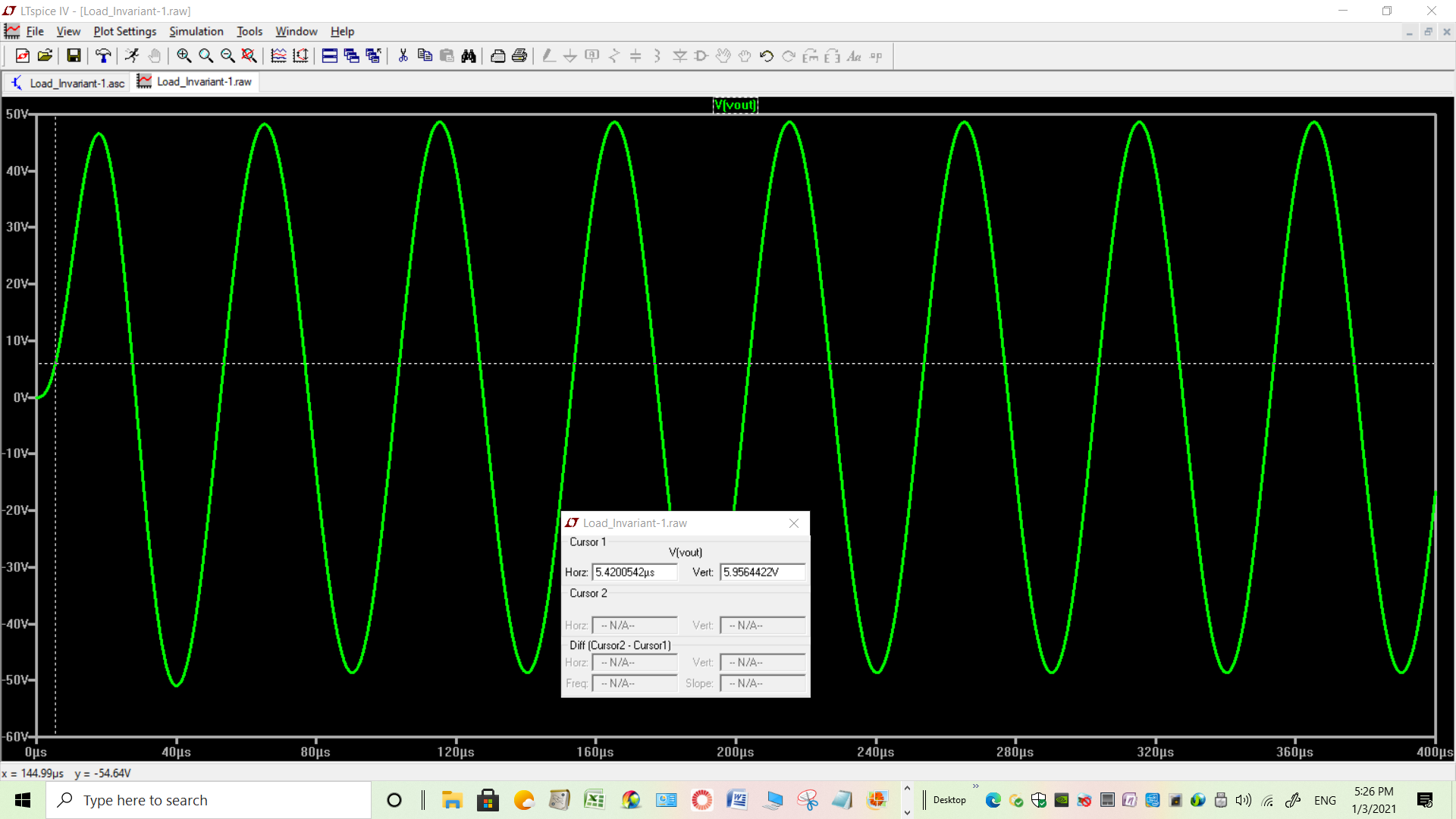

I have simulated a modified version of Self's Invariant Load Amplifier with sine wave and square wave input signals. Taking these in order I ran the a 20kHz signal input with a reactive load of 8R with 2uF in parallel.
The image attached confirms your observations - the period involved at start up being approximately 5us at a level of off around 7V.
If I run a 10kHz square wave test input for that same length of time the leading edge has no real deviation from vertical up to 14-15 V in term of frequency flattening off at 18V.
5us equates to 200kHz so there is a vast difference between the tests - so what is involved in each of these.
LT Spice allows 262144 sampling points so how much processing capacity is involved for each of the two tests.

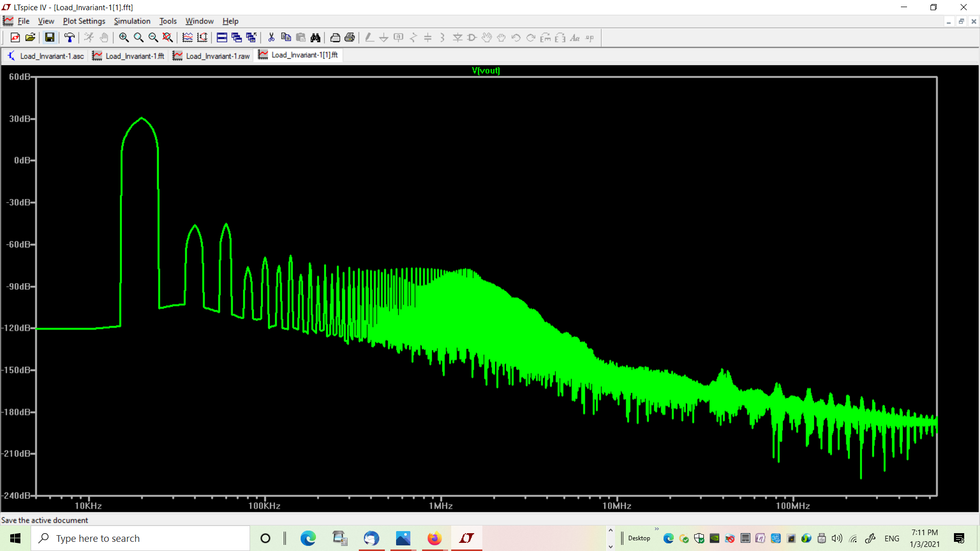

It is possible to get some idea with sine wave since FFT plots are a reconstruction of the sine wave sampling - so I have attached an image which looks like a lot of grass.
Looking at a square wave there would be far fewer vertical points to be sampled for rise and fall even allowing for some curvature at the top and bottom while the horizontal planes top and bottom would constant for most of the time.

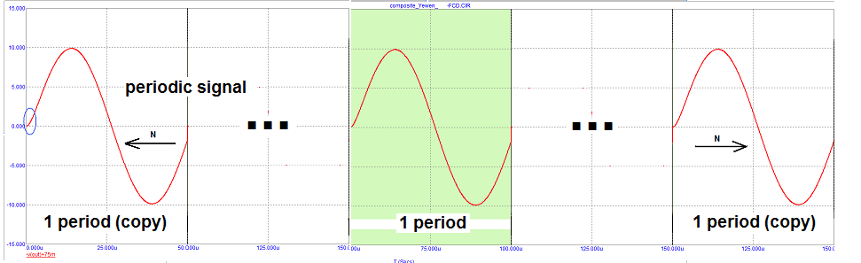

Here is a picture what I mean. Onset of the cycle train shows a "soft" start in first cycle - den nothing. So what is the problem for music listening here? Do please tell? Are you so in a hurry that you cant wait for the GD? Missing the train?
907573d1609659000-cycle-distortion-graham-self-invariant-20k-sine-png
This one for instance had me scratching my head. No idea what it is.
Petrov tried to show that the simulator analyzes the first period captured in the time window, so he manually glued several first periods in a row. In fact, only the first period is distorted there, and then the amplifier goes to the mode and visually nothing is noticeable.
Such a signal, as Petrov drew, can be obtained if there is a function gap between each period. But in this case, he was just trying to express his idea, which he did badly, I must admit.
Anyways - you show a first cycle with "distorsion" and then it goes away (?).

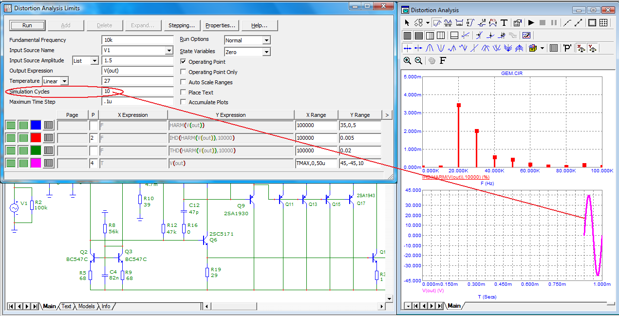

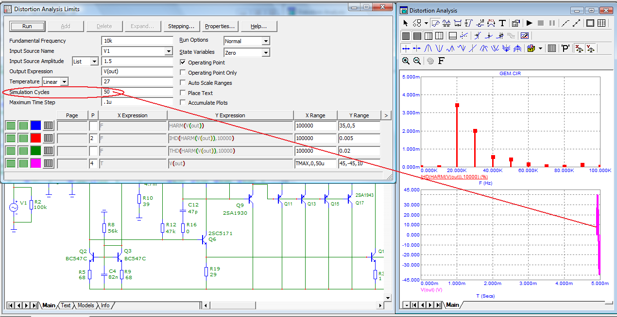

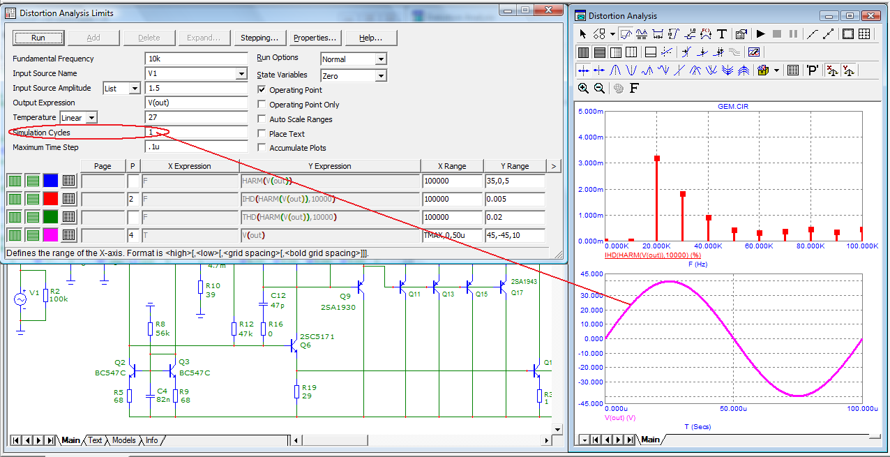

it feels like no one understands how the simulator works
In the settings window, set the number of periods for calculation
The program uses only one period for analysis - the last one, and makes a periodic signal from it for Fourier analysis
I hope so clear?
