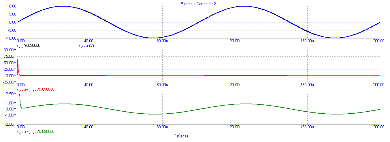

Ok. I hurried. I didn't take into account that your operational amplifier starts to reduce the gain. I used a perfect block and therefore my results are somewhat different, but this will not change the essence.I attached the opamp settings. I guess at 10khz it already starts to cut off in gain with such a Ccomp
value and that's what I "compensated" with this multiplier to get the same in/out amplitude.
I repeated your scheme and will show how it looks for me (taking into account the fact that the amplifier block is perfect of course).
On the first slide we see the scaled input and output signals merged at the top - they are equal in amplitude. The lower graph shows the difference between them.

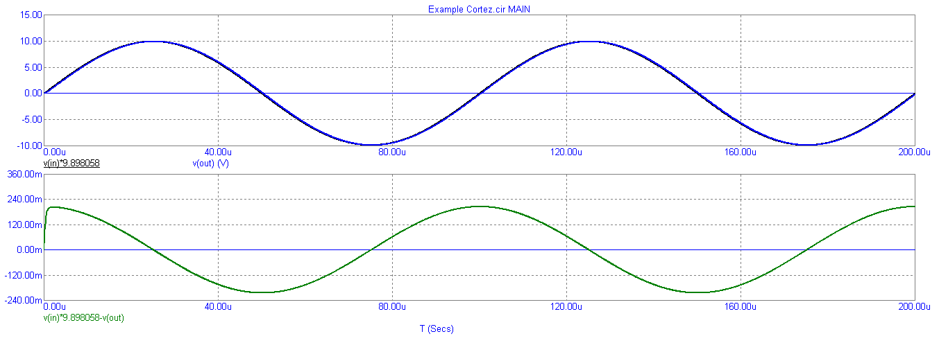

On the second slide, I compensated for the delay in the gain channel and did exactly the same subtraction. We get the difference between the input and output signals as it would look in the experience of Peter Baxandall. We see a spike at the beginning, and then everything becomes normal after the transition is over. The two lower graphs are the same, just a different scale. And there's nothing to worry about.

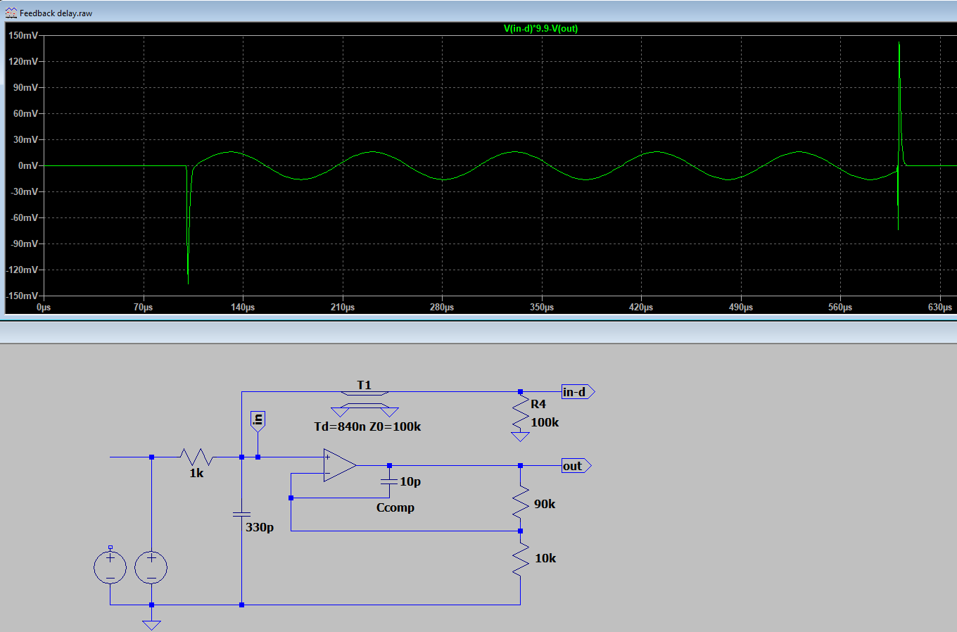

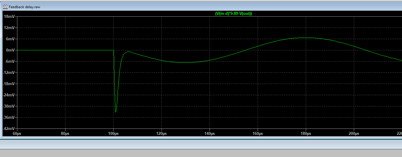

Thanks for your simulation! And have you used some real life input LP filter?We see a spike at the beginning, and then everything becomes normal after the transition is over.
BTW I guess there (could be) things to worry about as this happens on every new rising (transient starting) signal.
Therefore could you please show the "after life" section as well? What's the error there?

1st: that's the result if the delay is 840ns.Input filter: 1k + 330pF.Only if the transient was too fast.

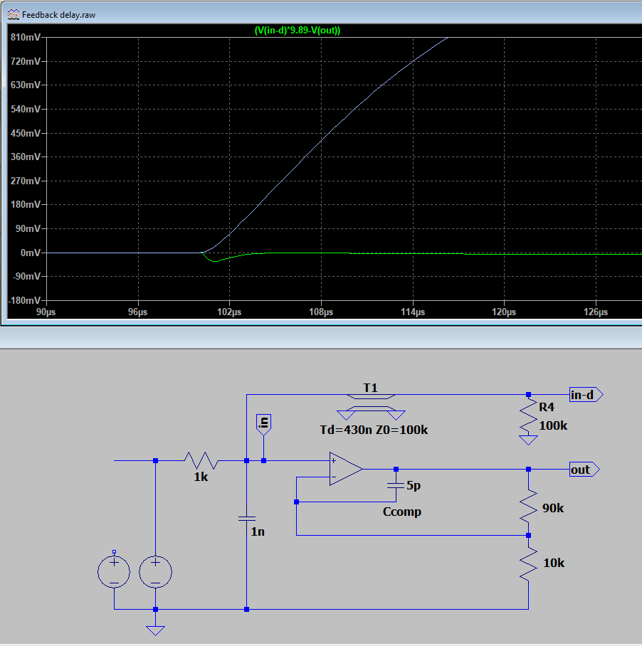

2nd: that's the error with 430ns with 1k + 1nF filter.
3rd: just the error of the 430ns case.
And of course there's also a similar error at the end if the signal stops quickly.
