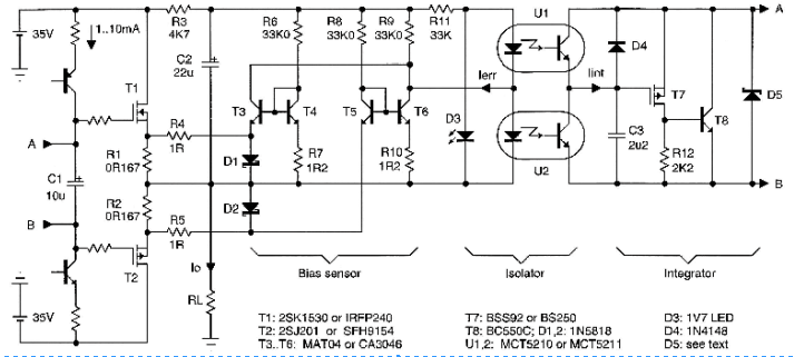

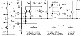

12 years ago I tried to implement this circuit in a serial amplifier. It was very tempting to exclude the operation of adjusting the quiescent current of the output stage.
Everything worked flawlessly. However, as soon as I got to the test for clipping at a frequency of 20 kHz within a few minutes, the circuit immediately refused to work. This test was required. If the amplifier could not stand it, the development did not go into production.
bimo, I gave the scheme with ten zeros after the decimal point and showed that it will work "dead"

syn08, kindly and tell me, have you made at least one amplifier in your life? If so, which one? What measurements did you take? What devices did you use?
If it's not difficult, share your work as Graham did, describing in detail the amplifier settings and the measurement results, and thereby leaving behind a good memory for those who understand this

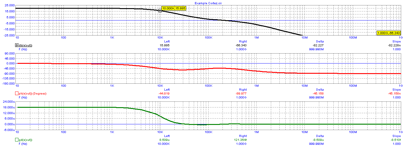

It turned out clearly. What personal conclusions were you able to draw from this simulation? In addition, look at the amplitude characteristic to understand where the frequency of 10 kHz is located on it, which you supplied - this is also an important point.1st: that's the result if the delay is 840ns.Input filter: 1k + 330pF.
2nd: that's the error with 430ns with 1k + 1nF filter.
3rd: just the error of the 430ns case.
And of course there's also a similar error at the end if the signal stops quickly.
P.S. I posted the wrong graphs earlier because I forgot to install a 220pF capacitor around the op amp. So do not pay attention to them, everything turned out to be not so pronounced because of this.
