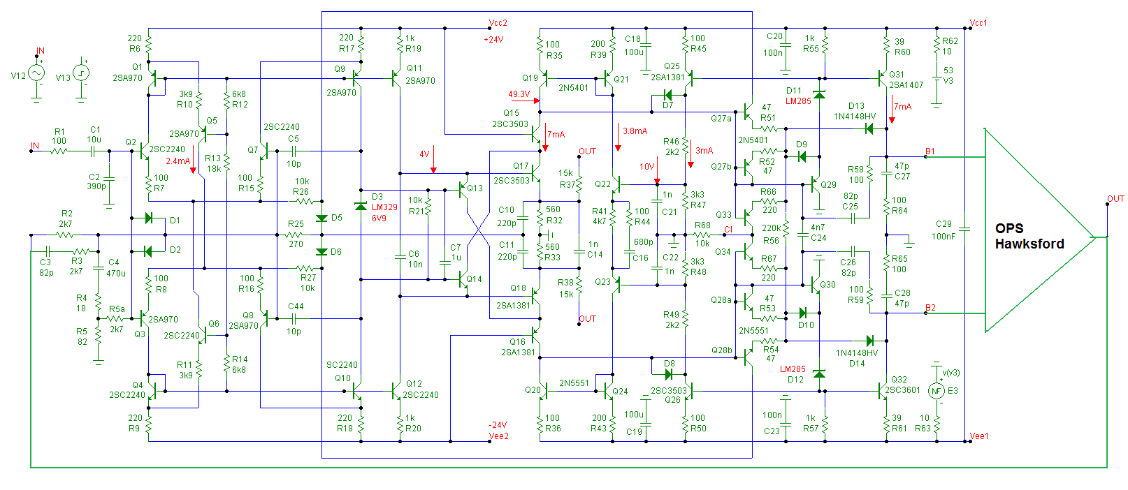

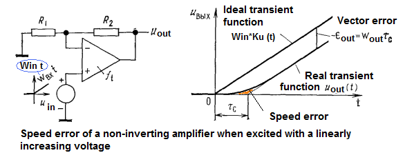

sin08, did I draw the block diagram of your amplifier correctly?
I have two requests for you:
1. Please show the delay graph or delay of any kind of signal (sine, square, triangular) with a frequency higher than 10 kHz at the output of this amplifier in relation to the input signal
2. Show the graph of the loop gain
p.s. I'm just too lazy to type a model of a complete circuit to check these parameters
