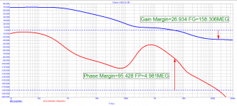

sin08, did I draw the block diagram of your amplifier correctly?
I have two requests for you:
1. Please show the delay graph or delay of any kind of signal (sine, square, triangular) with a frequency higher than 10 kHz at the output of this amplifier in relation to the input signal
2. Show the graph of the loop gain
p.s. I'm just too lazy to type a model of a complete circuit to check these parameters

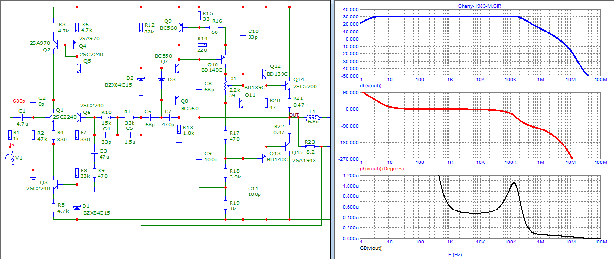

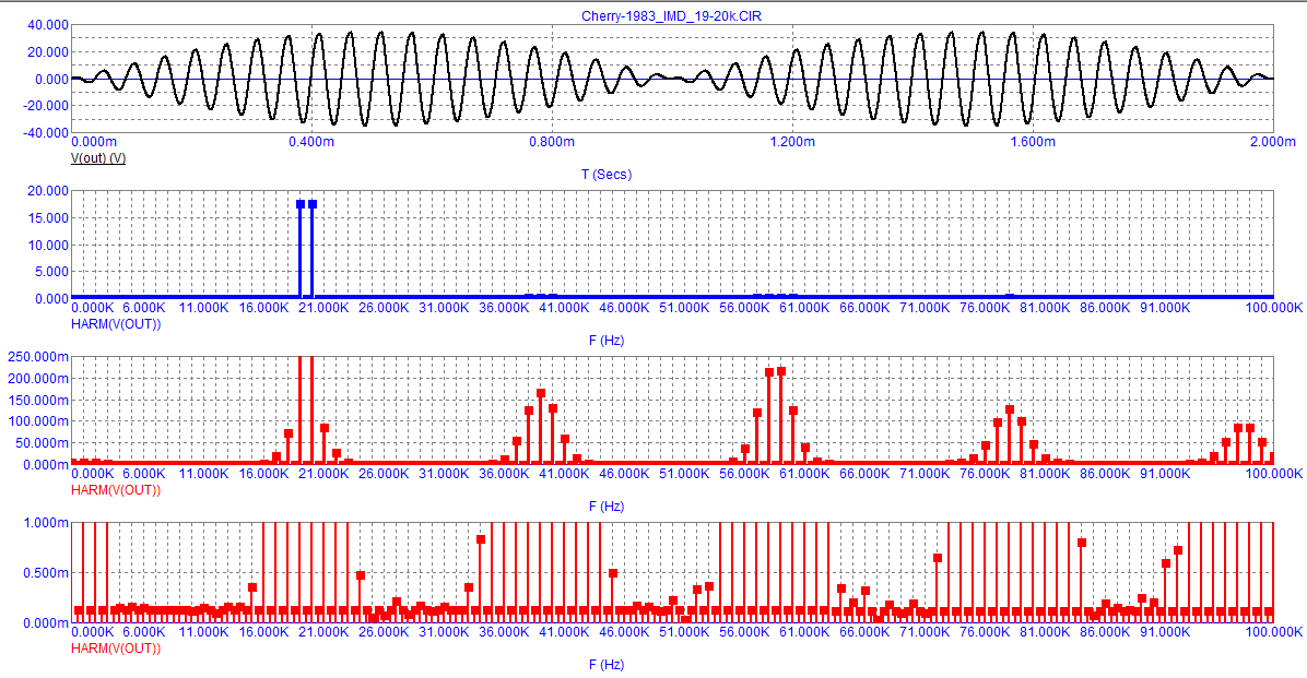

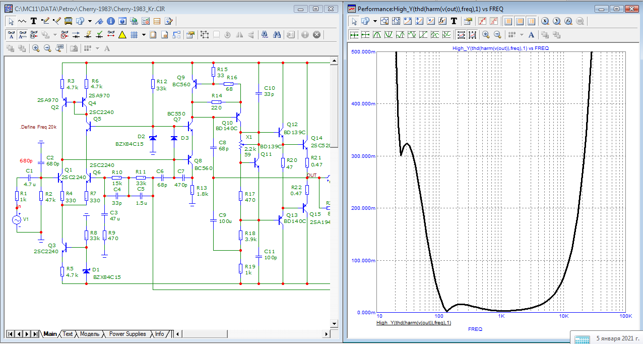

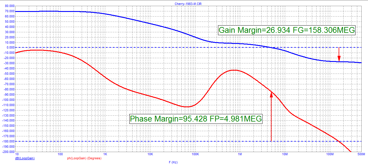

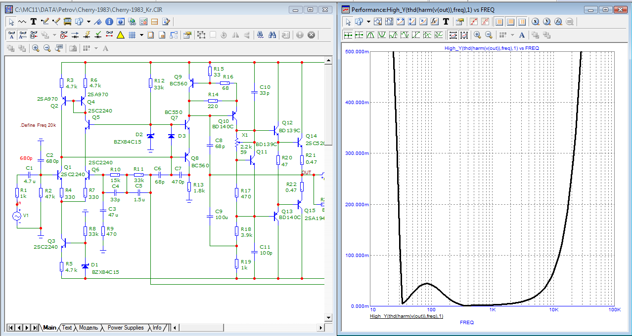

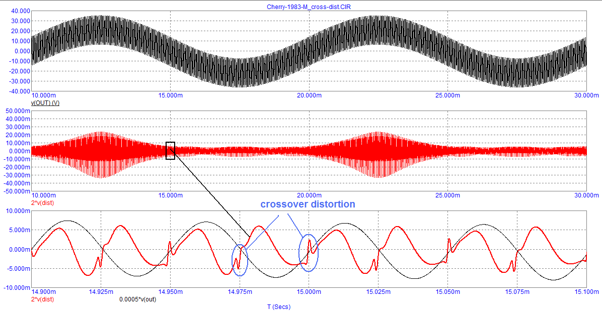

syn08, it would be enough for me to look at the GD of your amplifier to predict how it will sound. Instead of your circuit, I typed the circuit of the prototype - Cherry amplifier. Here are the results of his testing. It’s not surprising to me that this amplifier received such a response.
New Cherry NDFL amp
«But I also have to say that the amplifier sounds typically 1 dimensional solid state, with no real space to the image and that Hugh Deans latest creation, with 100 X more THD1 distortion sounds much better. So I have to put this technique alongside the other excellent academic articles I have read and participated in. Excellent in theory, measures well in practice (as far as my modest test capability allows) but does not live up to the expectation audibly.
As an engineer this is disappointing, but based on recent experience, not entirely unexpected!
I am fast going down the road of the minimum number of components the better and ironically this seems to work equally well for the ear and the pocket!»
Good for you, but I'm not buying.

He can tell how an amplifier will sound based only on its group delay?
That's a new one to me.
