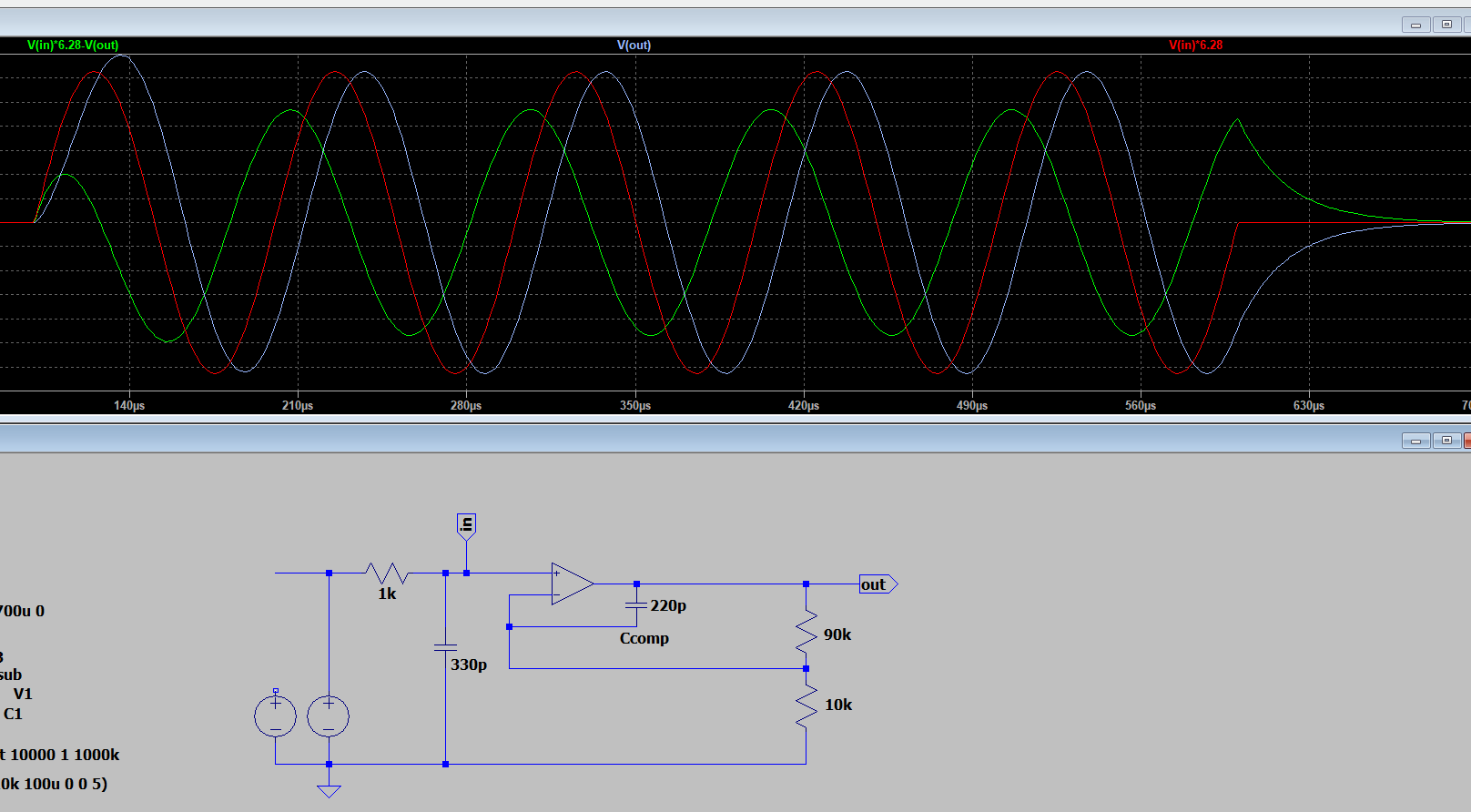

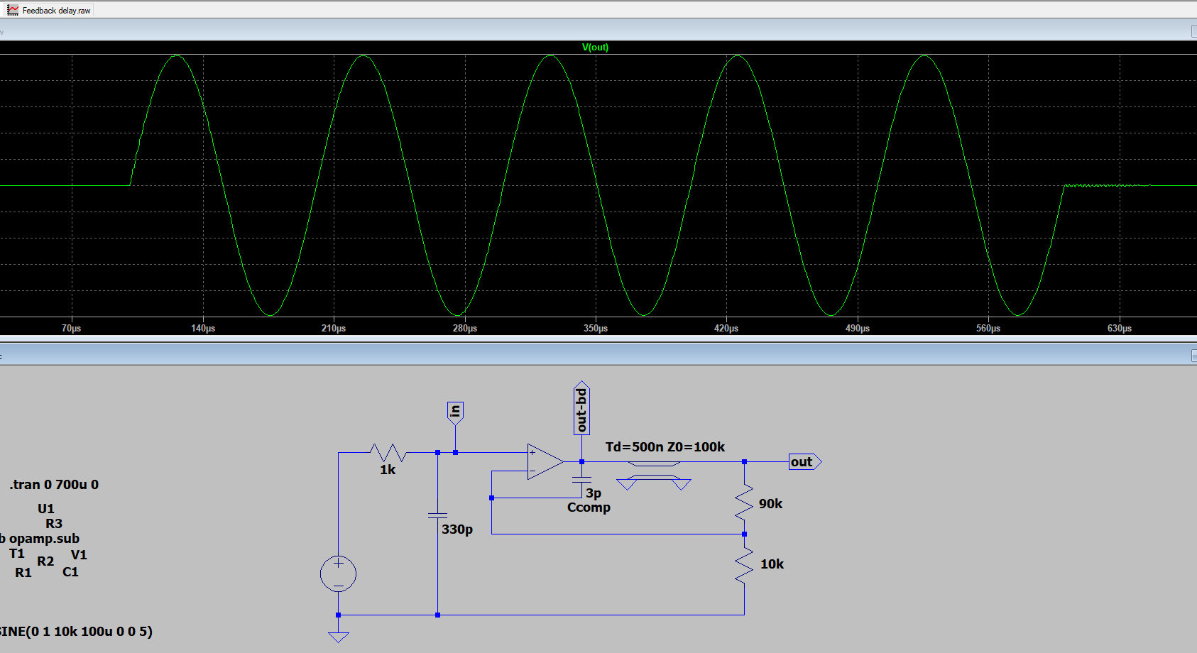

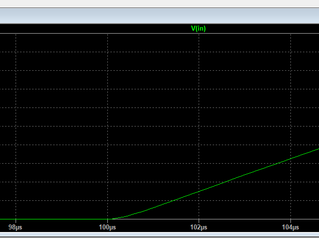

I guess it's working with finite starting sine waves as well. (If the delay is quite high.)
Or am I doing something wrong in my simulation?
Input filter = 1k + 330p.
Signal = 10kHz sine
Aol = 1k
PD = 500n

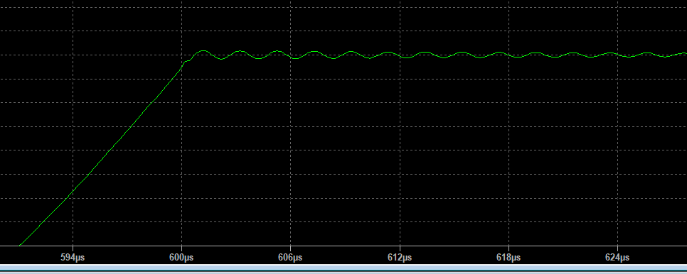

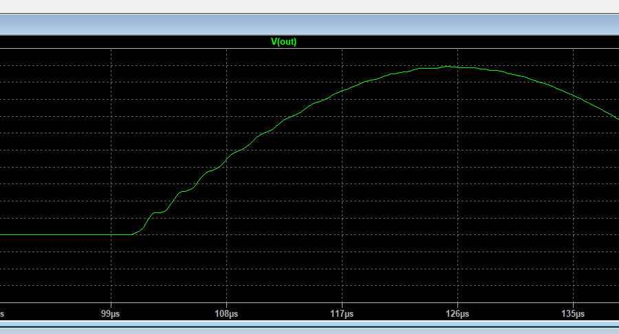

Throw out the delay line and simply increase the compensation capacity to make the effect more obvious. In the example you gave, the system has a small phase margin, judging by the vibrations on the square wave shelf. And in addition, to sharpen the effect, you should exclude the input filter.
In addition, the graph of the voltage at the inverting input of the operational amplifier will be indicative. There will be a starting spike and then the difference signal will become sinusoidal when the system returns to normal (if it is stable).

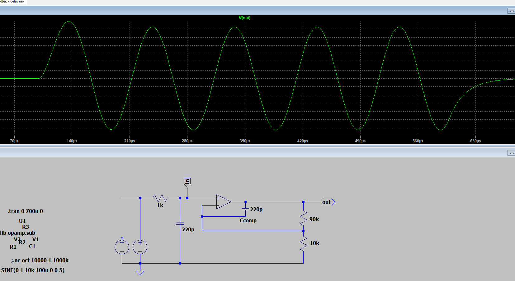

You mean like this? I'm not sure that's what we wanted... 🙄
(I wanted to show the effect with a 500ns delay value that's why I used the tline.)
Yes, so you can see the exit to the mode. The amplifier has become slower and the effect is more pronounced. However, in the middle of the graph, we can see that the sine is normal. The differential input voltage has returned to normal and the output signal corresponds to the input with some definite accuracy.
Now you can look at the signal at the point of the inverting input, it will be eloquent. You can also plot Vout - Vin*10-this is the input-output delta on the same scale. Ideally, it will be a sine after entering the operating mode.

Here are the results.
The signal at the inverting input is the same as at the non-inverting input.

I attached the opamp settings. I guess at 10khz it already starts to cut off in gain with such a Ccomp
value and that's what I "compensated" with this multiplier to get the same in/out amplitude.
