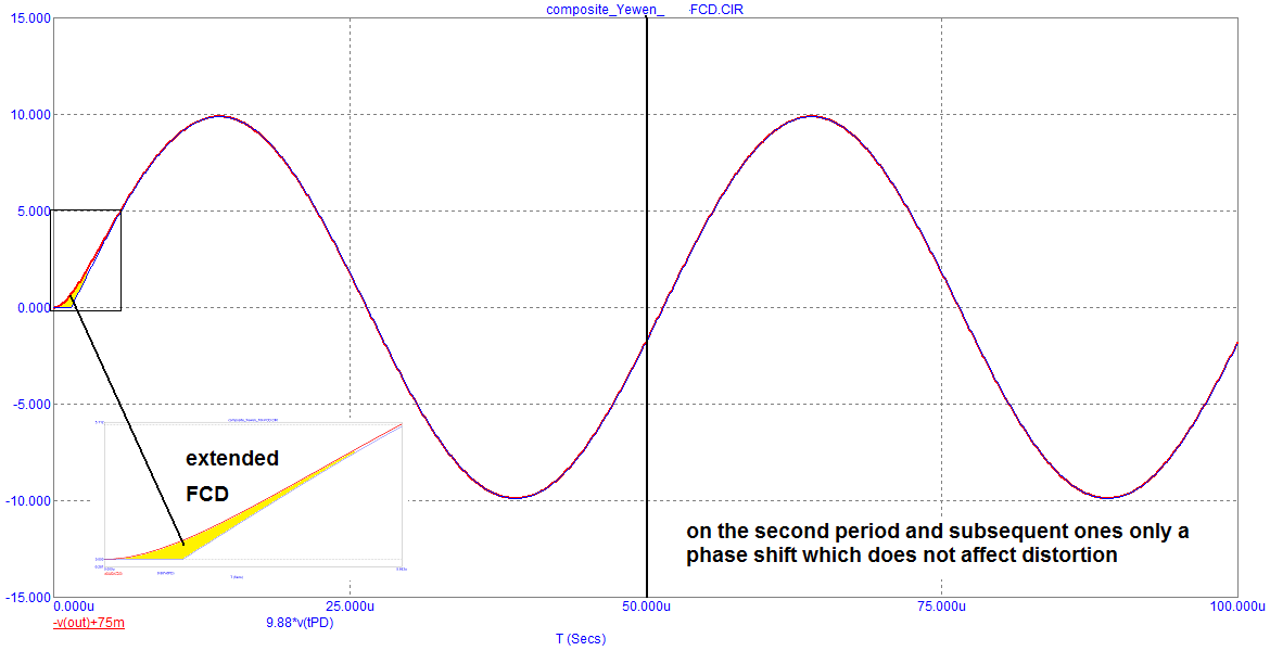

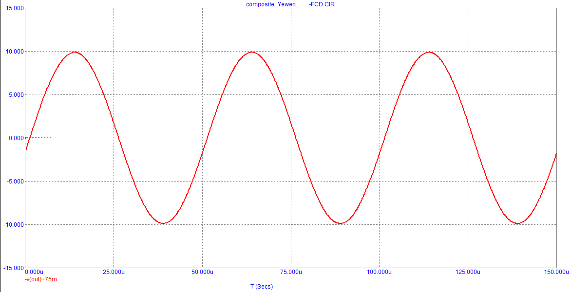

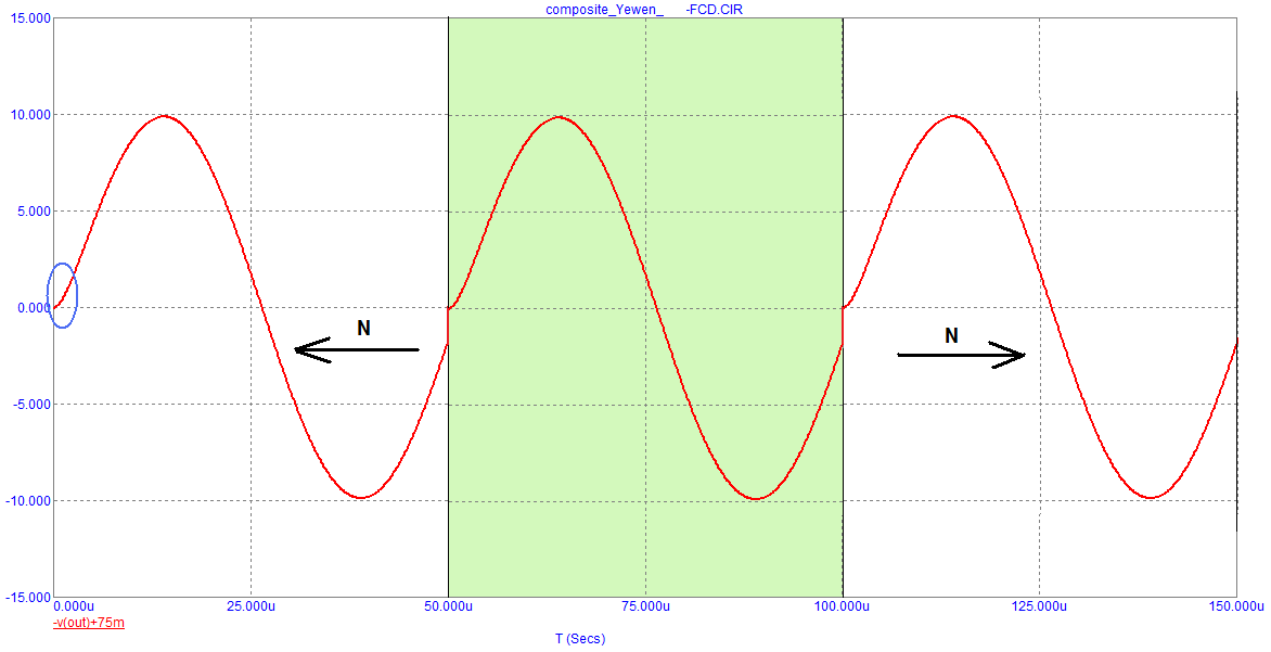

If you still mask the step signal when exposed to a sinus burst, then why don't you use a rectangular signal at once, as I have said repeatedly? In addition, it is logical to use the "transient analisys" mode to view the transient process, and not to convince everyone that it is just a sine wave and the amplifier is not able to cope with it.measurements are made virtually, and Graham has repeatedly written about this. If we are interested in what is happening in the first period, then we can see it visually using the transient analysis. I am delighted with the book by Jiri Dostal where he described in detail the distortions arising in the amplifiers.
all measuring devices contain filters whose settling time is rather long. Therefore, their readings are averaged, like the average temperature of patients in the hospital: 39 degrees in patients, and 33 degrees in a morgue, an average of 36 degrees (conditionally)
Measuring instruments do everything right, because their task is to measure non-linear distortions, not linear ones. And when you understand this, you will stop hammering nails with a microscope.
No, it's you who make him see as if your amplifier is not working, but constantly turns on as Damir said. Is that how the amplifier works at home? In addition, using a standard macro from the library to compensate for the delay, you yourself produce distortions, since it is not intended for this purpose.for the simulator, the first period looks like this
fаgos: “No, it's you who make him see as if your amplifier is not working, but constantly turns on as Damir said. Is that how the amplifier works at home? In addition, using a standard macro from the library to compensate for the delay, you yourself produce distortions, since it is not intended for this purpose.»
how did you get with your conjectures!
In your opinion, what is highlighted in yellow I created myself
Do you still not understand that there is a transition process when you turn on the scheme? The simulator shows you the same thing in essence, and you try to connect it with the sound quality. Yes, different amplifiers are used in different ways depending on their modes and frequency characteristics. Is this news to you? How does this relate to sound quality?how did you get with your conjectures!

- First cycle distortion - Graham, what is that?
