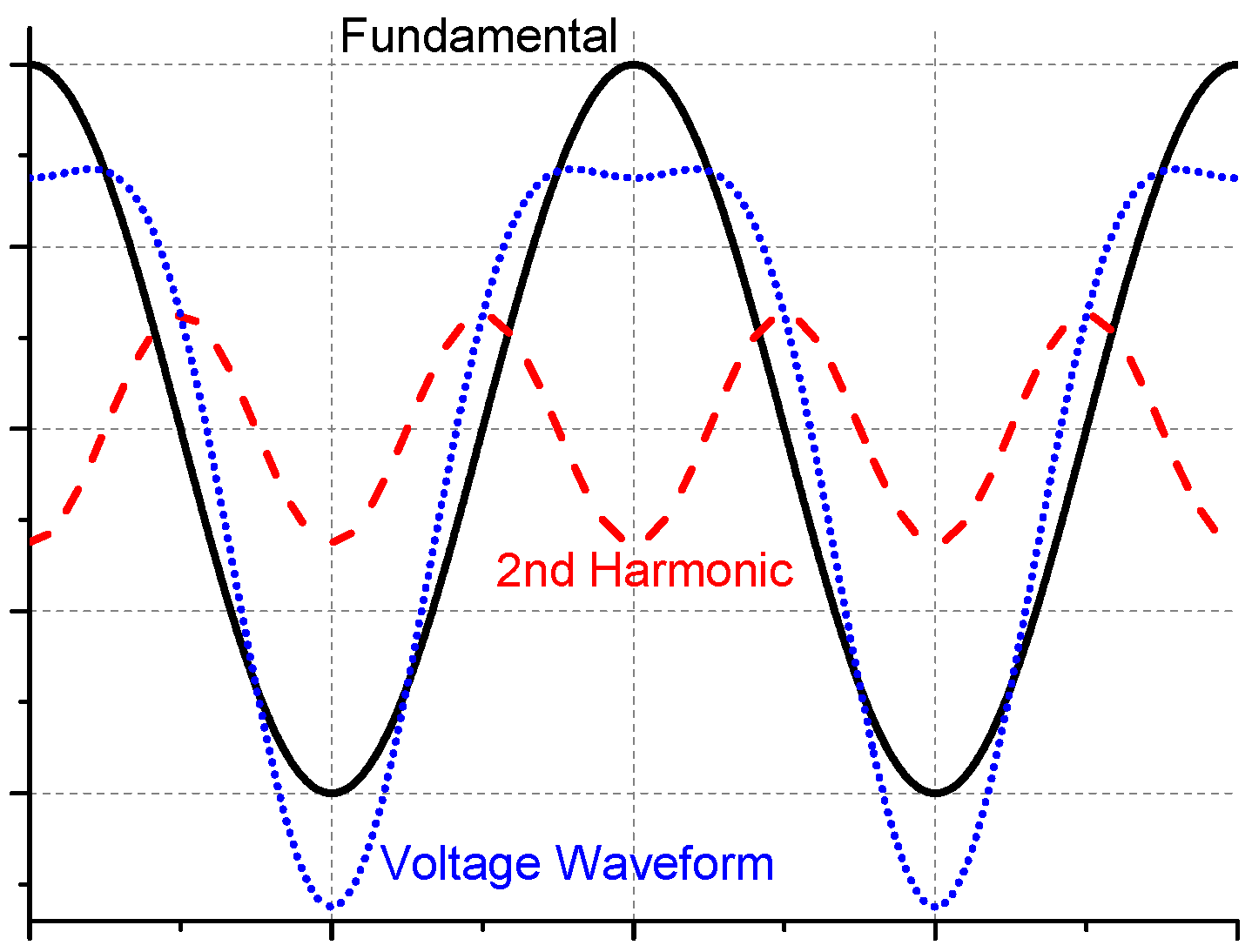

How a 1kHz input signal can (even continuously) produce a higher frequency harmonics, "signals"?
It is not the input signal that produces the harmonics. It's the amp.
Send a sine wave through a circuit that has a quadratic transfer function. What do you get at the output?
Say your amp has a transfer function (gain): Vo = (30 x Vi) + (0.1 x (Vi^2).
Now send in a 1V 1kHz signal: Vi = sin((1k/2*pi)*t). What is the output?
There is also an intuitive way to understand. Say your amp distorts, literally, your input sine wave. Maybe on the output the pos. part is a bit less in amplitude than the negative part (blue dotted wave). What is the shape difference between the input (black trace) and this distorted output? Fourier tells us the output is made up of the original summed with another wave that decreases the pos. part and increases the neg. part. Lo and behold, the 2nd harmonic (dotted red trace) fulfills that role!

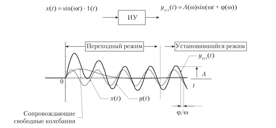

You have little idea of the processes that occur in an amplifier with NFB, so you are easily confused by the results of Petrov's simulations. With the proper level of knowledge in the head should already have a filter that protects against delusional ideas. I have shown enough in my posts throughout the topic to separate the wheat from the chaff. And other participants in the discussion showed even more and more versatile. When the sine is applied, there is no sharp start (there is no hidden modulating step) and the amplifier manages to work out the input signal rise without increasing the differential voltage at its inputs. As soon as we apply a step - there is a lag of the output signal from the input and the differential voltage between the inputs of the comparison node increases.
I showed you how the amplifier responds to a sine with a step here
https://www.diyaudio.com/forums/att...89d1608660303-cycle-distortion-graham-288-png
Let me explain - you see a "floating" sine at the output, which consists of the sine itself and the hump of the transition process caused by the step

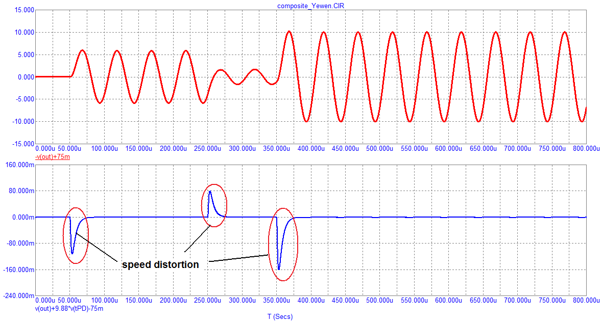

If you look at Petrov's graphs and see sharp peaks of distortion as a result of the influence of the sine, you should have a natural question - what causes it and what is the mechanism. These are the right questions. A sharp peak can only give the same sharp impact on the input. If you don't see it, it's veiled by the signal it modulates. But it is there!
https://www.diyaudio.com/forums/att...n-graham-composit_vs_lpf_speed_distortion-png
Here you see Petrov laid out a graph with different sinuses, but there are gaps between them, which are step effects and it is at these moments that distortion peaks appear as if by magic. And since the simulator calculates everything step by step, there is always a transition if the source is glued together from pieces. Don't you believe it? Apply the sum of 19kHz and 20kHz and you will not see such peaks in the signal between the outputs, although the signal jumps up and down at almost the maximum speed for the audio range.

If you want to see how the amplifier comes out of overload, then why do you need to come up with something exquisite
I wasn't saying overload testing. And neither a response to a step signal.
But your (russian? labeld) figure shows that the response has a decaying settlement section at the beginning.
And if this settling response to a (not infineitely) fast signal shows different behaviour
between 2 amps then why we couldn't use this method to get some additional info..?
And as I said earlier (for me) 2 main interpretations can be made about FCD:
a) the step signal response -> here the input signal is a suddenly starting sine wave
I leave this FCD type on Petr as I'm more intrested on option "b)"
b) settlement response -> here the step test signal is not a must at all
and a "slowly" staring sine wave is perfect (but under slowly I mean a few periods not 100).
And then we check the response for the very first complete (100% normal amplitude) sine wave at the output.
And then we compare this result with the 10th, 30th, ..., 100th periods as well.
If the 1st (few) one has a much higher distortion then the later ones, the system has a decaying distortion profile.
And if an "A" amplifier differs in this aspect from amp "B" then we
could say that it's "faster" even if they have the same bandwidth.
And after that we could check the correlation with the final sound quality as well.
But maybe this b) option is just my false interpretation of FCD and I shouldn't hijack this topic with it at all... 🙄
