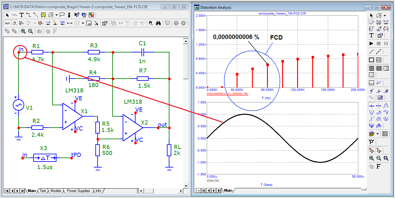

I think we need to start from the very beginning and try to determine what Petrov means. In the simulator, we can see distortions from two large groups - linear and nonlinear. There I consider options such as "memory effect". That's the first question to him - what group do the so-called FCD belong to?
Distortions have long been classified and it is quite difficult to come up with something new.
The second question is to formulate a clear measurement method for the possibility of comparing the results of different amplifiers with each other. Otherwise, you will get a comparison of warm with soft.
All amplifiers have quite understandable limitations on the parameters of the input signal. No one listens to a square wave and it is silly to try to evaluate the sound quality by testing on out-of-band input signals.
It is for this reason that I do not even try to evaluate the FCD with any tool at all, except for evaluating the frequency response and frequency response, since this is enough to have an idea of the capabilities of the amplifier.

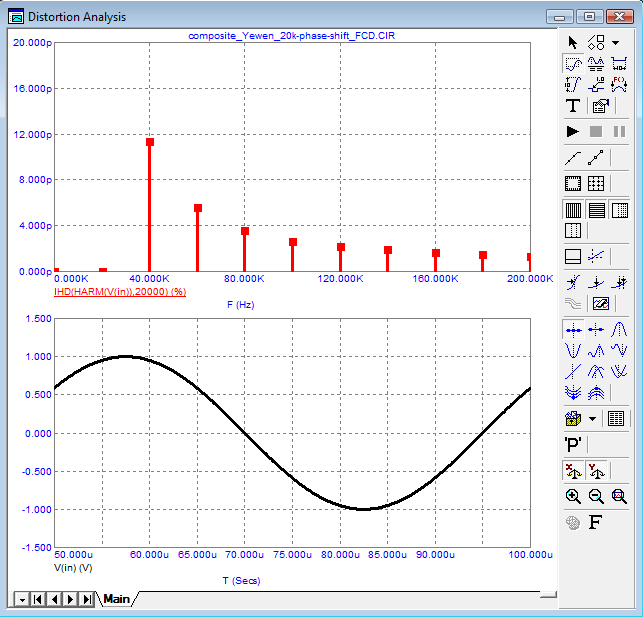

here is the distortion of the first period of the phase-shifted amplifier at the input
as you can see, the distortions of even such a castrated first period are negligible at the amplifier input, which cannot be said about the distortions of the same period at the output

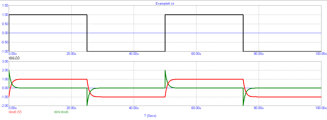

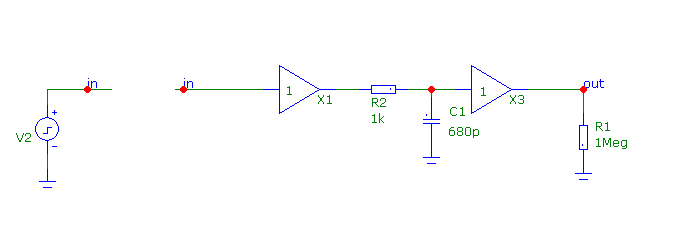

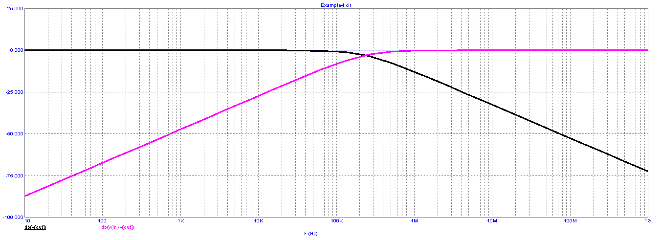

To all:
For example, I created the simplest single-pole model and fed it an ideal rectangular signal, which, as we know, has many harmonics. The graphs illustrate the shape of the output signal when such a signal is applied to its input and the difference between the input and output signals. In essence, this is something that is out of bandwidth. We see the characteristic shape of the difference signal, which can not be confused with anything. At its core, this is an integrator error, which I showed somewhere earlier in the topic in the form of a screenshot, which is also given by Sandi Todorov. If you look a little from a different point of view, this is the signal at the output of the low-pass filter, if it is given a rectangular signal at the input. But in any case, the meaning of the physical phenomenon is the same-limiting the rate of rise of the output signal by the filter circuit when applying an infinitely fast signal, ideally.
However, if we consider the amplifier simplistically as a link of the low-pass filter of the first order, it is worth noting that the useful signal supplied to the input is not in the suppression band, but in the passband and should not receive significant changes.
Why am I so verbose? Do we need to amplify what's left out if it doesn't fit our ears? Of course, we need some margin in both directions along the frequency axis, but without fanaticism and within a reasonable framework. For example, I previously gave in post 658 the justification of the upper frequency of amplified frequencies from the point of view of acoustics and scientific data on the audibility of the difference.First cycle distortion - Graham, what is that?
If someone has other data, then I will give concrete and reasonable counterarguments with links to scientific publications (not to marketing articles!).

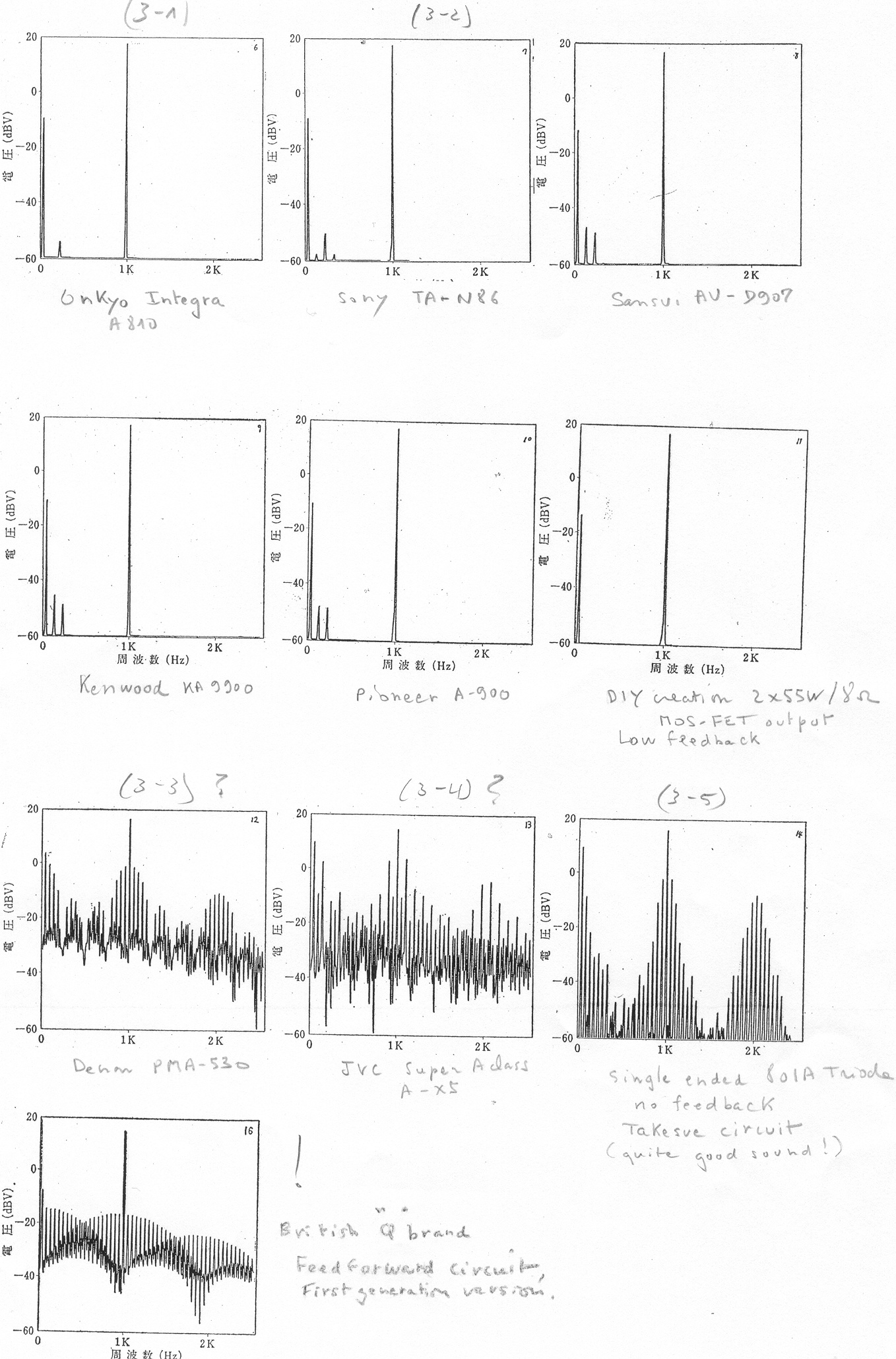

Jan, thanks for the submitted drawings
unfortunately I only have 3 schemes:
Sony TA-N86
Sansui AU-D907
JVC A-X5

I join in the gratitude. Useful and eloquent illustrative material.PS See attachment ...
But remember this is Interface Intermod, in which the test signal is inserted into the output, NOT into the input. The input is shorted.

To all:
