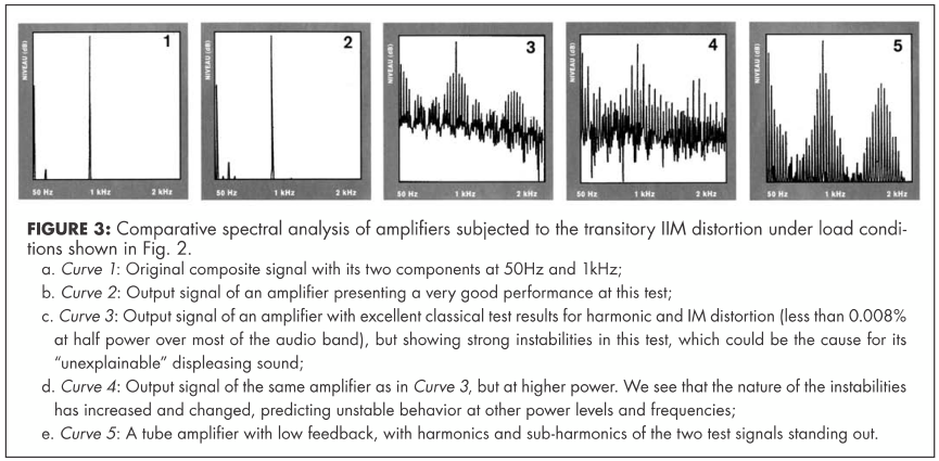

Jan, you translated article by Hiraga, the following questions for you:
can you name the brands of amplifiers that were in the test?
What is the FSD level of the first amplifier and what is the second one?
Why does the second amplifier with TCD = 0.008% sound ugly?
Why does a high distortion tube amplifier have such a low RIMD (Reverse Intermodulation) noise floor? Much lower than an amplifier with THD = 0.008%
Jan, there is no distortion in the suddenly-onset signal at the amplifier input, they are only at the amplifier output!

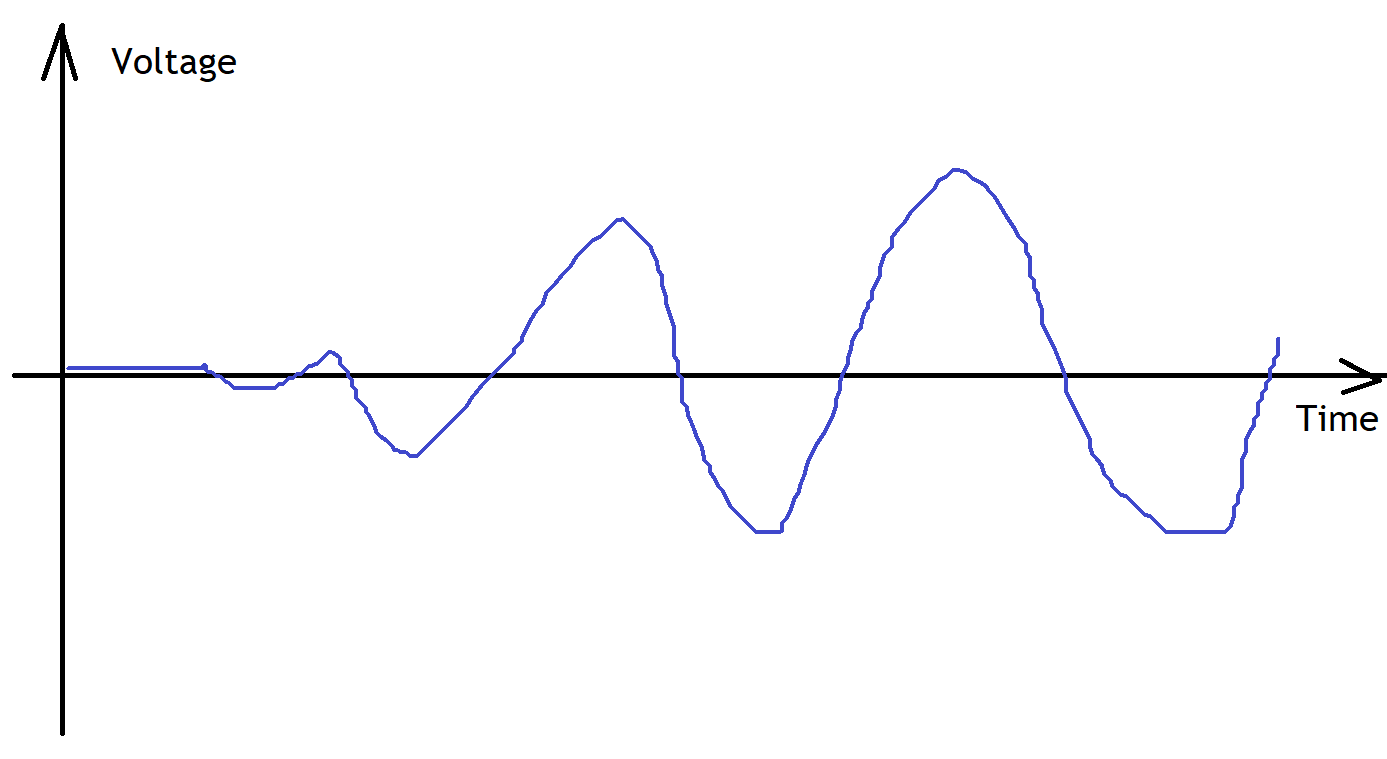

Thanks Jan!If you tell me how FCD is defined, I will try again.
For me (at this point on the topic) FCD could be mean 2 things (a + b) but with 2 common criteria (1 + 2):
1) let the system settle to a calm state without any drive at the input
a) let's stimulate the amp with a step kind of "sine" signal starting from 0 to check the transient behaviour
(I know but yes still even if it's not a typical music kind of signal)
or b) apply a slower (full standard audio band speed) starting but a high level signal
(like the guitar string plucking as I linked a few posts earlier)
and check the response but from the very beginning 0 time point
2) Then we record/measure/check this exact one "period" (time section) output
response immediately after this stimulation and directly without any:
- waiting
- time windowing (taking multiple "periods")
- averaging
My assumption is that there can be some "nasty" transition artifacts after
a bigger (and faster) change at the input signal but only at the very beginning
which we can "miss" if we wait, average, etc.
Even if no one "belives" just for the sake of the game/topic let's
assume it can be true: so then how could we check/measure this?
I'm not sure that what was Graham's original idea from options a) or b)
maybe rather a) and b) is just my subjective interpretation which is a completely other topic.
Option a) focuses rather on the signal speed while b) focuses on the "state change" of the
whole system, the speed and cleanness of this setllement process but from the very beginning.
For example when we do some simulation often we have to wait untill the whole circuit settles
to its steady DC state operating point and then we can start to measure it with a test signal.
I guess the same is happening (but of course a much smaller level) when the average
"energy level" is changing during a musical signal.
I don't know whether I described this in an understandable way... 🙄

Then I ask Petr: is it necessary (for you) to use this step kind of sine wave or is it
enough to use jsut a very fastly increasing signal started from a small sine wave?
Like I draw earlier? (attached again)
as it's not the normal drive/load yet it can give some extra (and usefull) info about the behaviour of our amplifier
that wouldn't come up when testing it with a max 20kHz sine wave and a perfectly resistive load, that's all.
But the specialty about this "first cylce" idea (for me at least) is that it focuses on the very
early reply and not on the averaged response after some delay as with real music it's also the
requirement that the system should perform perfectly from the very first stimulations and not just
after a settling time and on an avareage level.

Once again the base question (for me) regarding the FCD:
What if there is some transient/temporary distortion with non-periodic highly
changing signals but only at the begining because the system settles in the first few periods..?!
(Let's assume we can hear it... 🙂)
