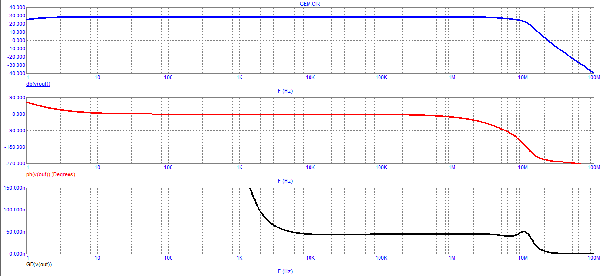

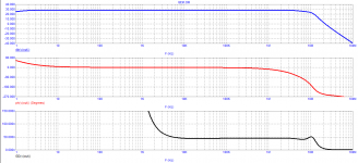

By the way, here is the Bode diagram of the Graham amplifier, the GD is measured with a "caliper" (according to the expression of the fagos). Group delay less than 50 ns and constant in the band up to several MHz. The JLH-69 amplifier has a slightly higher delay (about 80 ns) and is stable up to 500 kHz.
Look at the frequency where the phase reaches -180 degrees and the corresponding point on the gain plot. 180 degrees is where nfb becomes pfb with a magnitude of around 20dB. The function of the circuit is thus converted to an oscillator.
