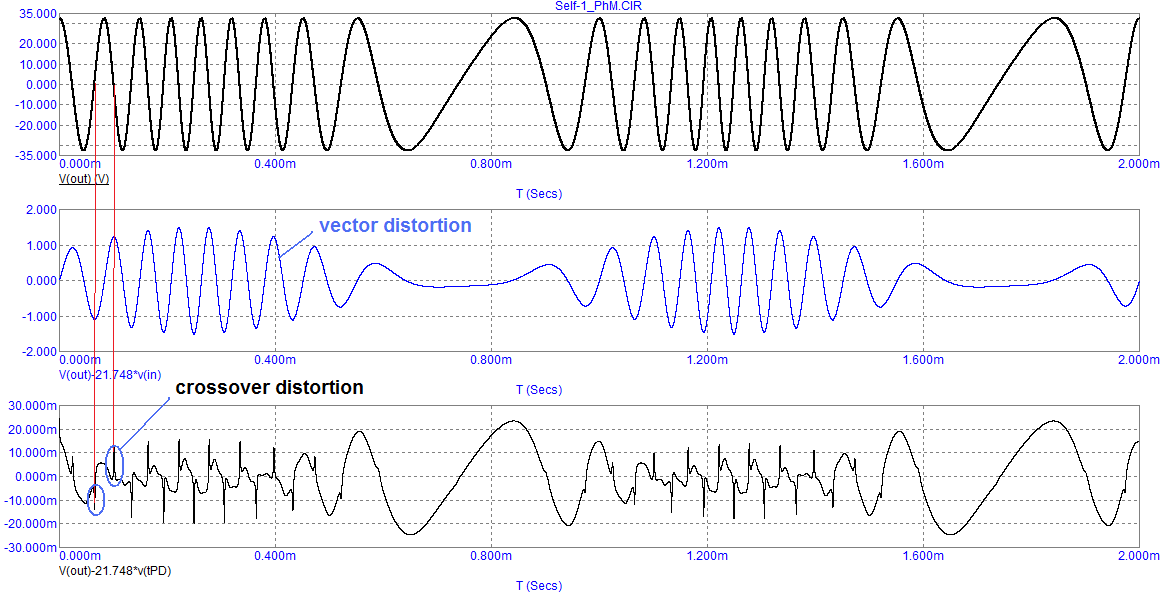

The quiescent current of both amplifiers is the same - 116 mA each
Experience the Difference Between Two Amplifiers
The first amplifier has much larger vector distortions, since the signal propagation delay time is longer.
The first amplifier also copes worse with switching distortion due to the slow NFB.
measurements carried out by the Baksandall method

Both vector and crossover distortion is enough to show amp 2 is better than amp 1. Why do you need another distortion test procedure such as FCD to show the already obvious difference?
I use the test in the first period only as an express analysis, nothing more.Both vector and crossover distortion is enough to show amp 2 is better than amp 1. Why do you need another distortion test procedure such as FCD to show the already obvious difference?
If you've read my amplifier testing reviews, they include over ten different tests. Not every review has all of them, of course.
strictly speaking, having some experience, you can predict the behavior of the amplifier by looking at the group delay
