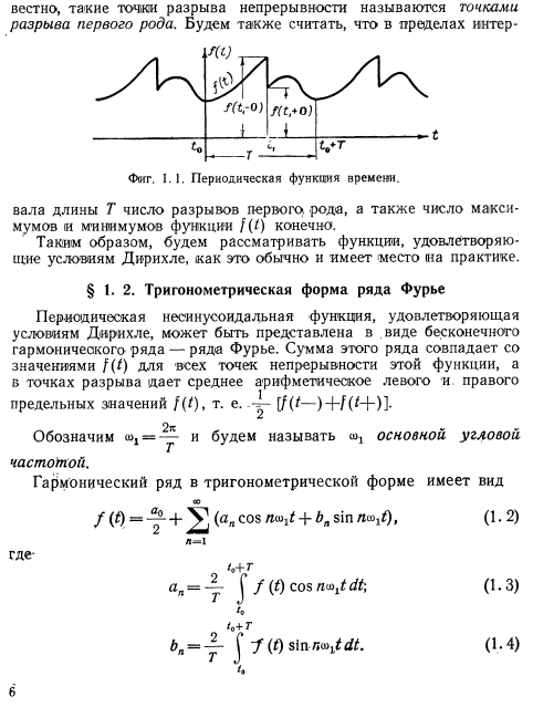

It's strange that basic things don't reach anyone.
I'm tired of explaining that the program I'm working with turns the signal of the first period into a periodic signal, regardless of whether there is a phase gap or not.
Here is an example from a textbook of such a signal and a Fourier expansion formula. Everything is painted over 60 years ago, I think there are earlier publications. The first period just characterizes the speed distortions that are not detected by any other testing methods. Spectrum analyzers are not able to measure the instantaneous spectrum of a musical signal - they show an average value - analogous - the average temperature of patients in a hospital.
Distortion meters measure the level of distortion in a steady state.
If someone does not understand basic things, then what Graham unsuccessfully explained in his time, then there is nothing to be angry and offended - pass by, this is not for you.
Periodic non-sinusoidal function fulfilling Dirichlet’s criteria, can be represented in a form of infinite harmonic order – Fourier’s order. Sum of that order equals with the value of f(t) in every point of continuity of that function and in the points of discontinuity it gives the arithmetical average of the left and right limit values of f(t) i.e. ½*[f(t-) + f(t+)].”
It says periodic. First cycle is not periodic, it happens only once.
