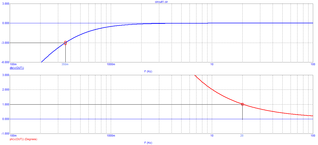

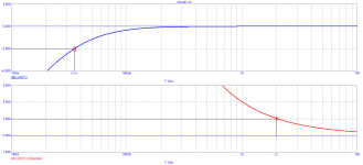

According to the calculations given in the book by Jiri Dostal (1981), to obtain an amplitude error of no more than 0.01%, the amplifier's passband should be 71 times wider than the extreme frequency of the audio range.
Thus, from above it is necessary to have a cutoff frequency of the amplifier of 20 kHz * 71 = 1.4 MHz. Similar to bottom 20/71 = 0.28 Hz.
Knowing the required bandwidth from above, it is easy to calculate SR.
With such a bandwidth, we will automatically obtain the required signal transit time (time Propagation Delay).
Well, as for the cutoff frequency from below, experts set it along a square wave (meander) with a frequency of 20 Hz, the shelves should be horizontal. This condition is met by a phase shift of no more than 1 degree, which fully fits into the calculations of Jiri Dostal.
Judging by the figures that I gave, a tenfold reserve of bandwidth in both directions is clearly not enough. A stock is required at least 50 ... 70 times.
When these conditions are met, speed distortions and distortions associated with transient processes disappear and only nonlinear distortions introduced by the amplifier remain.

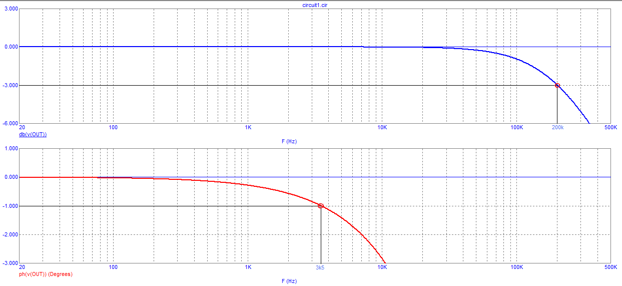

You clearly do not know how to read, or you have a bad understanding of the essence of what you read. All the parameters of Jiri Dostal were given regarding systems that need a minimum delay in signal transmission - positioning systems, position control. In such systems, the minimum delays between output and input are really important, so its calculations are worth applying there. In the case of audio technology, the requirements are reduced, since we do not listen to the input-output difference signal, but only the output. So you should re-read and think again.According to the calculations given in the book by Jiri Dostal (1981), to obtain an amplitude error of no more than 0.01%, the amplifier's passband should be 71 times wider than the extreme frequency of the audio range.
If you make the lower limit of the range 0.28 Hz, then all the infrasonic components will come to the input and cause an increase in the distortion of your speaker system, which is not working so low. Similarly, with the upper limit-amplify all parasitic leads and submit them to twitter for no clear reason.
For comparison, at the cutoff frequency of the amplifying channel and the first order of decay of 200 kHz, the difference in the amplitudes of the frequencies of 1 kHz and 20 kHz is -0.04 dB or about 0.5%. Can you detect this amount of linear distortion with your ear? I don't think so. I agree with the authors of the book "Musical acoustics" Irina Aldoshina and Roy Pritts, who write that the differential auditory threshold (JND - just noticeable difference) in the most optimistic case is 0.5 dB. Usually higher depending on the frequency and intensity of the test signal. And this is on single-frequency testing, and not under masking conditions with real audio playback. As you can see, everything fits together.
Please name the experts who claim that the 20 Hz signal shelves should be smooth. You understand that such a statement should be supported by criteria for evaluating "evenness". For example, specify the relative difference between the beginning and end of the shelves, or something else...
