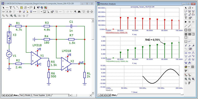

Let's leave the very 1st one. The 2nd period is already ok to use it as a 100% normal sine wave?
What if the 2nd period has a THD of 0.3%, the 3rd 0.2% and the 4th 0.01%?
According to that Fourier troublemaker, the right answer is: never. Once you are attempting to calculate the Fourier transform of the product of two functions (a step function and a sine) you will note that you'll have to wait an infinite time for the convolution product to converge.
So you need another (for example THD related) criteria to define the number of periods to wait until that THD value is reached (this is known as an "engineering" criteria). This means that if you tell me the THD threshold you want and the sine frequency/period I could be bothered to tell you the number of sine periods to wait until the THD drops under the specified value. If that's so important for you, of course, otherwise I do not support trolling around Fourier.
And what if the amplifier does some nasty things during the first few periods?
Just for the sake of me, what if the amplifier would do "random" output signal at the begining?

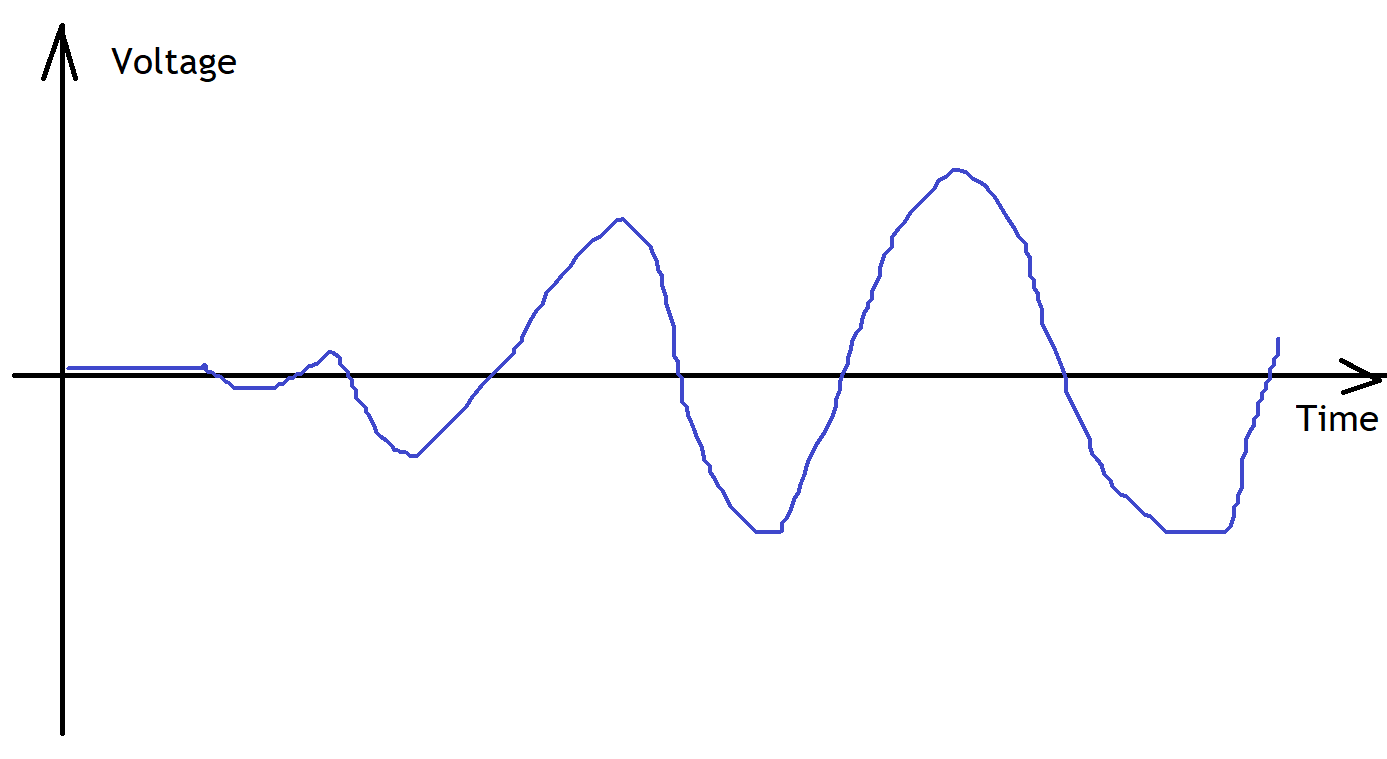

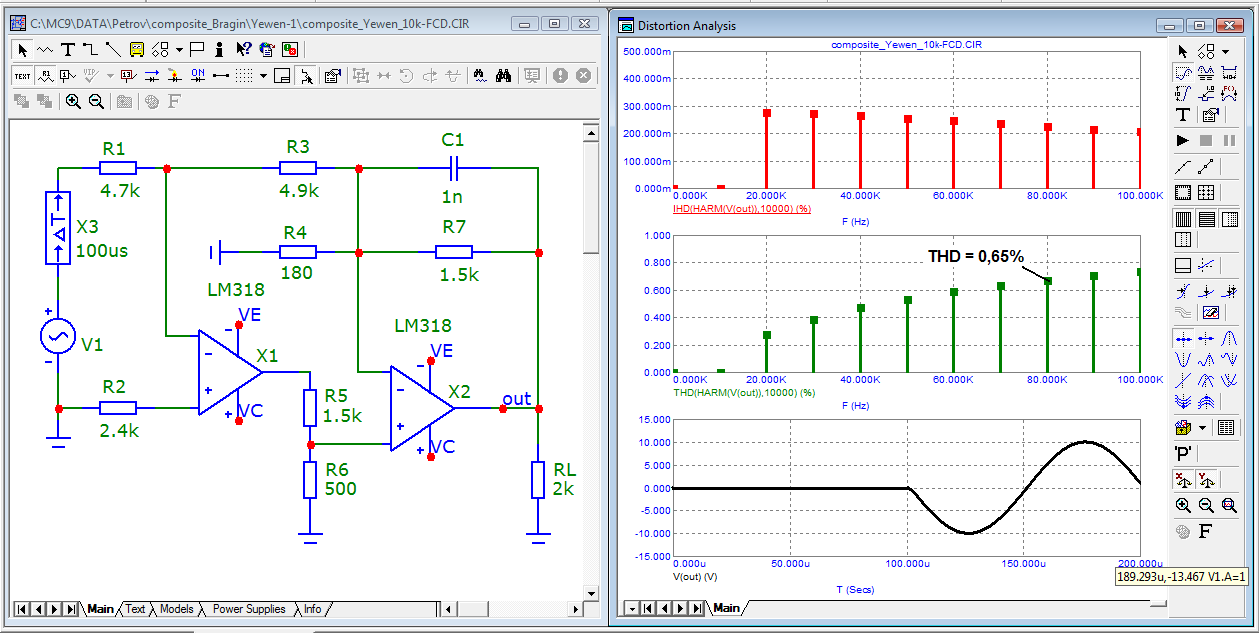

I'm not stuck to the step signal from zero at all. That's why I came up earlier with this attached
test signal (as maybe a compromise) which is 1 kHz sine starting gradually from 0 level.
What kind of similar test signal could you accept to check this aspect?
How fast should the amplitude grow to reach the nominal level?
And when we could start to check the distortion?
And why we have to wait at all? Isn't the very first reaction time section an extremely important factor?
Or is this test signal also unreal and misleading and useless?

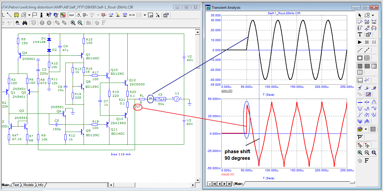

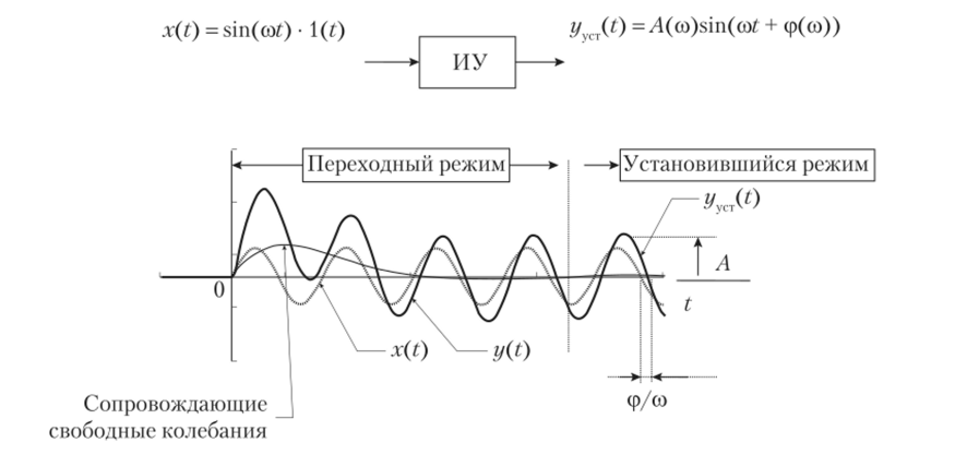

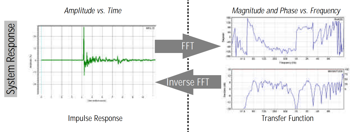

The answer is for those who still do not understand that the beginning of a sinusoid or a burst is a step signal. You do not analyze the sine in your pictures, but the sine + step with all the transition process from it. And the further away from the first period the analysis is made, the less there is a transient process and more of that sine, because the error decreases. For the same reason, all synthetic tests with bursts produce transients that are visible in transient analysis. Read the theory of linear chains on this subject, if the illustrations Jiri Dostal for you are not very eloquent.a question for experts in the Fourier transform. What is the difference between the first period of the generator and the first period at the output of the amplifier? I remember that the distortion of this amplifier in the steady state is < 0.000002%
Of course, the time constant of the amplifier is inextricably linked to the dynamic characteristics estimated by the transition characteristic, but we do not listen to the amplifier in this mode. Come to your senses.
Source of the picture: Shchepetov-Fundamentals of designing devices and systems (in Russian in the original)

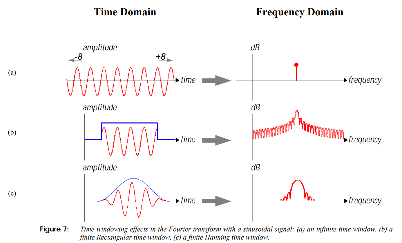

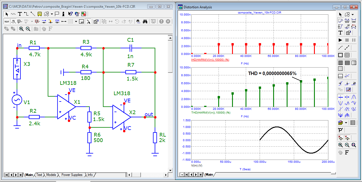

Windowing (see attachement #1) could help but also can cause trouble.The effect of this windowing operation on the frequency domain is obvious,
as the energy is dispersed into a single main lobe plus a number of side lobes
(called spectral leakage). The pattern of the side lobes is a function of the
rectangular window, and is primarily created by the abrupt discontinuity at
the edges of the window. The high relative level of these side lobes could
cause other important spectral information to be hidden, or masked.
However, if we apply a finite but gentle time windowing function,
as seen in Figure 7c, we can significantly reduce the level of the side
lobes by gradually tapering the waveform to zero at the ends.
A side effect of this operation causes the main lobe to increase in width,
which may also mask spectral details from nearby frequency components.
And wow, here (7c) is exactly "my" incremental kind of sine wave used as a test signal! 😀

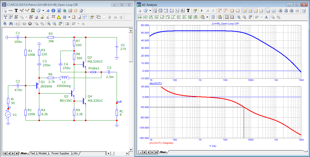

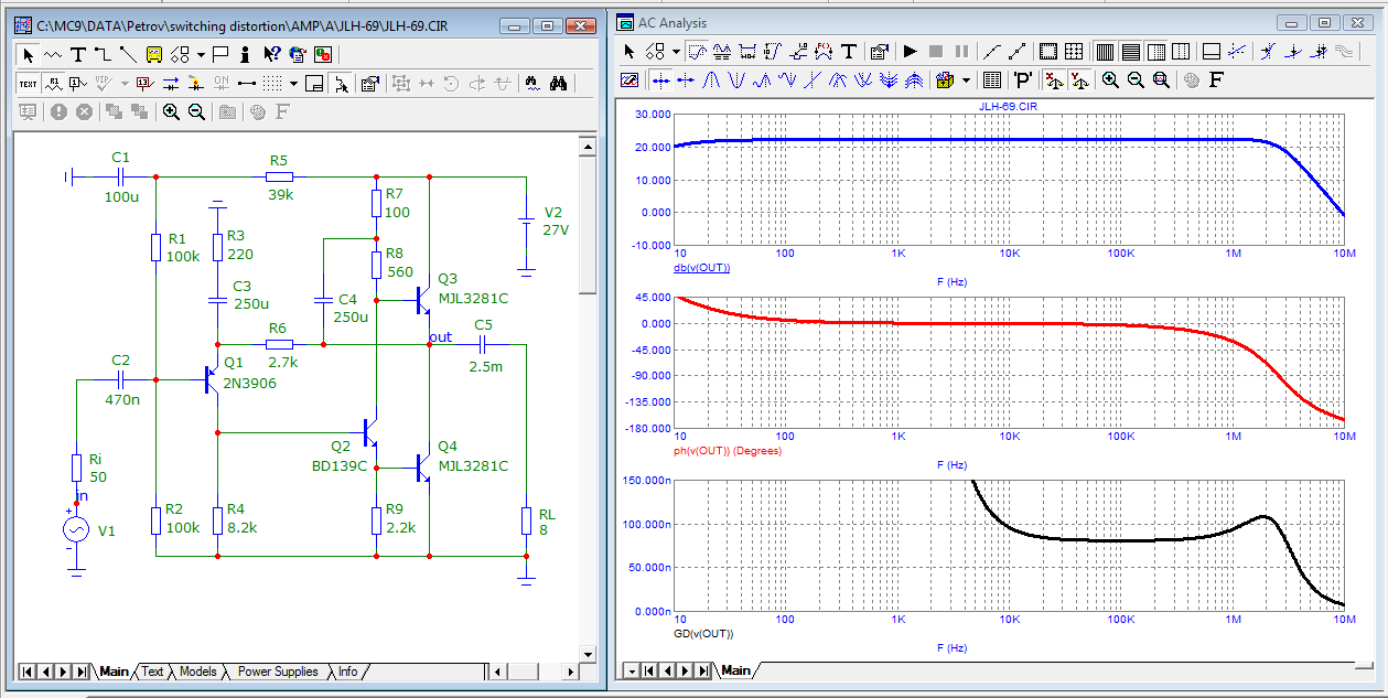

acts Graham noted that amplifiers with a low delay in the high frequency region, such as the JLH-69 and some others, cope well with external influences.
Let's compare the work of JLH-69 and Self-1 at a frequency of 20 kHz
The output impedance of the JLH-69 is more linear, and most importantly, its output (aka input) instantly reacts to the signal. These arguments Graham repeatedly cited both in this thread and on the site with the description of his amplifier The GEM.

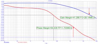

So what is responsible for proper operation of the amplifier? Look at the Bode diagram of the JLH-69 amplifier, the group delay at 20 kHz is 80 ns, the frequency of the first pole is 55 kHz - three times the audio range. In the area of HF Group Delay it is constant almost up to 500 kHz, therefore, there are no displacements of the HF harmonics of the signal affecting the timbre, localization of apparent sound sources, to the depth of the scene (sound image)
1) the input of the amplifier, which receives the useful signal and the feedback signal from the amplifier output;
2) the output of the amplifier - it is also the input on which the back-EMF of the speaker
no theory will help you, so you don't understand how measurements take place in the simulatorThe answer is for those who still do not understand that the beginning of a sinusoid or a burst is a step signal. You do not analyze the sine in your pictures, but the sine + step with all the transition process from it. And the further away from the first period the analysis is made, the less there is a transient process and more of that sine, because the error decreases. For the same reason, all synthetic tests with bursts produce transients that are visible in transient analysis.
- First cycle distortion - Graham, what is that?
