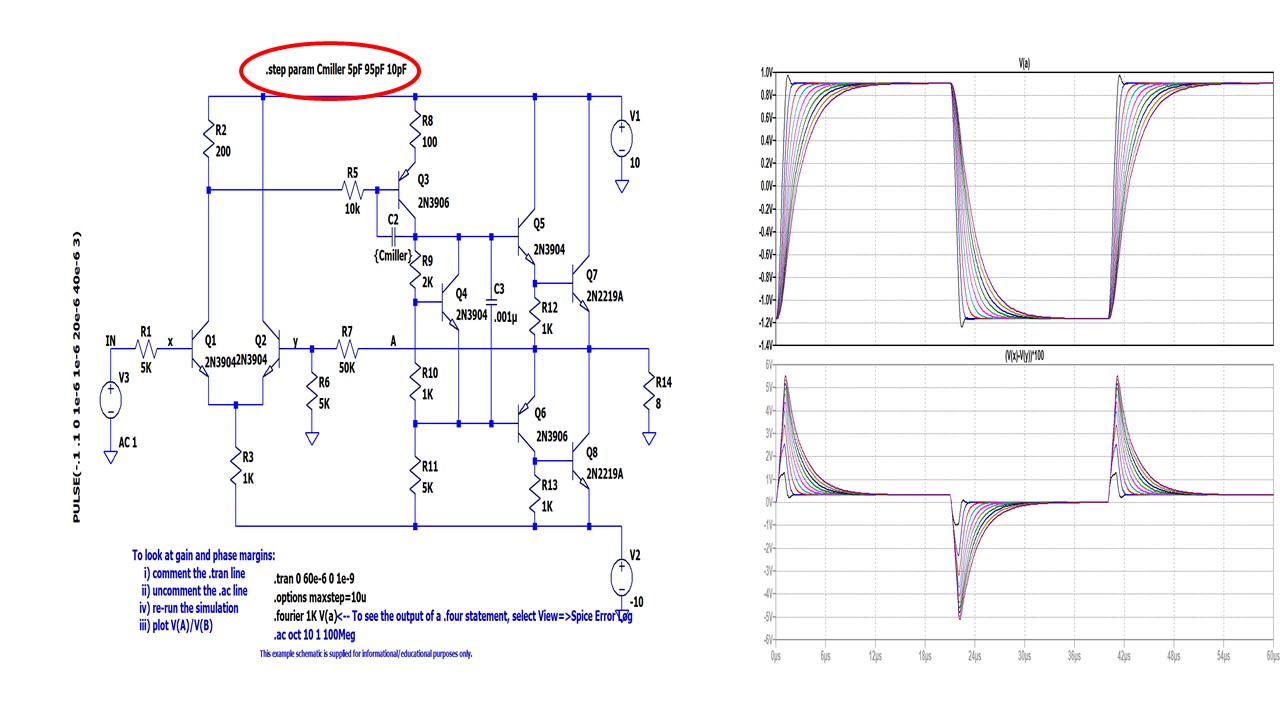

First cycle distortion - Graham, what is that?
This is a picture of the difference the voltage between the inverting and non-inverting inputs of the LTspice amp in the Examples folder in response to stepping Cmiller from 5pF to 95pf in 10pF increments.
You can see the amp goes from partially stable to stable, while the overshoot (magnitide and length) increases as you increase Cdom. The closed loop bandwidth also decreases as Cmiller is increased.
The 1st cycle delay is really just the loop response phase shift because the 2nd stage of the amp is an integrator. Once the loop compensation is optimised (10 to 20pF in this case) you have the lowest phase difference between the input and feedback signal consistent with stable operation.
So IMV, 1st 'cycle distortion' is just about getting the amplifier feedback loop stable consistent with the required bandwidth (and there's a big variation there because designers have different views). The loop bandwidth ultimately has to obey the laws of physics and that means there will be a phase shift around the loop - its not any kind of distortion.
Neat. And a clear, comprehensive explanation of what goes on. No surprises.
Jan
@jan - yes that's the simple explanation. If you look at the LTP output current in R2 you see it peaks higher and higher as Cmiller in increased but only in response to the rising/falling edges as would be expected. But on the flat top/bottom, there is no difference in current output with change in Cmiller - also as expected since the DC gain is the same no matter what the compensation cap. So the first phase is simply the loop responding to the 2nd stage integrator rate - longer the slower the slope.
(I think Bruno covered this in his F word paper but from a slightly different angle and with math of course)

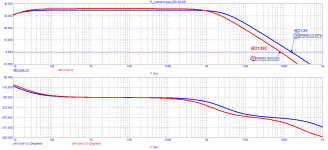

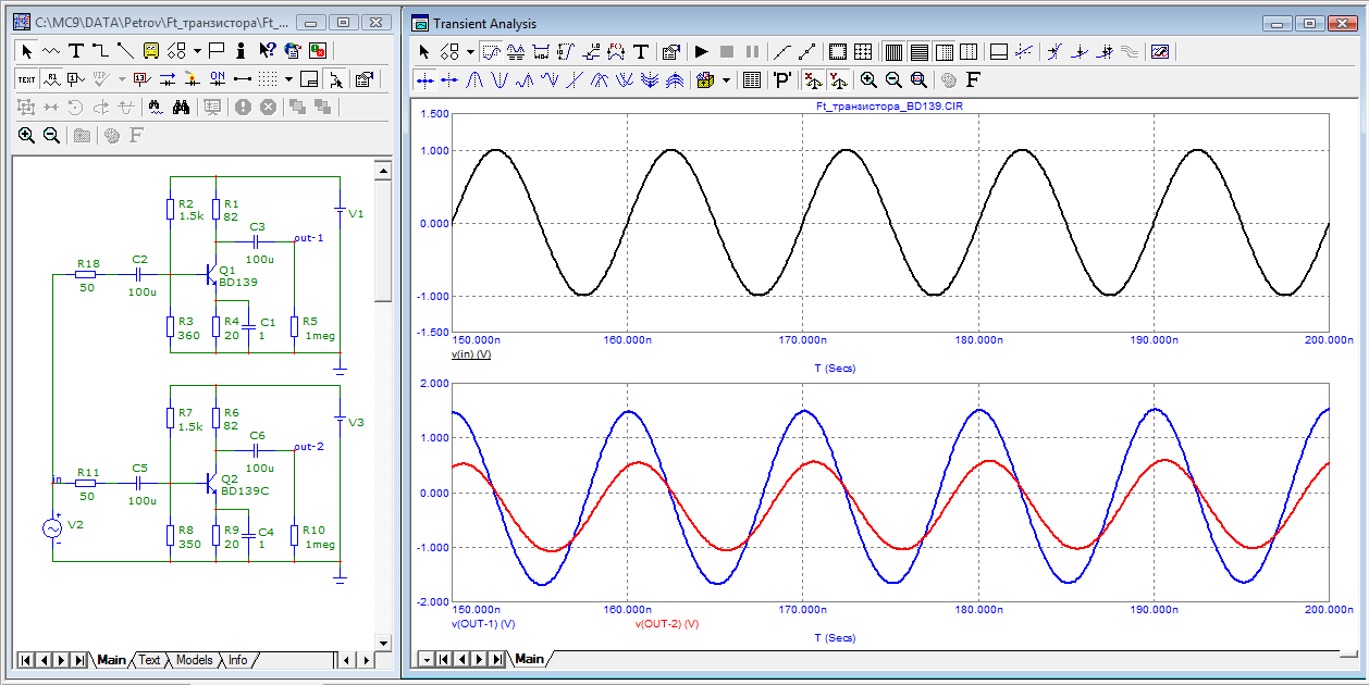

Which model do you think is closer to reality? As the saying goes, "not always in the barn what is written on it."

The same transistors are made by many manufacturers and they all differ in parameters from each other. You suggest that I develop my own model for each transistor.
