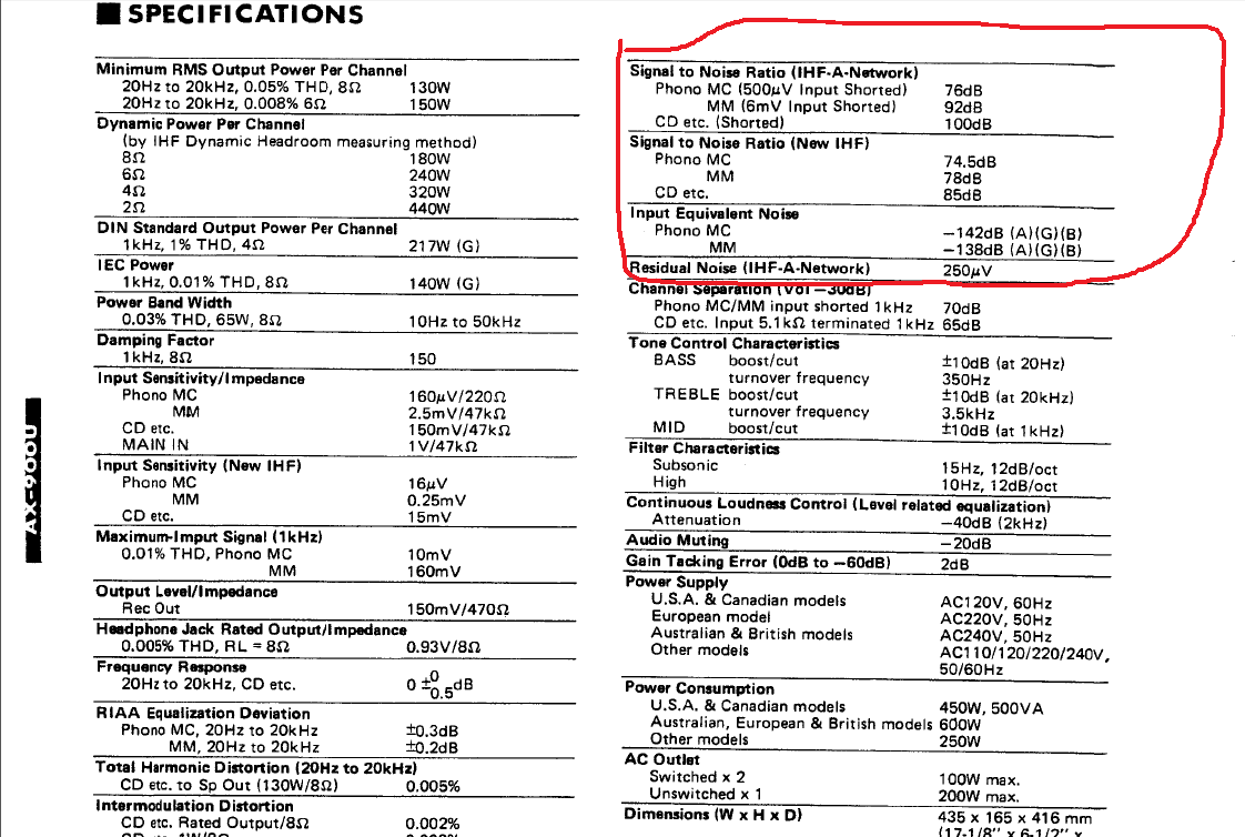

probably shorted input so it misses the current noise component.

Yes. I remember we took John Atkinson to task here for measuring phono stage noise by shorting the inputs.

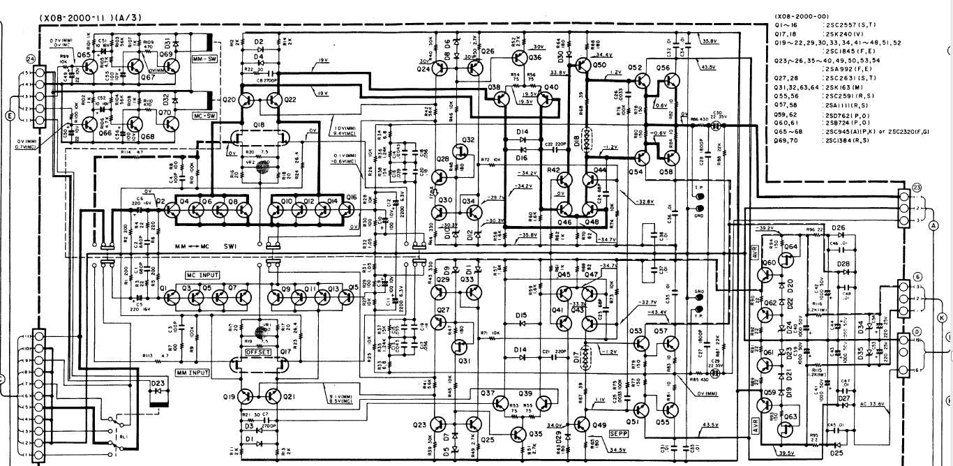

maybe you can point point out a better solid state design than this 1982 one....yeah, i know it has fet transistors too , but i also know a lot of other things i am not going to fill this topic with...@dreamth

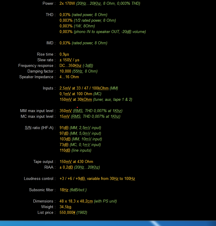

yamaha claimed some similar numbers, but in their specs there are two different standards so i can get a grasp on what 75 db means for some and what 75db means for others but in the end we all get is smth about 75db sS/R
Indeed, it uses JFETs as the moving-magnet input stage. Anyway, the 1978 Hoeffelman and Meys circuit will probably outperform it, at least regarding noise.

When it says "input shorted", you know it's nonsense.

somehow the difference in yamaha between shorted and non shorted makes sense because the mc input noise rises by 1.5db while the mm input rises by 4 db from one measurement set to another.When it says "input shorted", you know it's nonsense.

More nonsense from Yamaha - I don’t know how these manufacturers claimed this stuff.

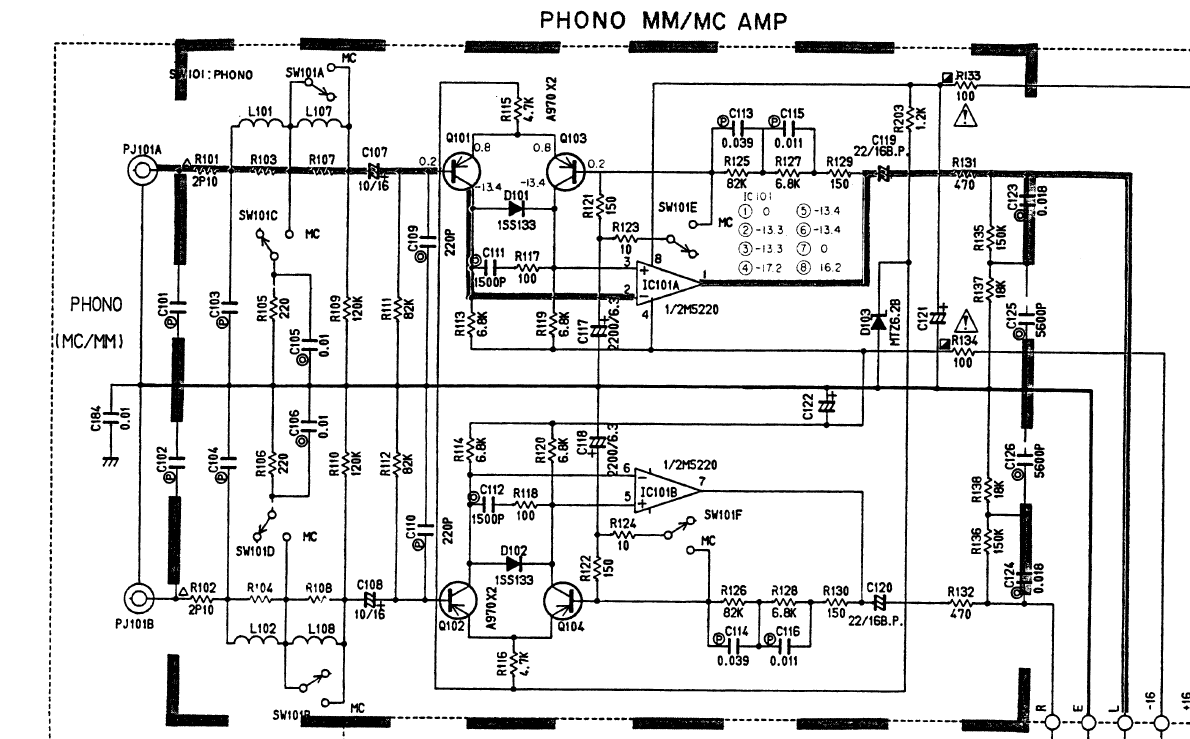

The Yamaha circuit has a compromise input stage: the tail current is too low for moving coil and too high for moving magnet. As a result, its equivalent input noise voltage will dominate for moving coil and its equivalent input noise current for moving magnet. With shorted input, the equivalent input noise current has no effect, so you get reasonable numbers for moving coil and way too high numbers for moving magnet.
I didn't even bother to think of it...i found that example when trying to see what IHF-A means...The only numbers that i am really interested in when i see a new service manual are the input sensitivity and the max input overload margins...For kenwood are double than for yamaha as it's a discrete design supplyed at +-43v...In all the schematics i ever saw , the kenwood one is the best by far.Although it has such high supply rails it has soft clipping at every stage...and that's smart.The only thing that makes a phono preamp shine is his behavior under stress,not its out of this world SNR...

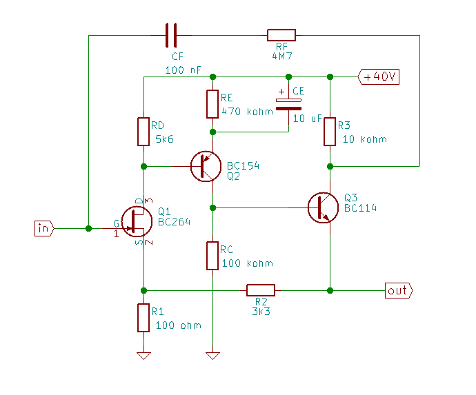

This is the original Hoeffelman and Meys configuration, redrawn to avoid copyright issues. It is just a flat-gain amplifier with a gain of 34 and an electrically cold 47 kohm input resistance. You can turn it into a RIAA amplifier by replacing R2 with a RIAA correction network. You need some kind of buffer after the output, as any load disturbs the input resistance. See the Journal of the Audio Engineering Society December 1978 (original article) and September 1979 (letter from Ernst Nordholt pointing out that R2 could be replaced with a RIAA correction network).
