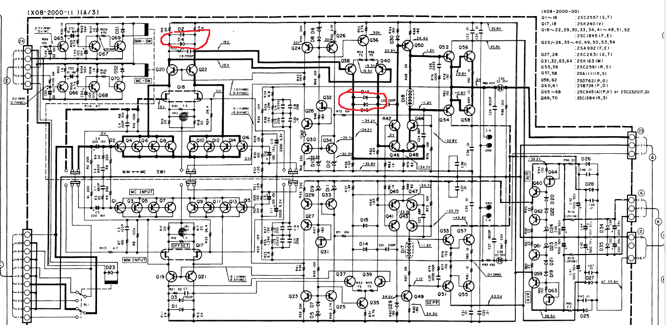

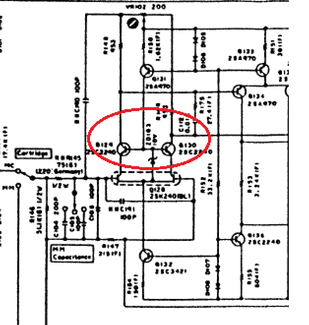

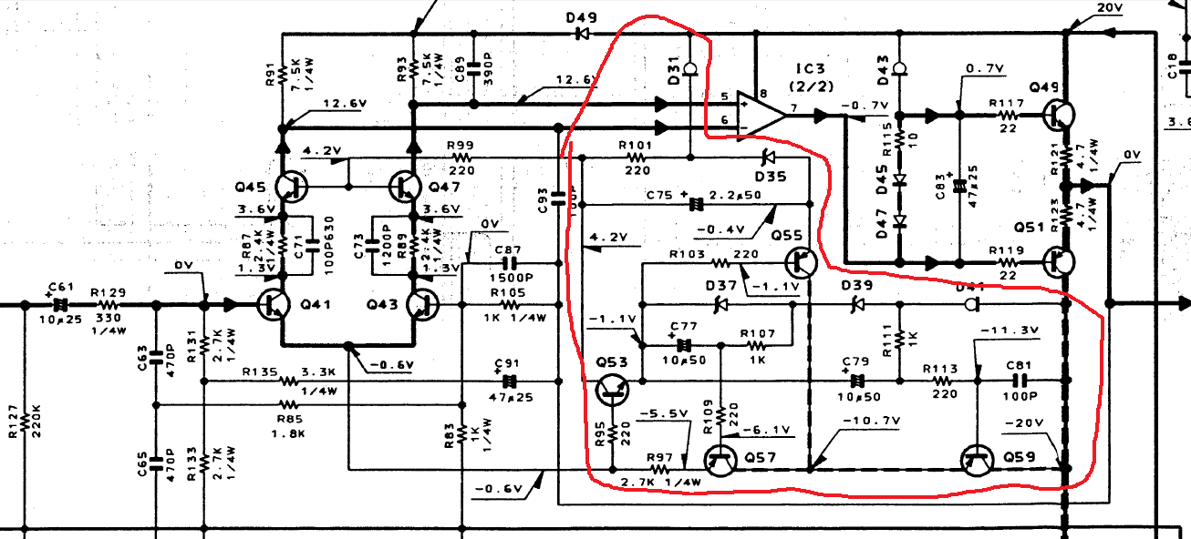

Here's something for a genious that's able to understand this circuit function (the one circled in red) without reading the service manual. For those who don't think of themselves as the best designers in the Universe i'll send the service manual that explains everything 🙂

Terrible. Over complicated, pretentious, completely lacking in elegance and can be done with a fraction of the components today. This is the problem with audio. When people cook up circuits like this, it’s no longer engineering but performance art.
People have tried to explain to you and others that the cartridge is the thing that in any competent MM pre design ultimately limits the performance. Designing circuits that ignore the reality of the noise contribution of L and R fall short on performance and topological elegance.

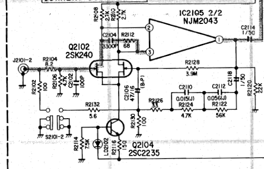

Is it the MM / RIAA part of this circuit that you find over complicated or the MC pre amp?
Sure, the 2sk240 is low gate-source capacitance and one could argue that that cascode is not needed, but I believe that in general, cascode is good for JFET MM input stages.

I don't see any cascode in the mc section in CA-7 but CA-5 and SR4 were made by the same company at the same time during the contract they had with Treshold...they are just different flavors for different money...the same as todays most acclaimed designs but noone will disconsider the phono section in SR4 or CA-5 just becuase they had built on a bufget...They are much better than many other preamps.Is it the MM / RIAA part of this circuit that you find over complicated or the MC pre amp?
Yet i wanted to show that in 1987 they knew how to make a sucessful MC input with just one 2sk170 in CA-5 ...while they showed the complete opposite in CA-7 same year.

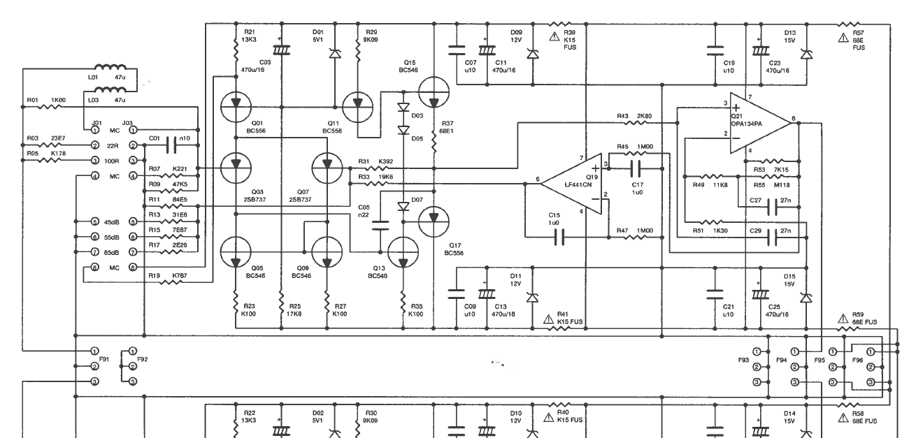

As for the Nad S100 ...not bad at all at a first glance, extremely low noise PNP transistor, probably extinct, but for DIY i stick with their previous design in 2030 at least for the mm section...

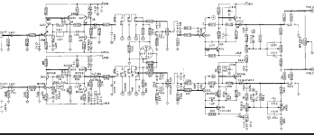

Another design i really liked was one that i found in a scraped HK that i never had the opportunity to listen...

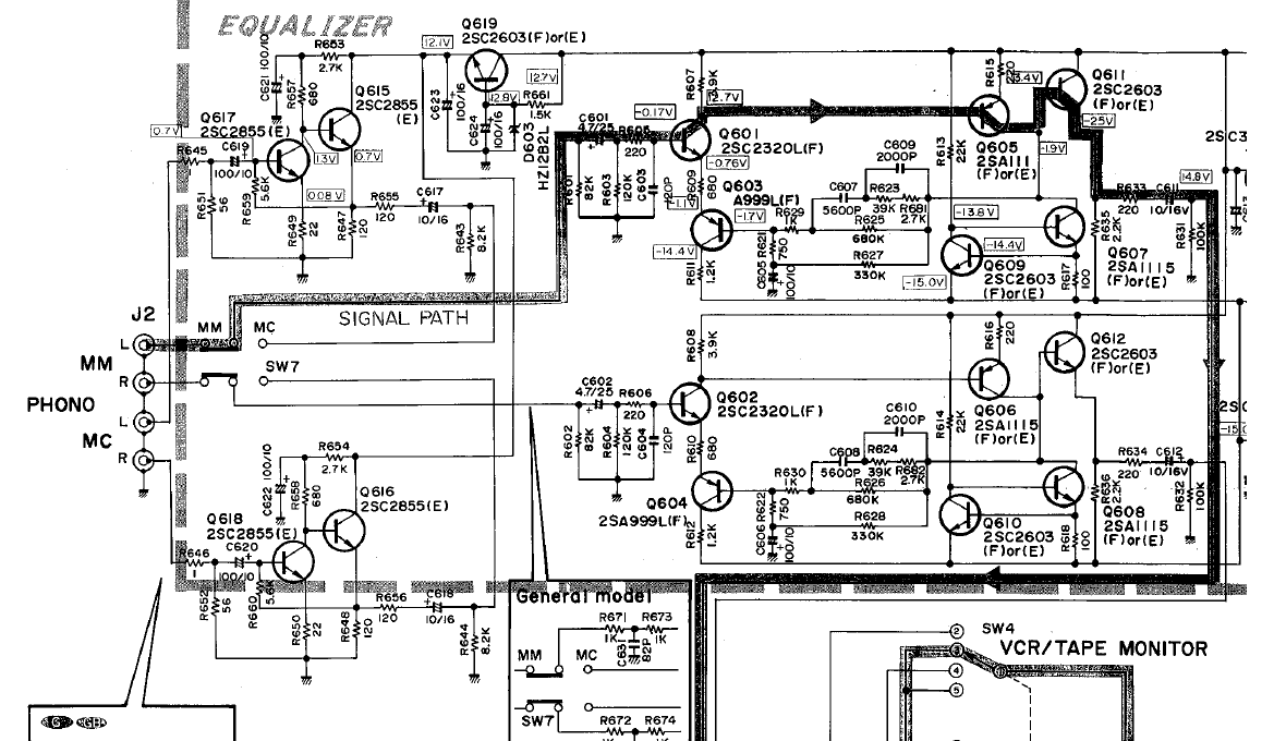

The schematic in post 98 is not exactly high res, and maybe i'm misreading it, bit isn't Q129/130 and associated components forming a cascode to avoid capacitive loading due to Miller effects?

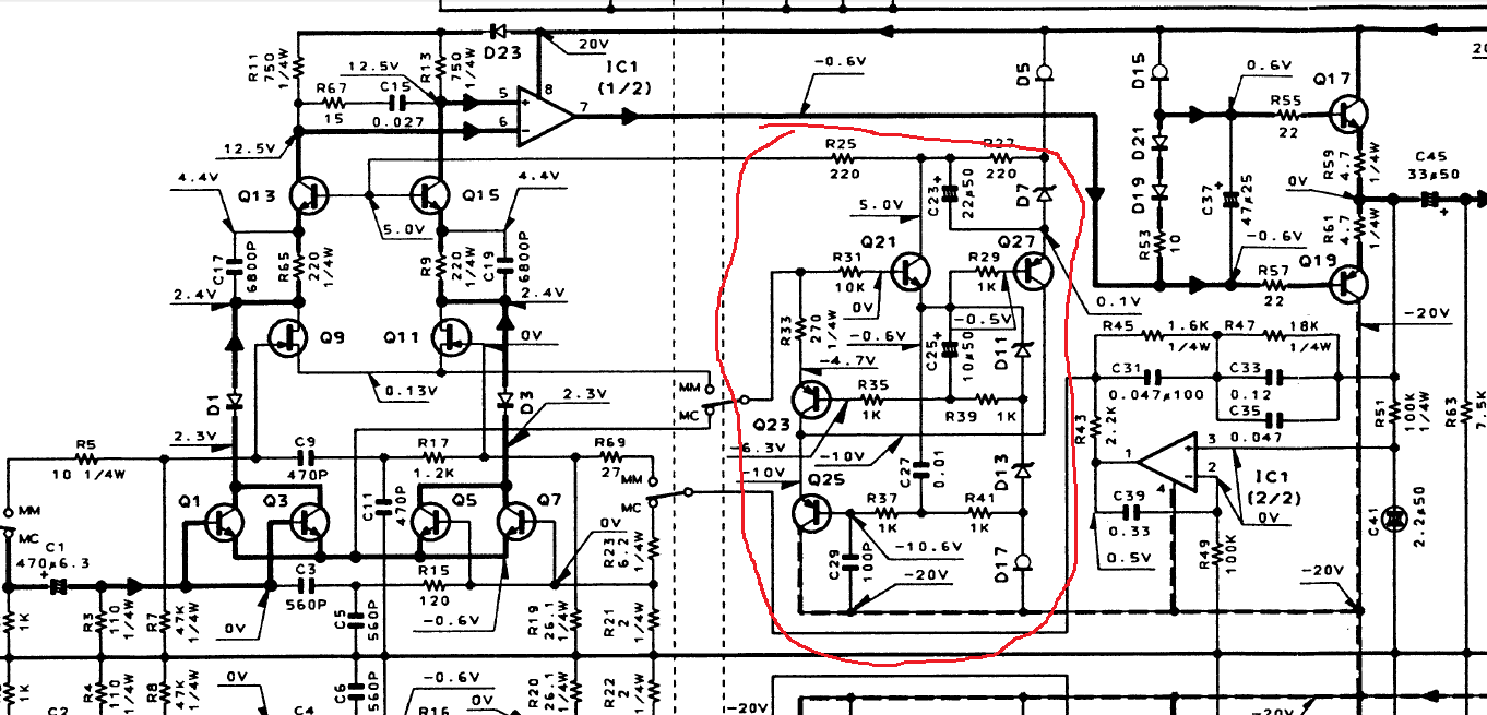

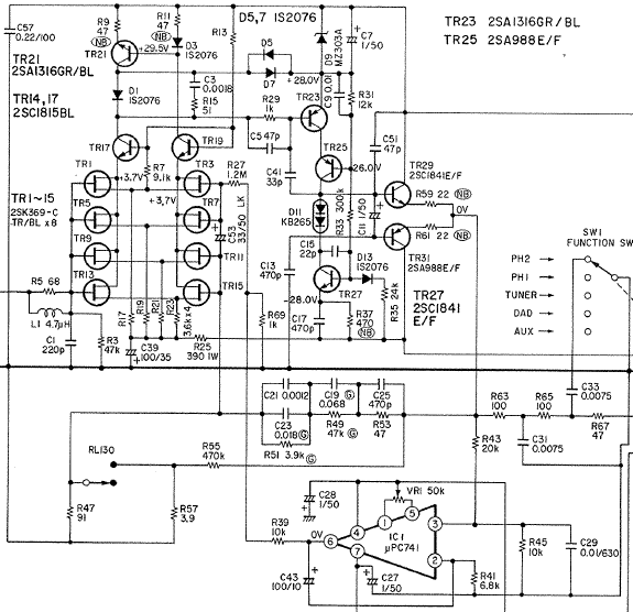

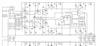

Attached is 2 more 80's examples of mid-end (Luxman 103) and more advanced (Denon PRA1100) JFET input RIAA solutions. The Denon is my best sounding RIAA so far, but unfortunately has one big drawback. Clicks and pops caused by surface damage that goes unnoticed on two stage solutions like Parasound P5 or REGA Fono-MM can be quite obvious on the Denon.

Well it happens that pra 1100 was the exact DENON preamp model i listened...It was fine , nothing wrong with it, but really boring...The cascoding concept was better explored in Kenwood L-02A, LA-1, kenwood KA-2200
2SK 369 has an input capacitance of 75pf, four of them in parallel plus the input cable capacitance will overoad the mm cartridge... Using just one pair of fet transistors for mm input makes more sense.

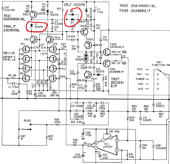

that is in the mm eq sectionThe schematic in post 98 is not exactly high res, and maybe i'm misreading it, bit isn't Q129/130 and associated components forming a cascode to avoid capacitive loading due to Miller effects?
You're the first one to talk freely about this effect in this topic so i need to Congratulate you because all the "ultra low noise" advocates are simply ignoring a very real and annoying aspect.This is why mainly valve preamps rule in the phono world!The Denon is my best sounding RIAA so far, but unfortunately has one big drawback. Clicks and pops caused by surface damage that goes unnoticed on two stage solutions like Parasound P5 or REGA Fono-MM can be quite obvious on the Denon.
In kenwood you have 2 sets of soft clipping diodes while in denon you only have one set.In denon you have also a higher gain first stage so i suspect that those diodes are getting hard clipping, unless TR21 -D9 combination isn't the killer one.I'd try changing Tr21 for MPSA18 or 2n3906 for their quasi saturation component which will make it loose current gain, but then D9 , a 3.3v zenner might need to be raised to 6v2 and there's a fine balance there...i'd try a simulation to see what can be improved there although some other guys might be better at that than me.
Maybe this topic will help you a bit by throwing the second cascode in the vas and replacing the whole topology with a Lender like VAS:

You have there a current feedback input stage. Cascoding the input stage of a fet input voltage feedback mm phono preamp is also helping with limiting VDS and thus the fet noise as you aready lose 3db due to the feedback pair while providing a lot more gain , but i wonder what happens with a low gain cascode when instead of a high Z current source feeding it you have a low value colector resistor resistor?
