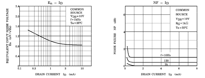

You might be right, i used the GR version, didn't have the BL or V one, but the minimum noise for 2sk170 is defined at 1ma in the datasheet .It may be like that just to include the GR specs....I did also try 2sk369BL too which is almost the same noise at 5x higher current(5ma)

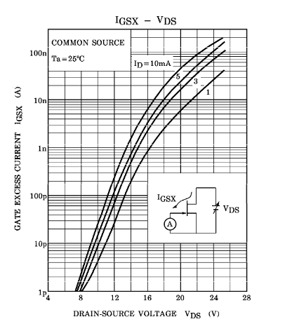

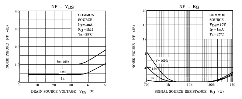

I don't see anything in the Toshiba 2SK170 datasheet that implies that a 1 mA drain current would result in minimal noise. The equivalent input noise of a JFET usually drops with increasing current as long as the gate-source junction doesn't go in forward conduction and as long as the drain-source voltage is not so high that you get excessive gate leakage due to impact ionization. The plots in the datasheet seem to be consistent with that. I guess that 1 mA is just a current that lies comfortably below the 2.6 mA minimum IDSS, but is still high enough to get reasonably close to the minimal equivalent input noise voltage density.

You need to know the conditions to interpret noise figures, a JFET with a noise figure of 1 dB at 1 Mohm source resistance would still be quite bad. Looking up the datasheets:
CPH5902, CPH5905 and NSVJ5908DSG5: 1 dB at 1 kHz, 1 kohm, 1 mA, so 2.0364 nV/sqrt(Hz) at 1 kHz, 1 mA.
IF3601, IF3602: 0.5 nV/sqrt(Hz) at 100 Hz, 5 mA.
All very well suited for moving-magnet amplifiers, although the Ciss of 300 pF typical and Crss of 200 pF typical of the IF3601 and IF3602 could be problematic; depending on the circuit, the load capacitance that the cartridge sees could easily become too large.
