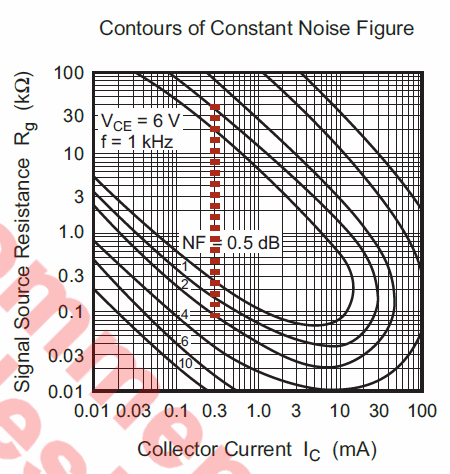

Or you could peep the published 2SC2546 noise curves. NF is 1dB or better from 300r to 35k.

That graph is for resistive sources, while an MM cartridge is mainly inductive. The optimum bias current is practically the same, the graph also shows that the optimum for 12 kohm is around 50 uA, but the noise figure goes up quicker when the source is largely reactive. Nonetheless, 300 uA collector current is small enough to ensure that the base shot noise doesn't dominate.

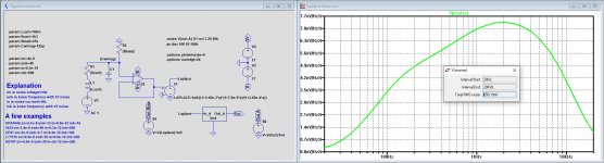

Just for completeness and out of curiosity, I simulated an Orto 2M Blue with an Utopian completely noise free Fet amp, having even no noise from the feedback resistor.
In that case the equivalent A-weighted input noise solely caused by the Cart is 552nV for a gain of 0dB@1000Hz.
With a reference of 5.5mV at 5cm/sec@1000Hz for this Orto cart, the A-weighted S/N is 20*log(5.5mV/552nV) = 79.97dB(A).
Publications very close or even above this figure are simply based on wrong measurements.
Hans

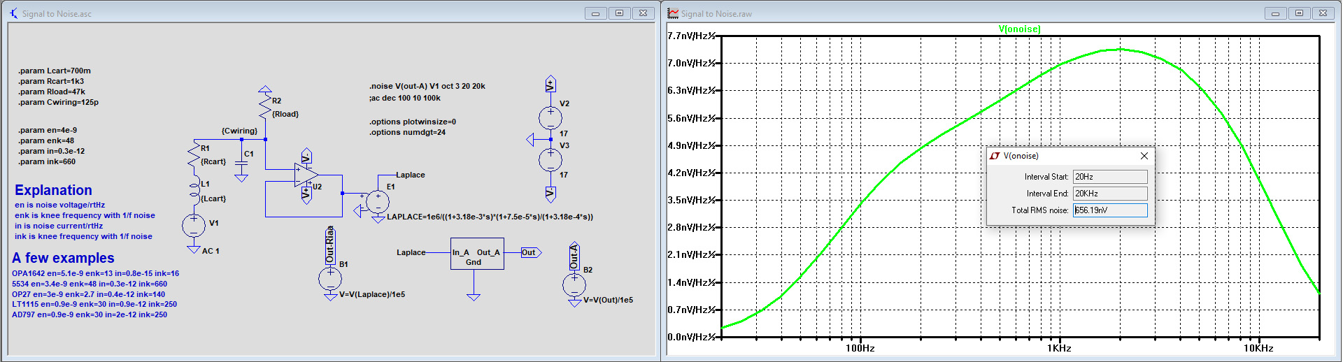

I just took the good old NE5534 bipolar op-amp with 3.4nV/rtHz, where I added some additional noise for a 50R feedback resistor, adding up to 4nV/rtHz.
With all the relevant voltage and current noise as visible in the model below, I get 656nV A-weighted RTI, calculated with a gain of 0dB@1Khz.
S/N is now 20*log(5.5mV/656nV) = 78,5dB(A) for the Orto 2M Blue.
That's only 1.5dB away from the unobtainable 79.97dB(A) limit.
Both OPA1642 and OPA1652 also with the added noise of a 50R feedback resistor, scored 640mV.
The OPA1642 has a somewhat higher voltage noise, but a much lower enk of 13Hz versus 700Hz for the OPA1652.
That brings the A-weighted S/N for both Fet opamps to
20*log(5.5mV/640nV) = 78.6dB(A), exactly a marginal 0.1dB better as the NE5534.
So I don't understand all the fuzz about Fet's being far superior in S/N.
I would personally take the OPA1642, just because the design is much newer.
Hans
