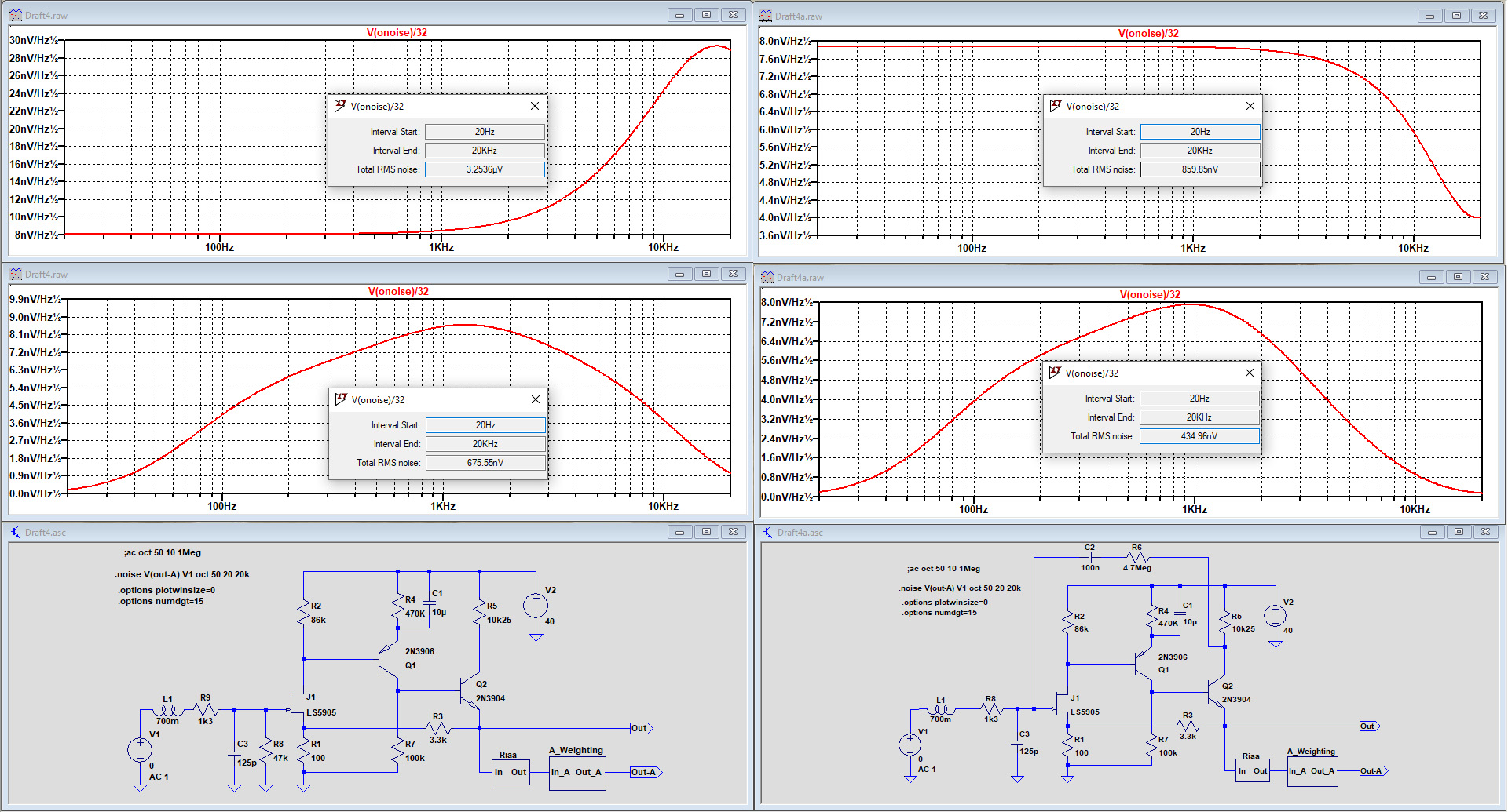

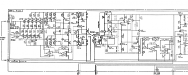

Always happy to review things with LTSpice, I took the circuit diagram that Marcel showed.
Unfortunately I could not find a model for this Fet that has a very high ca. 14nV/rtHz at 1Khz.
That's why I used a 6nV/rtHz Fet, the LS5905.
One version with a 47K at the input and the other with a 4.7M driven from a point that's -99 times the input signal, thereby simulating a 47K input load.
I have simulated both flat in the two upper images and Riaa processed and A-weighted in the two middle images.
Flat gave resp: 3.25uV and 0.86uV from 20Hz to 20Khz, a bonus of 11.5dB for the "cooled"version.
However for a Riaa preamp, flat noise figures without Riaa do not give a proper indication for perceived noise.
That's why I also measured the Riaa processed and A-weighted noise, that came out as resp 675nV and 435nV, which is an improvement of 3.8dB for the cooled version, still nice but quite a bit different from the earlier 11.5dB.

It will drop further when you use a cartridge model with frequency-dependent ESR. I once estimated a 3 dB best-case improvement for a Shure V15-III cartridge; that would be the RIAA- and A-weighted improvement when there is no record playing and the thermal noise from the cartridge and from the 47 kohm were the only noise sources. That is, the 47 kohm gave about as much RIAA- and A-weighted thermal noise as the cartridge.

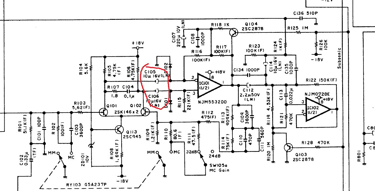

I’m glad to see that you brought up the input bias current issue with BJT inputs. This has been talked about Walt Jung and Marshall Leach as the current can negatively affect the phono cartridge. Some BJT input designs use a cap on the input to couple to the cartridge to isolate the bias current. When using a JFET or tube as a input stage we do not have to be concerned with the bias current, and both will be less affected by RFI that a BJT input.
In the 1977 Marshal Leach published an article in Audio magazine on a low noise preamp that used a bJT input and later modified the design to use a fet input. He sold these preamps as a kit or assembled and I bought both preamps. I can't recall that I noticed any difference in the noise. Then I had a Shure V15-4 cartridge.

"cooling" with negative feedback works very well. Just got an AT-VM95e cart that I am going to make a flat front end stage for. I am expecting MC cart flatness and response.
Yes of course, it is highly dependent on the Cart used.
When I change the Orto 2M blue for a Shure V15-III, gain from this circuit over a non cooled version drops to 2.6dB.
But at the end, it is mostly an intellectual challenge that is not needed at all, unless a much lower termination as the 47K is used.
In that case it will enable to recover the caused losses if necessary.
Hans

Another way to look at this is the 47k load resistor is shunted by the series combo of the cart resistance plus its L. At LF the preamp sees the cart R in parallel with 47 k load R. As frequency increases, the L increases and the total source seen by the preamp increases so at 20 kHz, it can be 10-15k Ohms. You have three noise components: noise voltage of the amplifier, noise current x source resistance and finally thermal noise contribution of the resistive part of the cart. All these sources add up RMS style for the total equivalent input noise.
With a JFET input pre, there is almost zero noise current, only noise voltage, unlike bipolar where the noise current can be quite high. So the noise current x the total source resistance part effectively is not there and this is why JFET input stages make good MM phono preamps provided the noise voltage is low - there are some very good devices in this regard like BF862 (discontinued now) and LSK389

Input shorted and ‘A’ weighted is not the way to test a phono preamp - and especially MM. A modern MM phono pre with the input shorted and ‘A’ weighted is about 10 dB better.
You absolutely cannot judge a phono pre’s performance with the input shorted and especially on MM.
The only sensible reason to do this (which I do ) is to look for mains noise components which with a cart connected would be buried below the noise floor on the decent design.
These old Japanese amps were great products, but we can do better today.
