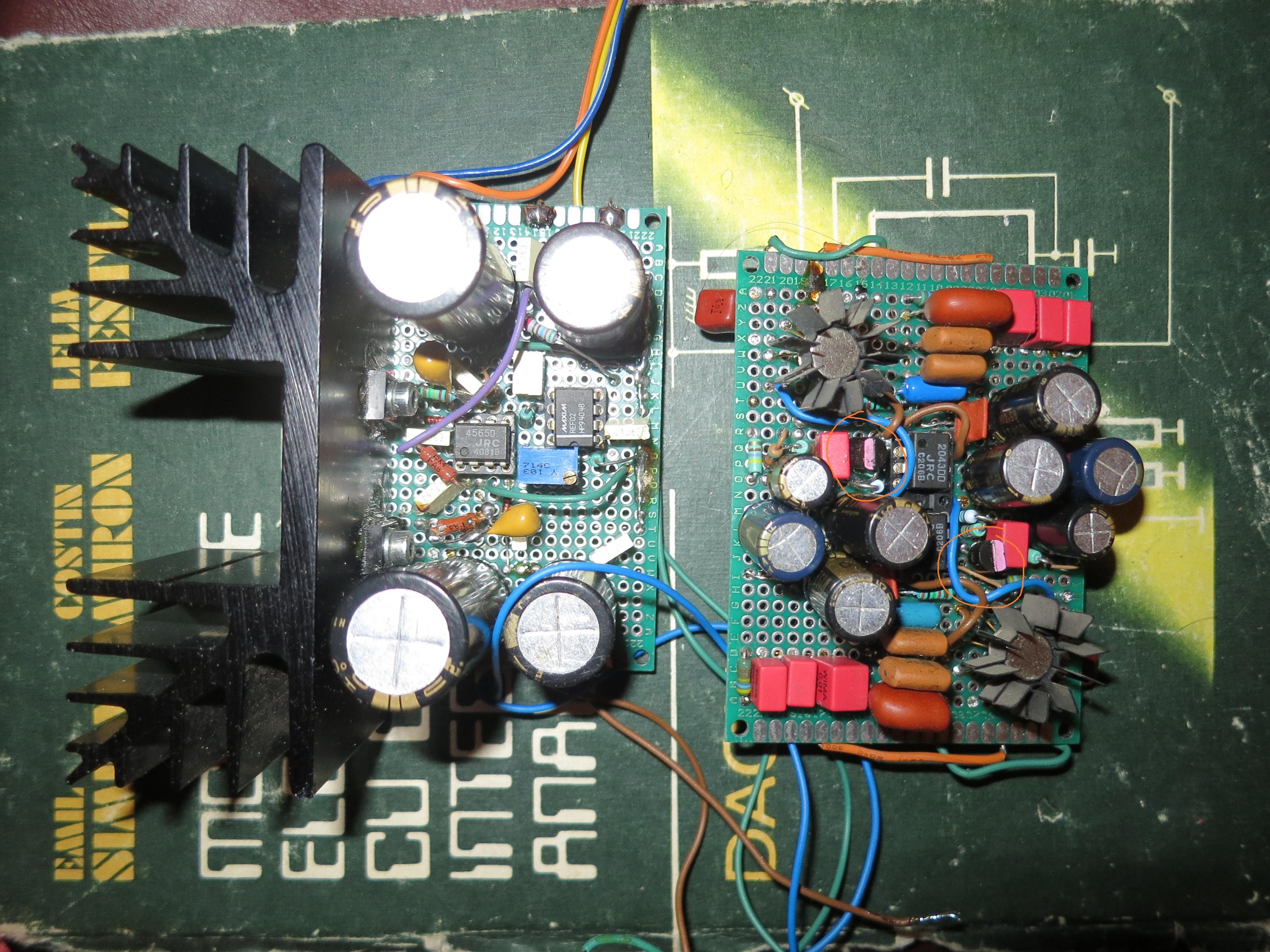

With a 2sa1038e(whch i am going to use soon in one of my preamps) which is having a HFE =600 working at Ic=700ua(0.7ma) that should not be difficult at all...i'm just remaking the AIWA c22 preamp supplied at +-20v with some modifications that should hopefully work and chose that transistor just to see if it's any better than the original 2sa991...I made this choice after comparing the j-fet stage used in marantz pm62 (supplied at +-18v and modified back to the original technics su-v6)with the aiwa and the noise wasn't the issue, both preamps were equally silent, but the bipolar input aiwa although supplied at +-15 behaved way better including on dusty records where the technics collapsed completely at 33rpm.Only when hiting the 45RPM the Marantz j-fet preamp sounded right with noise so it must be something about the way it clips as at 45RPM the S/N ratio the distortion pattern can be hidden. Aiwa was the best under all circumstance and i know what i'm talking about because my standard is still a d3a preamp able to reproduce perfect square waves up to 25khz through the antiriaa and riaa filters with very faint hum only when the cartridge wasn't connected to the input.

Honestly, if would have been more pleased with the fet version which is pretty close to Vogel version i would have gone with it, but this is not something i do for sale, is smth i do for myself using the best resources i can think of(2sa1038 are the pink painted transistors circled with orange in the photo).They are having that pink paint from the factory .I also have the usual 2sa1038, but these are the best low noise transistors i could ever find.

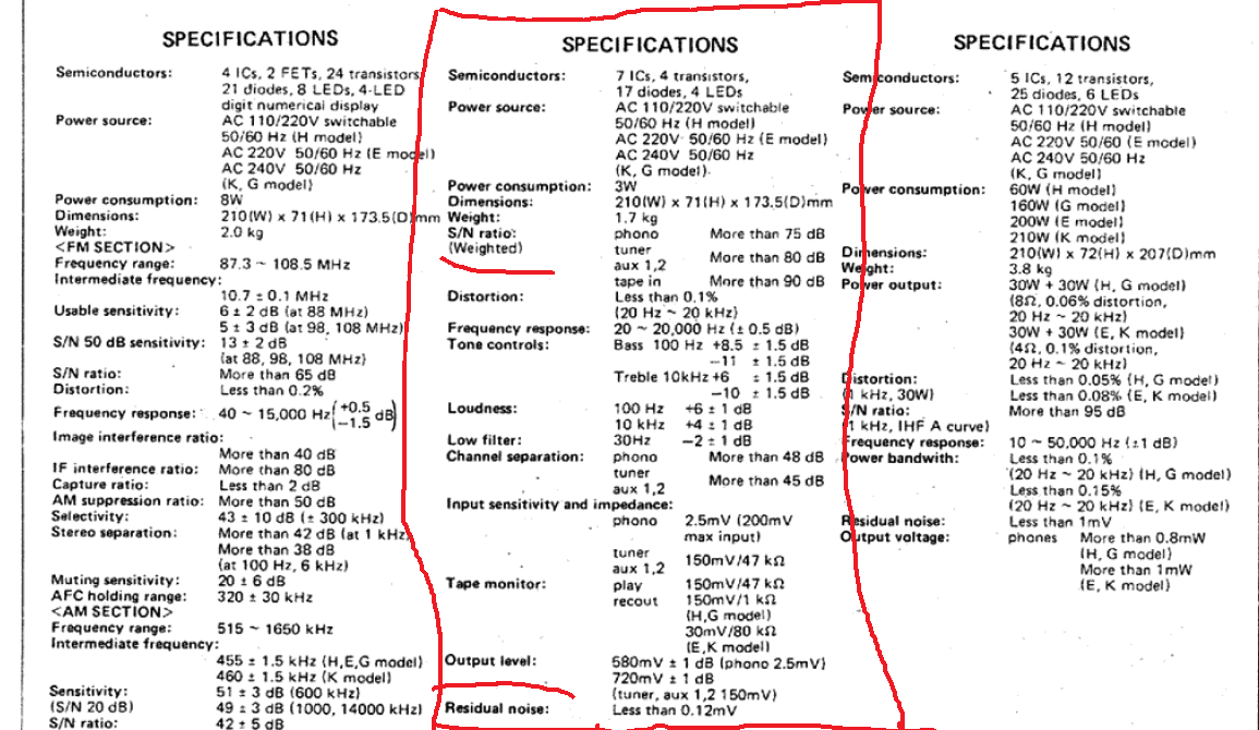

700 uA is way above the noise optimum, even with hFE = 600, but the effect is still not dramatic.
With 700 uA collector current and hFE = 600, the base current is 1.1666... uA and the shot noise associated with the base current is approximately 0.61143 pA/sqrt(Hz). With a 500 mH cartridge at 3852 Hz, that will have about the same effect on the total noise as a noise voltage of 7.4 nV/sqrt(Hz).
However, when the 47 kohm termination resistance is made by simply shunting the input with a 47 kohm resistor, the effect of its thermal noise is in the same ballpark. The thermal noise of a typical cartridge is also of the same order when you take into account the frequency dependence of its resistance.
All in all, assuming no electronic cooling of the 47 kohm termination, the noise floor with no record playing will increase by at most 2 dB(A) compared to a similar amplifier with optimal input transistor collector current. With a record playing, the difference will be much smaller.
Records noise is around -70db.Unless i'm deaf i stand that i couldn't here any noise at all when not playing anything.Here's the original specs of the aiwa preamp , in the middle and it was a mini combo system.

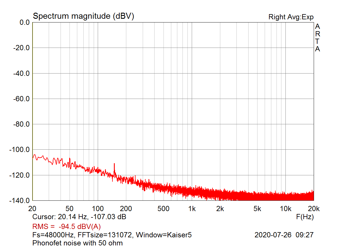

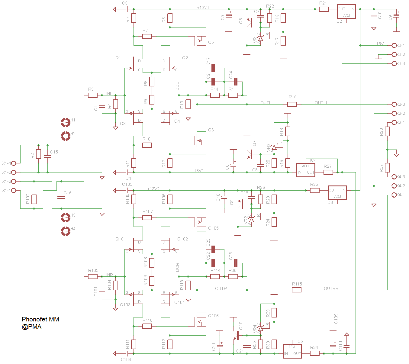

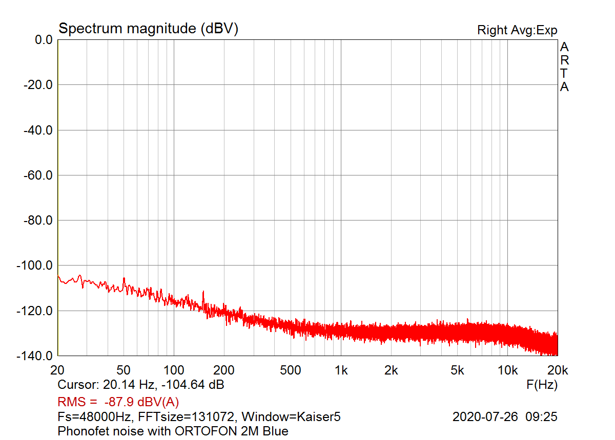

Please let me demonstrate the effect of MM cartridge to output noise of the MM preamplifier. The preamp is my Phonofet with JFET input. Measurements are made at the preamp output. Input of the preamp is shorted by 50 ohm and in 2nd measurement Ortofon 2m blue cartridge is used. Vrms measurement is calibrated and shown with A weight. Preamp gain is 36dB at 1kHz.

Yes, it is. And then put the cartridge on an empty groove and then we can see that we do not need to care so much about the preamp noise. It is only an engineering challenge 😉. In a real world of vinyl records, we can get S/N about 60dB(A).
So there's no solid proof of fet input being better than bjt input in the real world of phono preamplificatio which is a clar statement that expensive fet phono preamps are useless and that is all i needed to hear from you 🙂
Your graphs claim of having identical noise of the entire phono chain with the johnson noise of the cartridge itself at 1000 hz...
