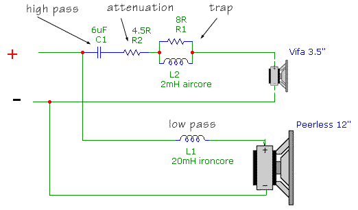

So, I got everything slapped together and nuthin' blew up. Ahh, first step completed. My son gave me a hug and thanked me for having music in time for Christmas. Of course, I put on some of his favorite music.
Later I didn't feel something was right and tracked it down (after being very careful the first time) and realized I had the full range speaker wired incorrectly.
I am very happy with the outcome but this is the first time I've ever made my own speakers rather than buy 'off the shelf'. I don't have any equipment to measure speaker performance so are there some clues as to what I should be hearing after swapping resistor values? The highs seem diminished from what I would expect, so my thought was to reduce the resistance of the default resistors in order for the highs to be slightly more pronounced. Is my thinking right? I admit I am very ignorant in this area. But I can say, for under $300, these speakers are crazy good! VERY pleased, as is my family.

Yes that's right. If you are building the crossover from posts 1601-1602 that have a tweeter trap included, you can do two things. Lowering the attenuation resistor will make the tweeter overall louder. Changing the trap resistor will have a more subtle effect, working on only part of the tweeter range.The highs seem diminished from what I would expect, so my thought was to reduce the resistance of the default resistors in order for the highs to be slightly more pronounced. Is my thinking right?
You can short out either resistor with a piece of wire or even another resistor to hear that the full effect is. That's a good way to hear what parts of the spectrum are affected and allow you to judge what changes you need to make.
It can take a bit of back forth.

Yep, that's the crossover I implemented. Thanks for the tips and confirming I'm on the right track! I am really enjoying the adventure. 🙂

Hi All - The Vifa/Peerless TC9FD is unavailable to me in my location. I can get the following from Fostex, what might be the most suitable replacement and could I keep the crossover design the same?

Edit, cant get the 20mH inductor either, but 18.0 and 22.0 mH are readily availale; which should I choose?

Prolle.... Sad to hear the TC9 is not available to you locally! Of the Fostex drivers you listed, the closest is the FF105WK. It will require a trap to damp out the peak that appears to be around 7,200 Hz. This driver is also a bit more efficient so it will require a higher value resistor pad. Which will have an effect on the high pass crossover cap value. What these differences mean is the TC9 crossover will not work well.
I think the FF 105 can work pretty well, but it will require some crossover work.
As for the low pass inductor, 18 - 22 work well enough. Not an issue there. If you do try the FF105, The 18 MH is a better bet. Wish I had better news. Best
