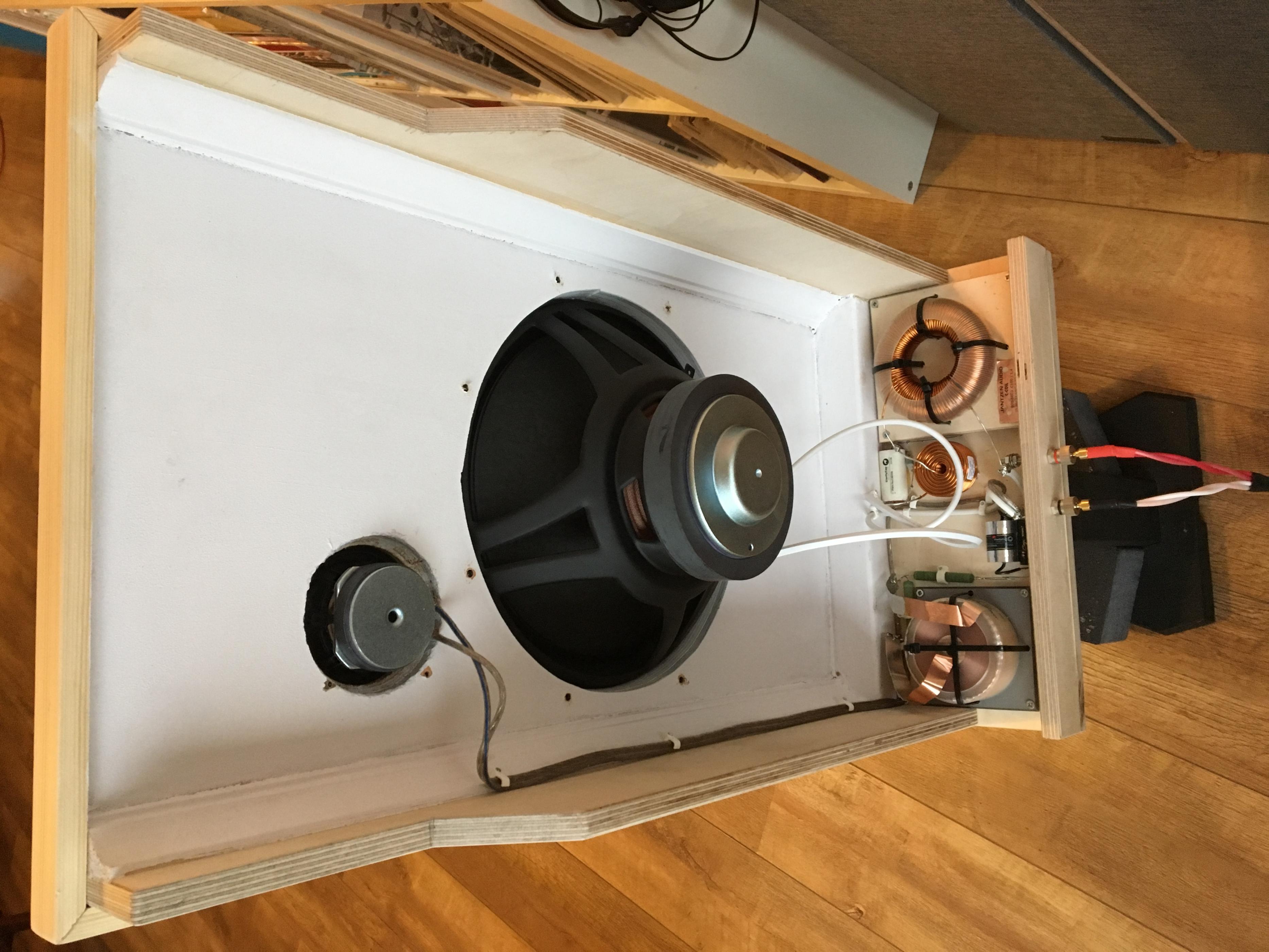

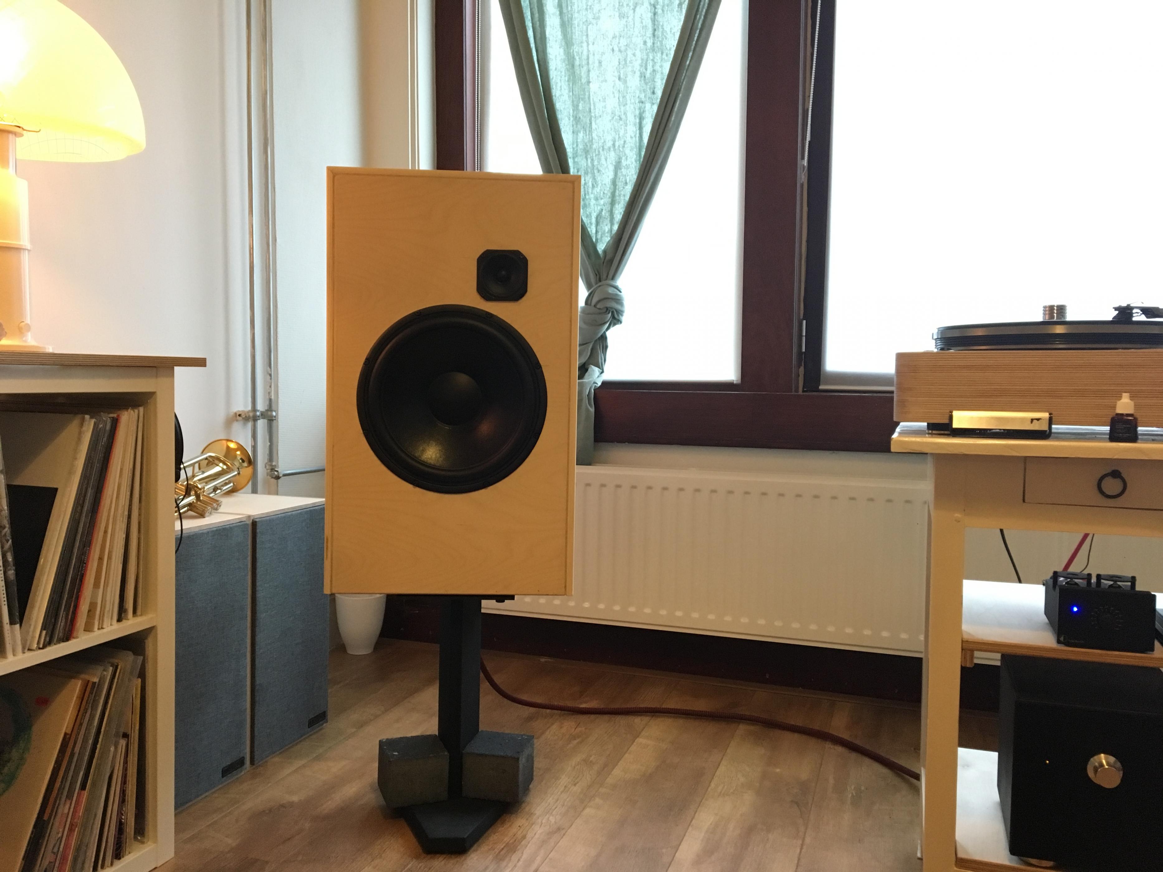

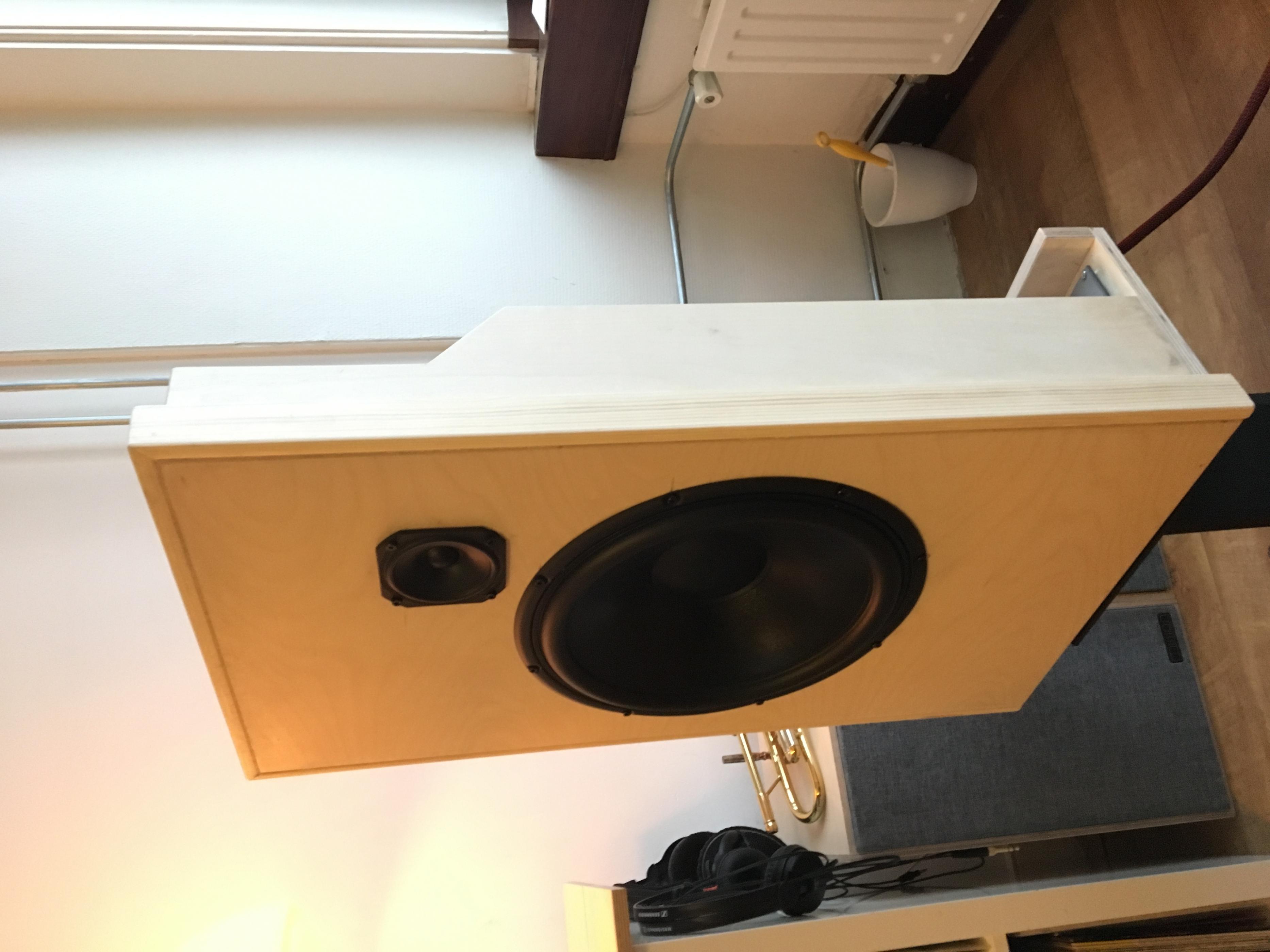

Up and running
Well i have them up and running. Except that the tonal balance sounds very promising i can not yet coment on the sound quality. Considering the huge coils i presume that it will take more than 100 hours of playtime until they settle in.
But here are some photos 🙂
Very nice build.
Give them a few days then start experimenting with placement. It can make a big difference.
How do you mean, the coils will effect how long it takes for the drivers to break in?Considering the huge coils i presume that it will take more than 100 hours of playtime until they settle in.
Nice build! Those are good looking speakers. Killer inductors, too.
I don't know if inductors take time to burn in but the capacitors and mid/tweeter change with some hours on them.

Boufos: Thanks for sharing info and pictures! Needless to say, the drivers will change and improve with time. How long can vary quite a bit. Sometimes just a few hours, sometimes several weeks. Does not seem to mater how they measure when new.
You may have a problem with the little Vifa rear reflections with it sitting down in the rear baffle well. This can lead to a peaky response in the lower treble. If you can, you may want to round the rear of the baffle cut out. If you do not have a router, you can use a wood file. A pain to do that way, but it can really yield improvements. Best J
Very good point. A chamfer, if you can do it, would be even betterIf you can, you may want to round the rear of the baffle cut out. If you do not have a router, you can use a wood file. A pain to do that way, but it can really yield improvements. Best J
Might be difficult to get down in there with a router, now that the wings are on. The tweeter is deep, opening up that hole some would help.
I have made the baffle out if 15mm baltic birch plywood sandwiched with 6mm HPL (High pressured laminate). At work we have a lot of scrap from these materials so i used some of it. To be honest when i glued them together I haven't noticed the part with the explanation about the backside of the mid-tweeter cutout being routed. But I did noticed it in later stage and that gave me some headache becouse the HPL plate is glued on the backside, maby it adds waight and stability at the baffle but it is a totaly not handy material to work it with handtools. Luckily at home i have a set of rotary grinder tools. I took a bowl shaped one and placed it on a electrical drill. It was a pain in the ... to do it, the result wasn't the most beautiful one but i did routed it 🙂. It's bowl shaped form and the angle of which i took the photo probably doesn't show it. Here will be a bit more visible i hope 🙂
