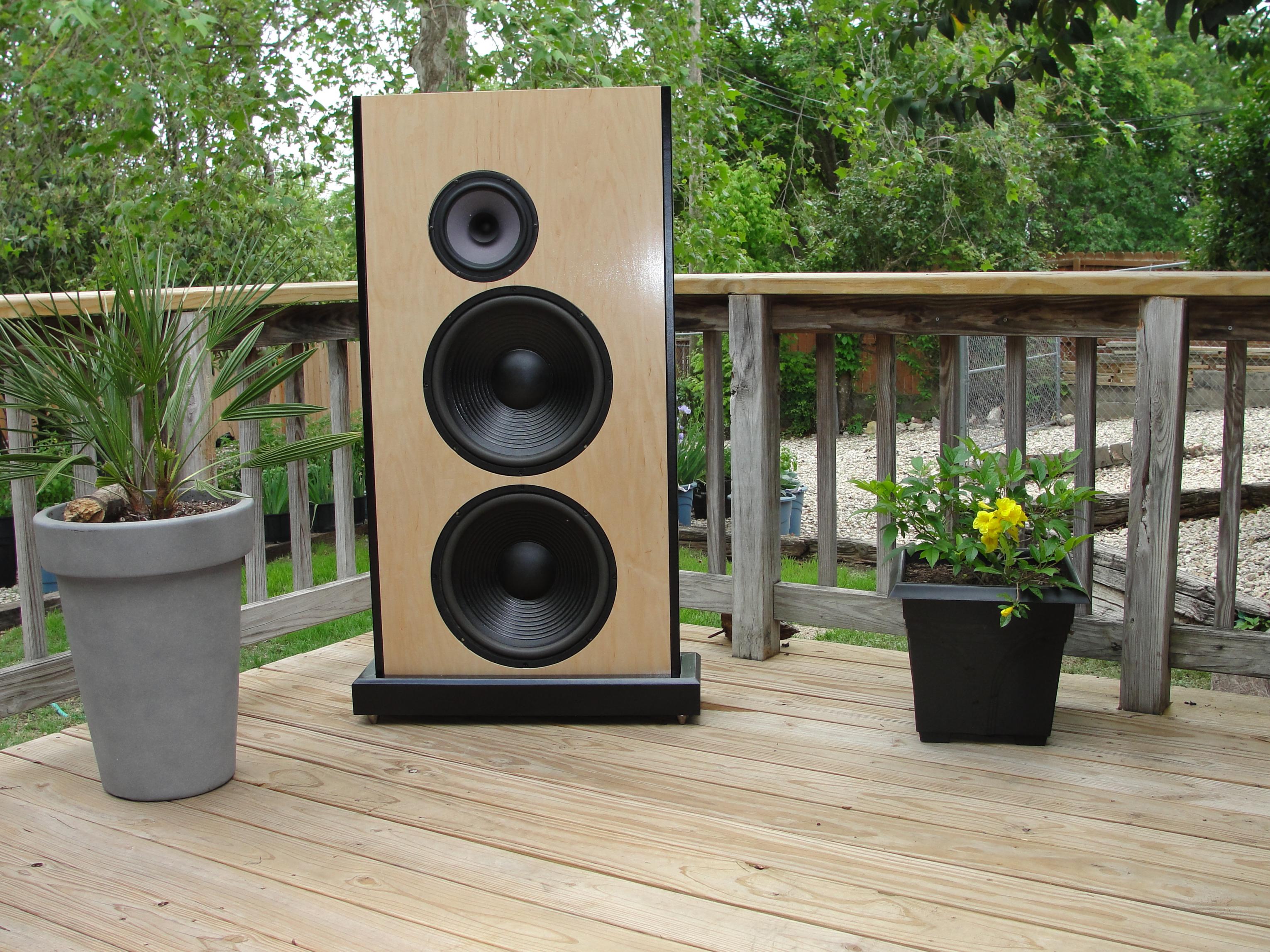

Manzanita Altra Plus OB speaker system
Built that combo for a number of years.... The Seas FR8 will require a pad. Great home theater as well as a very good audiophile speaker with the proper crossover. A pic from 2013. Not in production at this time. So basically a concept picture.
