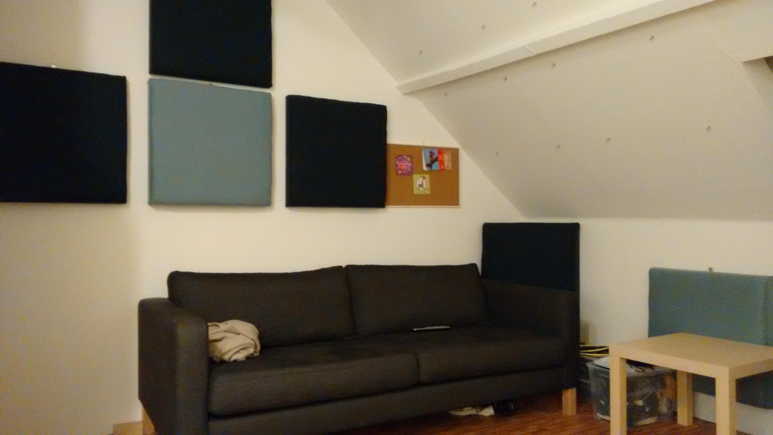

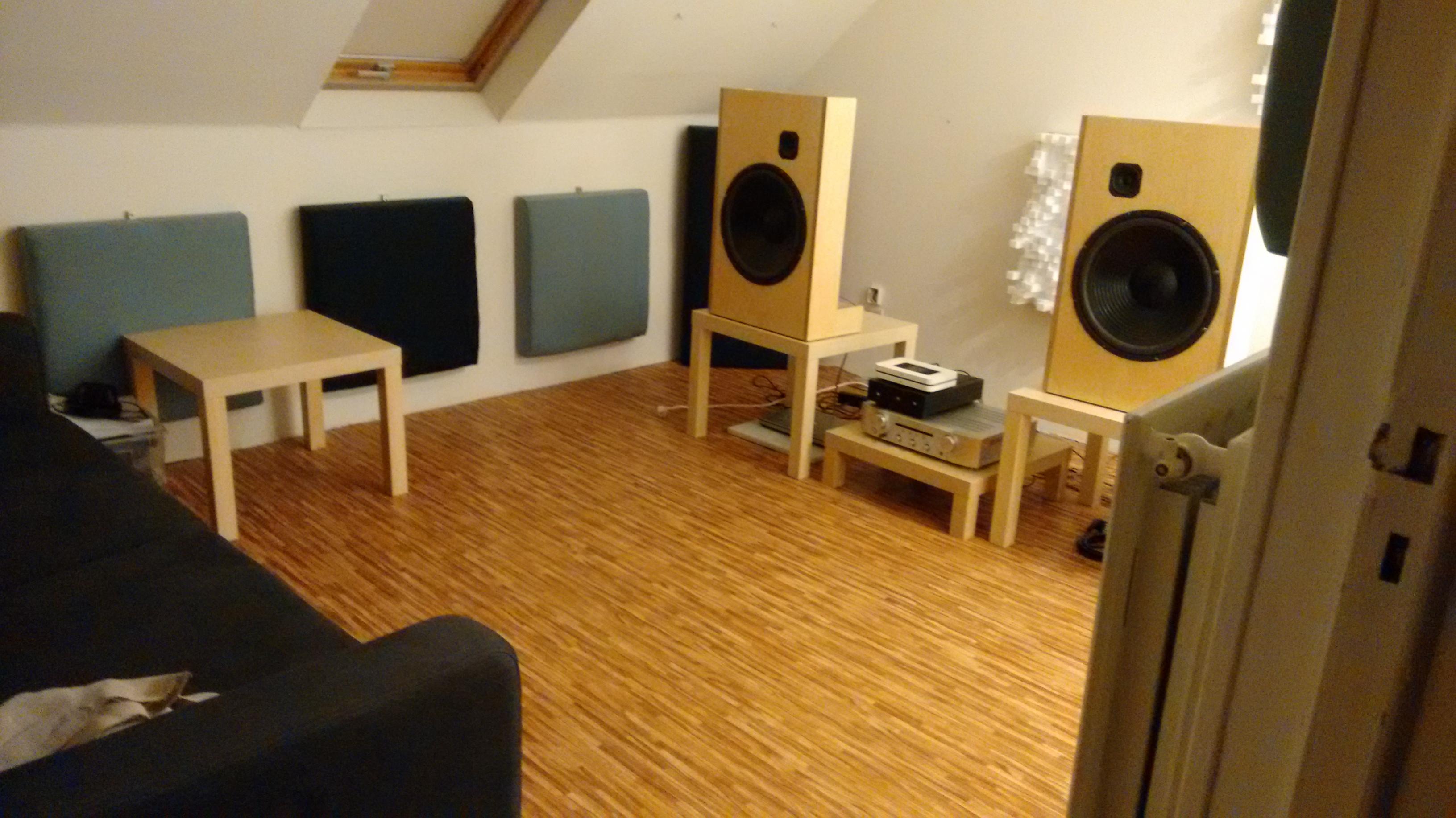

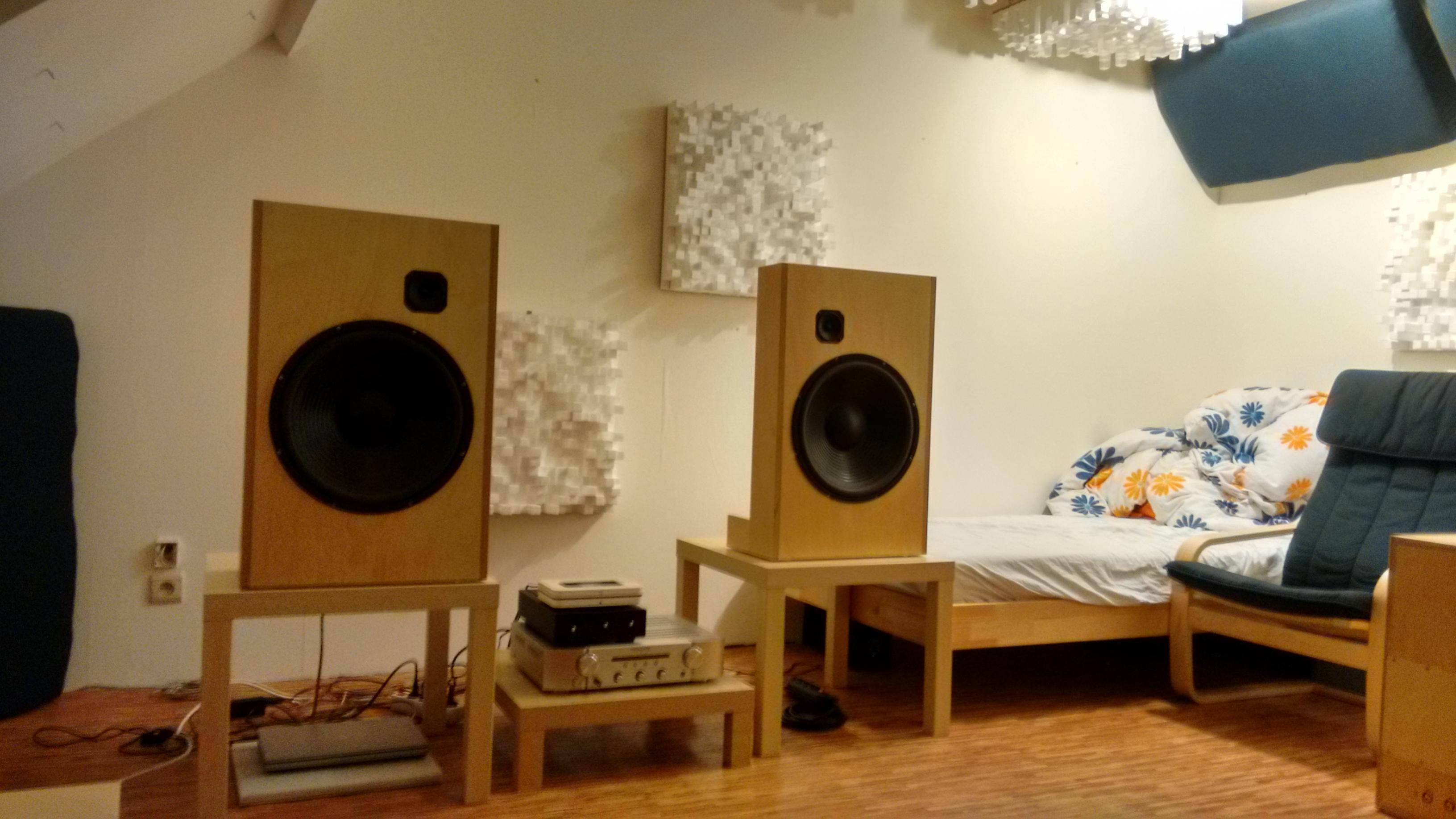

I finished my manzanitas 6 months ago, but I was not happy with the response in my room.
I did extensive acoustic treatment (4 big bass traps, diffusers on the ceiling, diffusors and absorbers on the walls), changed the speaker placement, upgraded my electronics (better streamer, bluesound node 2). Now they sound very good.
Looks nice, we also found that moving them well into the room made a big difference, so that’s another thing you can try if possible.
Nicely done, good job on room treatment. Thanks for the pics!
Do try pulling them away from the wall a bit, and maybe more distance between them. I used to put them near the wall to make room, but pull then out farther for serious listing. They are light enough to make that easy.
Hey John,
Yes, we moved the speakers far out into my parents living room the next day and that really made them shine. Big, spacious soundstage with lots of detail and nice tonal balance. My dad is very happy with them, and i would be too (if i had the space for them)!

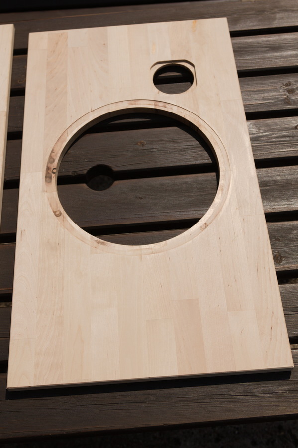

I came right back to a busy work week so i only just had time to sort through the pictures and pick out some good ones (see below):
The first challenge (after getting the wood cut by our friendly neighbour for a few bottles of wine) was to figure out the rebate to flush mount the Vifa. After some experimentation i think we managed something decent
Finished baffle. I decided for a relatively shallow rebate to fit the edge of the woofer (which curves down towards the outside). A mm more would also have worked. Note also: don't try to route 18mm beech in one go, you will break the bit 🙂

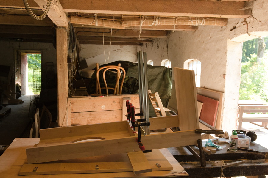

Gluing up. We decided to use both screws and glue, and i think that came out nicely and quite discreet.

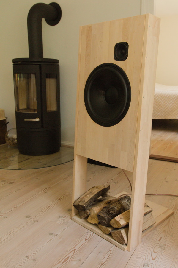

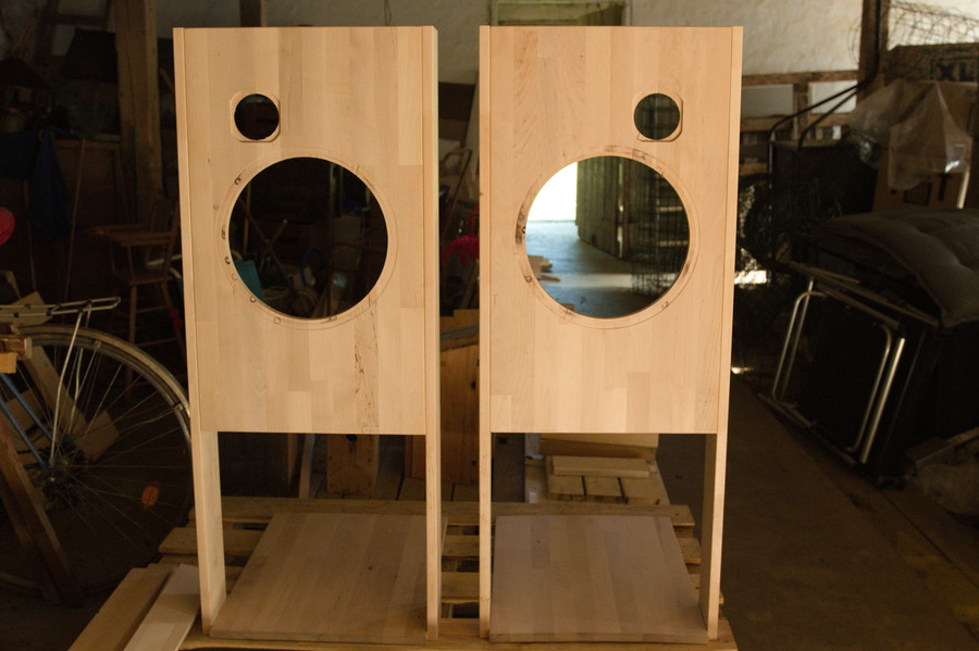

Finished the wood part. We made the base extra long as we didnt know where the centre of balance would be exactly. 20 cm could easily be removed as they are very sturdy.

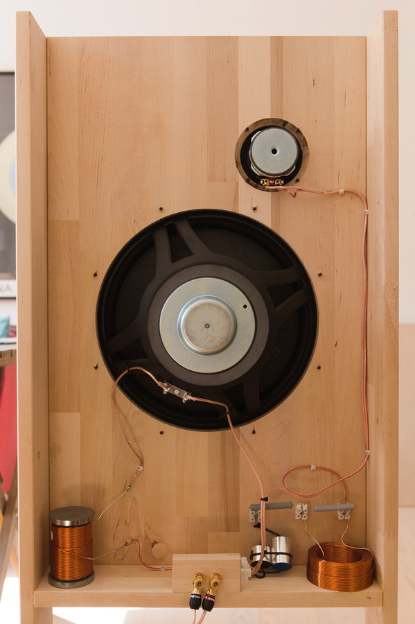

finished speaker with crossover and drivers mounted. Caps are claritycap esa. I couldnt get 6 µf so i paralleled 5.6 and 0.33. I also bought another 0.33 which can be added later if needed. The coils are Jantzen.
Right speaker. As an added bonus, the base also serves nicely as a shelf for various household or decorative objects for added WAF (or a monoblock, for reduced WAF).
Left speaker, WAF-modified. We did a small 1mm profile on the edges, which adds a nice line that frames the baffle.
All in all i think they have come out quite well. The wood was cheap 18mm beech intended for shelving (around $20-25 for 1 piece 40mm wide and 2m long). They were not the most square or even (some were a bit wider), but that was sorted out nicely by our neighbour in the cutting process.

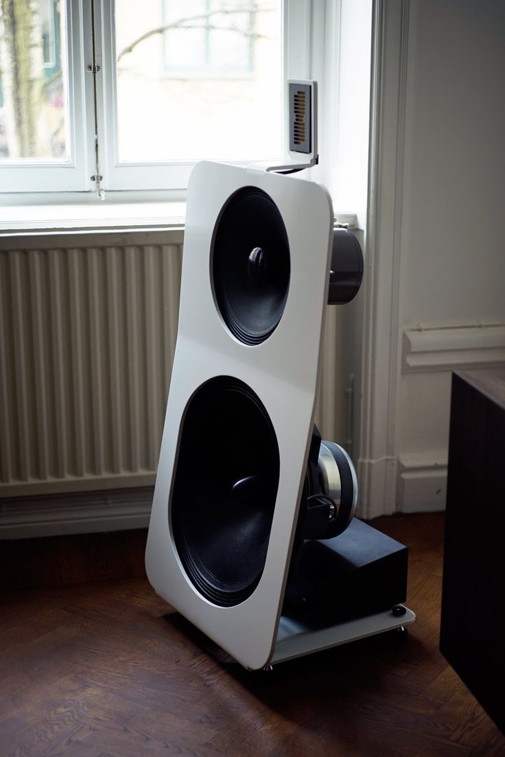

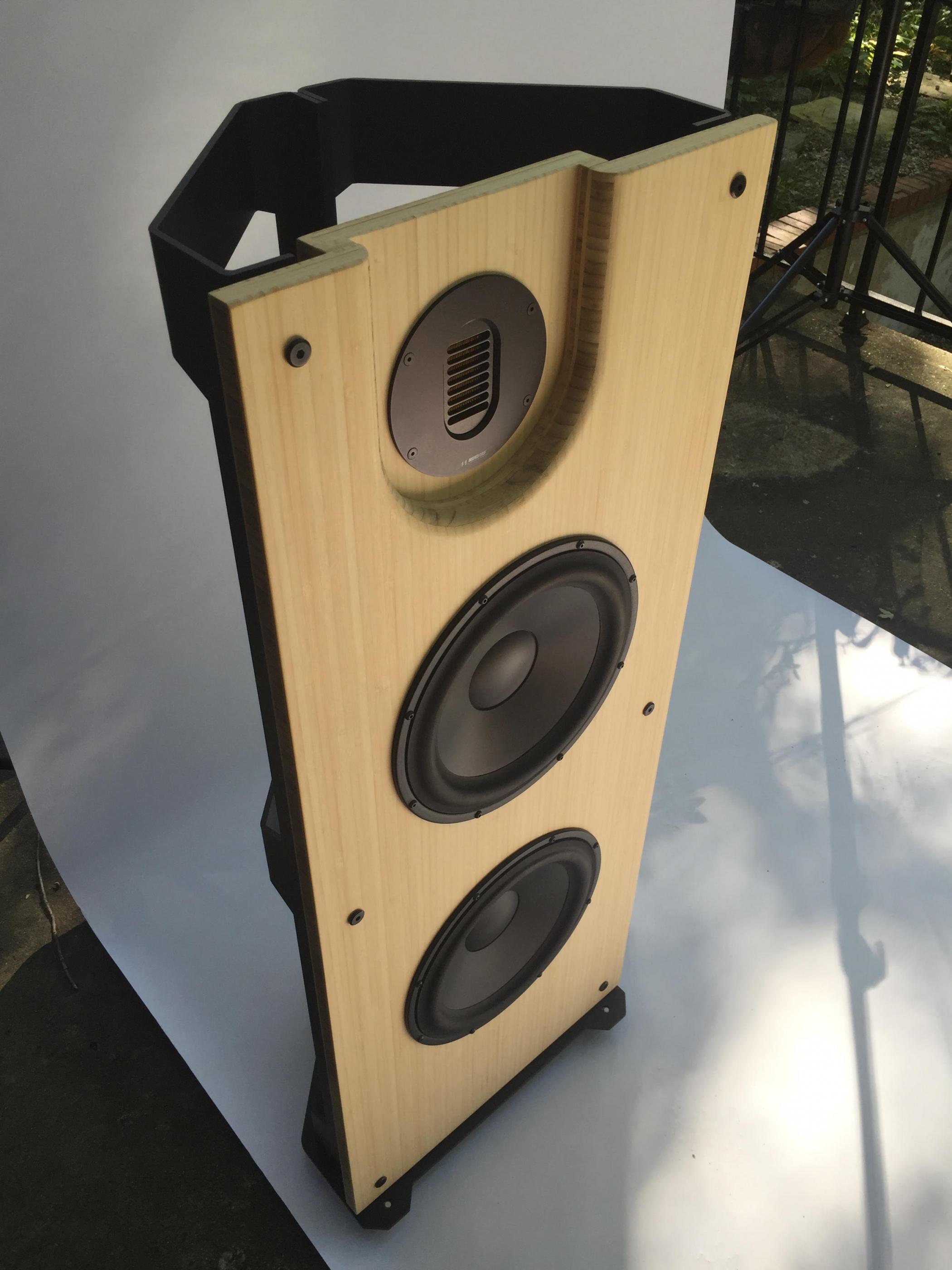

This project is very alluring! Has anybody attempted to build a time coherent version of this speaker using a stepped or sectioned baffle to align the acoustic centers of the drivers? With a cone tweeter I imagine that it would be folly to simply tilt the entire baffle back...
Something like this maybe, without the ribbon floating above.
I did some searching in the thread and found the post where Klarskov reported on using DSP to delay the Vifa by the equivalent of 5-6cm. It was a slight improvement to his ears.
Is there a reason that the tweeters should be mounted asymmetrically towards the center of the listening position rather than nearer the outside edges, where they would be farther from the listener?
The drawback is stellar interferences!
It would be much better with U shape upside down around the bigger driver .
+1
Troels Gravesen thinks so, too.
Stepped Baffle Study
Maybe I should try for this style OB.
Can any Manzanita builders comment on how this might affect performance and if the crossover will need tweaking?

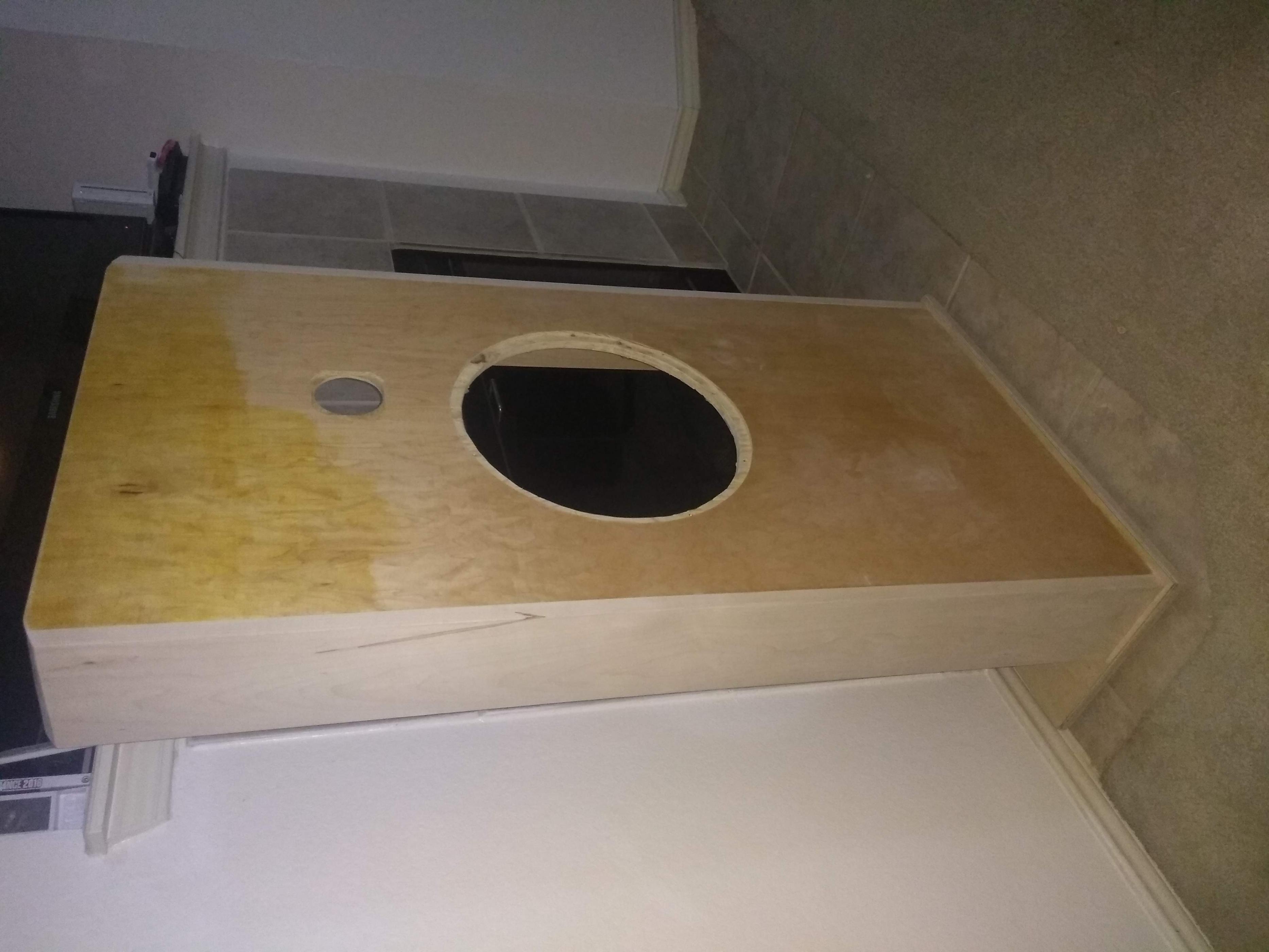

Oh sooo close. This was last week before putting on a layer of finish. 2 more layers to go and they're done. The other is hanging out in the garage.
I rounded the top edges slightly for aesthetics. I don't have to worry about any WAF issues. The wife is very happy with the way these are coming along.
Looking good and suspect you are having some fun too! It will be interesting to learn what you think of the design once you have spent a bit of time listening! Look forward to future posts! Happy holidays!
