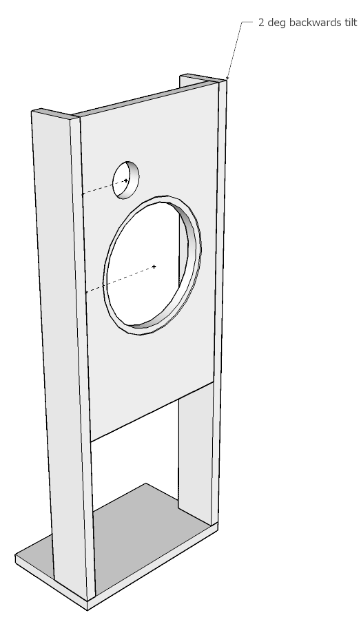

Here is a quick drawing of the planned build. Comments welcome.
I made the baffle slightly wider than 15", but i was wondering how wide a baffle can be accommodated without having to make major changes to the crossover? This is purely a question from convenience, since we are planning to use tabletop wood for the baffles and these tend to come in widths of 62cm or more...

silasmellor.... Thanks for posting the drawing... Should work just fine... you can add an inch or two to the width to add a touch of efficiency... The main thing is the woofer is up off the floor and the Vifa is at a typical listening height for a seated listener. Please let us know how things turn out for you.

John, thanks for the feedback! i since added wings, which is another two inches. Will build them next weekend and report back 🙂 looking forward to it! The thrill of the build...

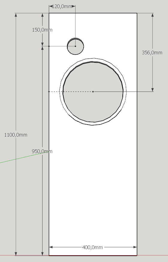

Hey again, last question before i post build updates, promise! After some back-and-forth about the wood choice, we found some nice-looking glued laminated wood boards. However, they are only 16mm thick. Can this work or is it too thin for proper rigidity?
The design we ended up on was this:
attachment.php
The wings should help in bracing the baffle, and there will also be a shelf at the bottom on the backside that will be glued to the wings.
What is your take on this?
Yes, the foot will be sorted once we’ve got the baffle assembled with the wings, it’s a little hard to assess the balance of those things. I suspect it will need to be considerably wider, like you say.

Didnt read it all but since it is a LR2 crossover, is it a good idea to mount the tweeter at the back of the baffle? Front baffle would need a kind of waveguide opening in the baffle for tweeter (and the woofer mounted on the front).
So tweeter and woofer are(better) time-aligned and tweeter would not have any breating issues at the back.

I'd also extend the baffle to the floor, why not?
For reasons of better sonics and floor bounce, that's why. The Manzanita has a better balanced bass with the gap between baffle and floor. It's part of the woofer, the baffle size and a few other things. John can explain better. We've had the discussion several times over the years, and there is some of it here in the thread.
