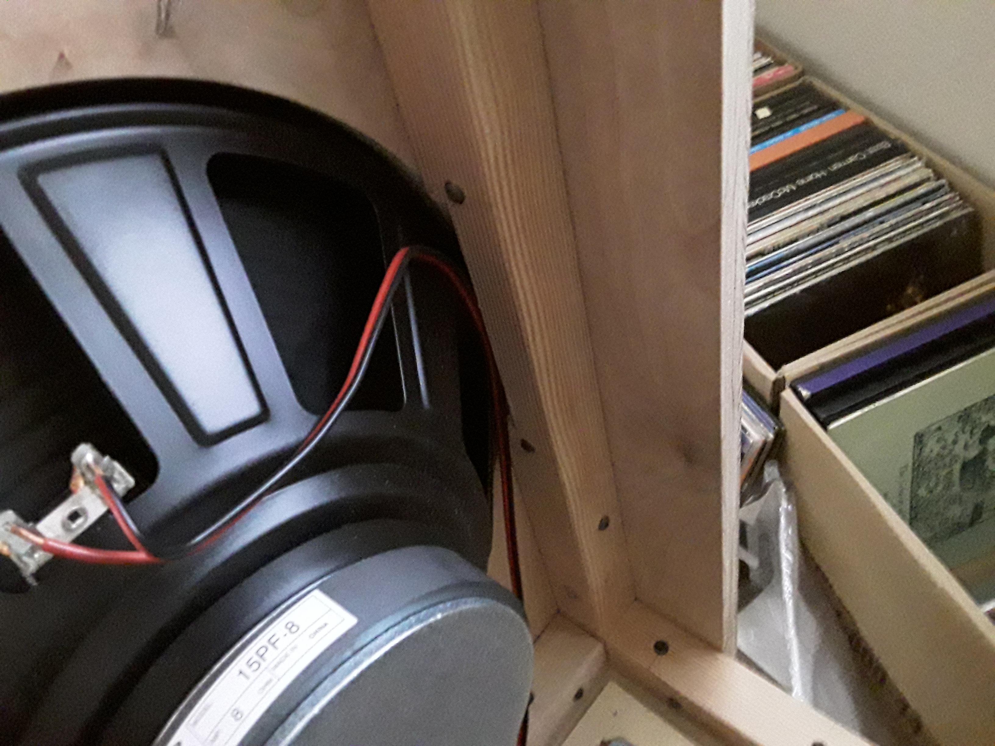

15" woofer clearance issue - as I put finishing touches on standmounters with GRS woofs (doesn't seem to have an actual name?) I was surprised how much relief was needed to clear the lateral back sides where they interfere with the 2x2 reinforcements. I chopped out a big chuck with an oscillating saw.
I cut the baffles at 15.5" wide, so with sidewings the front surface is 17". Rear clearance is as a result 15.5", but where the woofer basket installs, width is only 12.5 (subtract the actual 3" for 2 reinforcing 2x2s).
The fact that no one seems to have commented on this has me thinking the baffle should be 17" plus 1.5" for sidewings.

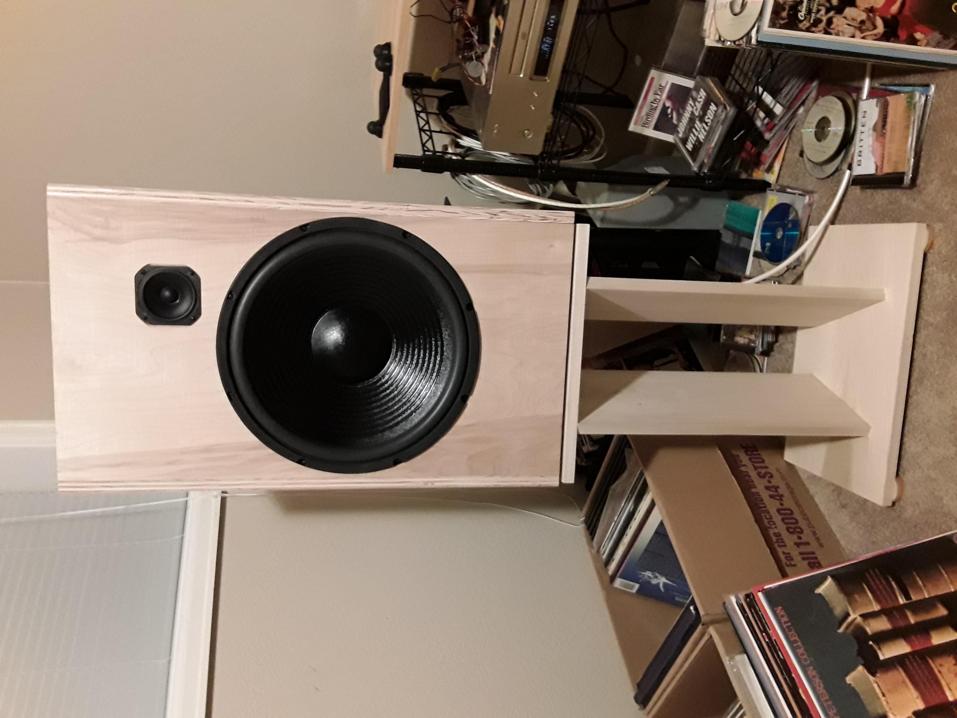

My Build So Far
I have essentially completed what I hesitantly call a Manzanita Non-Ultra CV - GRS woofer on 17" baffle. I started playing it with the standard crossover values posted for both Peerless and GRS versions with HF attenuation 4.5Ohms, trap resistor 8.0Ohms, and have made some adjustments to those to get the Vifa a little less glaring and better integrated. I do wonder why the Ultra crossover uses significantly larger resistors for both positions. The much larger baffle increases the low end output, so I would expect the main pad would decrease and the HF trap remain much the same.
And following up my post above is an image showing the half-inch chunk removed from the 2x2 support to clear the woofer basket. Not really an issue, but it suprised me since no one seemed to have mentioned this requirement.

Hey all -
Many resistor changes and a few capacitor tweaks have come and gone, and 22" poplar stands are in use. Burn-in is on-going, my own perception is no doubt altering, too. Speaker positioning in my small room is still progressing.
The Manzanitas are just flat starting to sing! I was begining to have some doubts, but resistor values began to gravitiate from the values in post #1601, same as for Peerless 12" design, to those shown in post #1602, for the Ultra with GRS 15". I don't want to waste energy figuring why this might be the case, I'm just really happy to have gotten to this configuration. Lots of varied and confusing information to sort through in these 1710 posts!
Current values are 8Ohm R1 (attenuation), 13.5Ohm trap (with 2.0mH coil), and 6.54uF cap. I'm ordering coils and caps for the woofer trap, to clean up a bit of glare in the roll-off zone..
Things that made a difference for me also are: silcone feet between stand and baffle, a little rearward tilt under the front or the stand's bases for a bit time-alignment and a higher full-ranger aim. The placement is far apart, almost 9' apart, 24" from sidewalls, 37" from back wall, listening position some 8'.
Sound has tightened, coherency improved, imaging and soundstage are just right - not too tall or wide, images not oversized. Very life-like with good recordings, and surprising new
differences between recordings. Big fun. Thanks to John and Pano, and many other contributors. I'm certainly not done with this journey yet, though!

Apologies for what previews to be a sideways image.
Cam.... thanks for sharing your journey with the Manzanita! (Picture too!)
I liked your observation about hearing the differences in recordings. Not that many speakers can do that as well as the Manzanita. When set up correctly, it can really let you know about the recording - playback chain.
