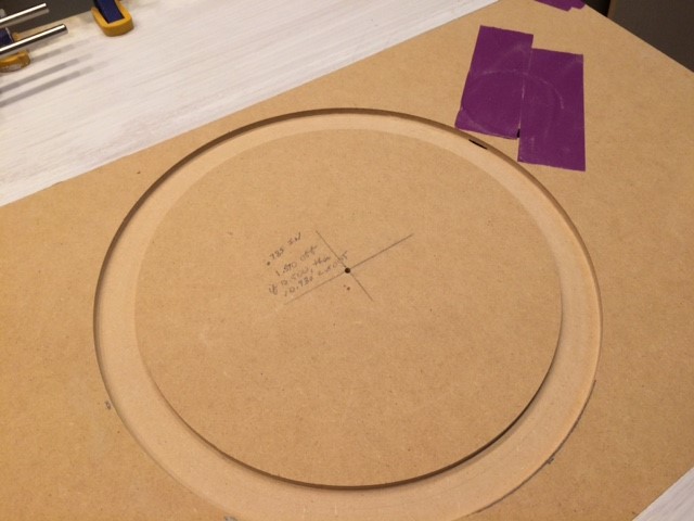

hello,
I have been following the thread for the last year or so and I'm finally going to make the project.
I'll have plenty of questions, but one quick one. To my eye, surface-mounting the drivers does not look attractive. Cutting a rabbet for the 830669 is trivial, but the shape of the TC9 is a challenge. I am working on a mounting method of routing the rear of the baffle 3.900" to a depth of .620 (leaving .130 of material), cutting the through hole to about 2.980" and rounding off the front of the the .130" of material.
So, the TC9 will recessed .130, but the front rounded. This will look nice, but will it hurt the dispersion? Will I introduce too much vibration in the .130x.460 section?

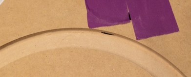

The router work is tricky:
1. Establish a through pin hole to mount the circle jig
2. Route the 3.900" diameter around the perimeter, to .620 depth but leave the middle.
3. Cut the 2.980" hole through
4. Flip and round-over the inside of the 2.980" hole. (1/8" radius seems to look nice).
5. Flip and route out the remainder of the .620 recess.
I need to cut the round-over before finishing the rear recess area because the router bit offset bearing needs material to ride on.
I probably will make my test baffles surface mount for the TC9, but will continue to work on this method on scrap material.
I also, plan to cut baffle extensions to go to the floor to test also.
I need to figure out if this design will work in my strange large mostly-open workshop/office area before I spend too much time on final woodwork.
Finally, many thanks to John and Pano for their efforts.
